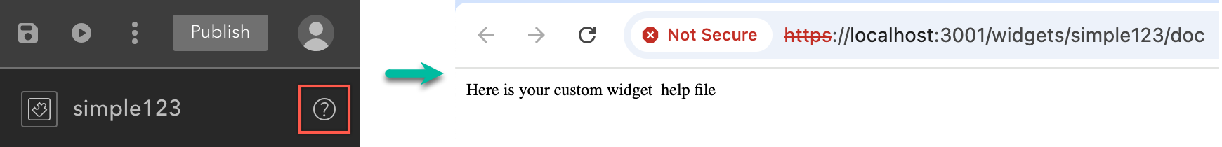

When developing a custom widget, you might want to include a help document that explains how to configure and use the widget, like the built-in widgets. You can accomplish this by creating a folder called "doc" within your custom widget directory, and then adding a file named "index.html" in that folder containing the help content, as illustrated below.
When you add a widget and click the question mark on the widget setting panel, the help link should open as demonstrated below. For additional details, refer to Add help to your widget.

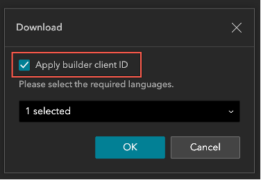

Before this update, if the application included private data from a portal, it was necessary to input the client ID in the app's config.json to activate OAuth authentication prior to deployment. With the latest release, when the data originates from the same portal as the developer edition, you now have the option to streamline the process by choosing "Apply builder client ID" during the app download. Consequently, the client ID associated with the builder will automatically be integrated into the config.json file of your downloaded application.
