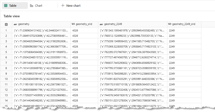

In the example below, we will transform the geometry from WGS84 (SRID 4326) to Massachusetts State Plane Coordinate System (SRID 2249). This is an example of transforming a geographic coordinate system to a projected coordinate system. The units of the Massachusetts State Plane Coordinate system are feet, so measurements of distance on this projected data will be in feet. Note that in this example below we are just transforming the geometry and displaying the result in a table.
# Transform geometry using ST_transform and check the SRID values
display(df
.select(
"geometry",
ST.srid("geometry").alias("geometry_srid"),
ST.transform("geometry", 2249).alias("geometry_2249"),
ST.srid("geometry_2249").alias("geometry_2249_srid"),
When we look at the results, it's clear that the coordinates are very different for our geometry and geometry_2249 columns. geometry is using latitude and longitude in WGS84 and geometry_2249 is using the Massachusetts State Plane Coordinate System in feet.
