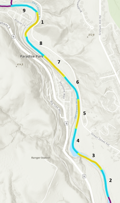

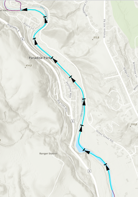

In Pro 3.4.2, I'm using the Divide tool to split a stream line into 9 equal parts. Pretty basic.
The processing preview looks fine....
But the new reaches, sorted by ObjectID, are out of order. Rather than the first reach being the downstream-most, it's second from the upstream-most.
When I use the Split tool in ArcMap, it does this correctly (same data layer, same stream line). Any ideas why Pro would do this? Sounds like a bug to me....
Any thoughts would be greatly appreciated. Thanks!
