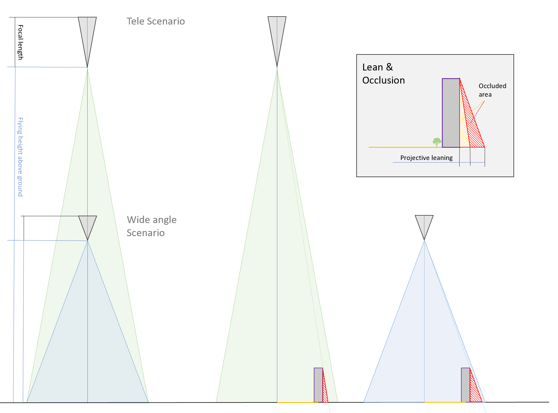

Ortho Productions are most effective when the input imagery offers a near-orthographic view of each ground point. This can be attained through the use of long focal lengths (such as in efficient high-altitude content programs) which typically minimize building lean effects. Alternatively, highly overlapping stereo imagery can also achieve this effect by leveraging the most center parts of each image.
The schematic below illustrates two distinct camera setups: green represents a telephoto lens, while blue signifies a wide-angle lens. A shorter focal length (wide-angle) may introduce more occlusions and leaning compared to a telephoto setup.

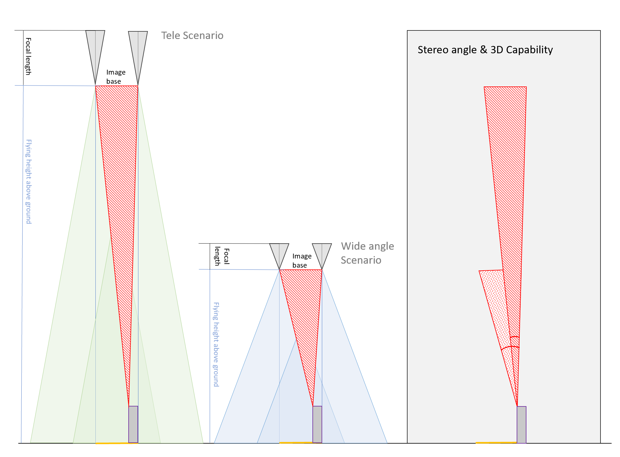

3D Production
3D Production uses the principles of stereo Photogrammetry. Therefore, each pixel requires multiple views forming stereo models with a baseline. An intersection angle (baseline) is required to achieve depth information at high quality. Image similarity is at the same time needed to perform image matching. The following schematic drawing shows the same camera setup as above. On the one hand, a longer focal length (tele) enables to fly at higher altitude to achieve the same GSD, which makes the base-to-height-ratio less favorable (smaller intersection angle) and introduces a larger depth error. On the other hand, image similarity is better represented by tele setups and less optimal for wide-angle setups.
Taking into account both image similarity and intersection angle, as depicted in the schematic drawing above, a setup that strikes a balance between telephoto and wide-angle configurations is deemed most optimal for 3D Productions. This balanced setup is crucial for achieving high-quality results in stereo Photogrammetry.
