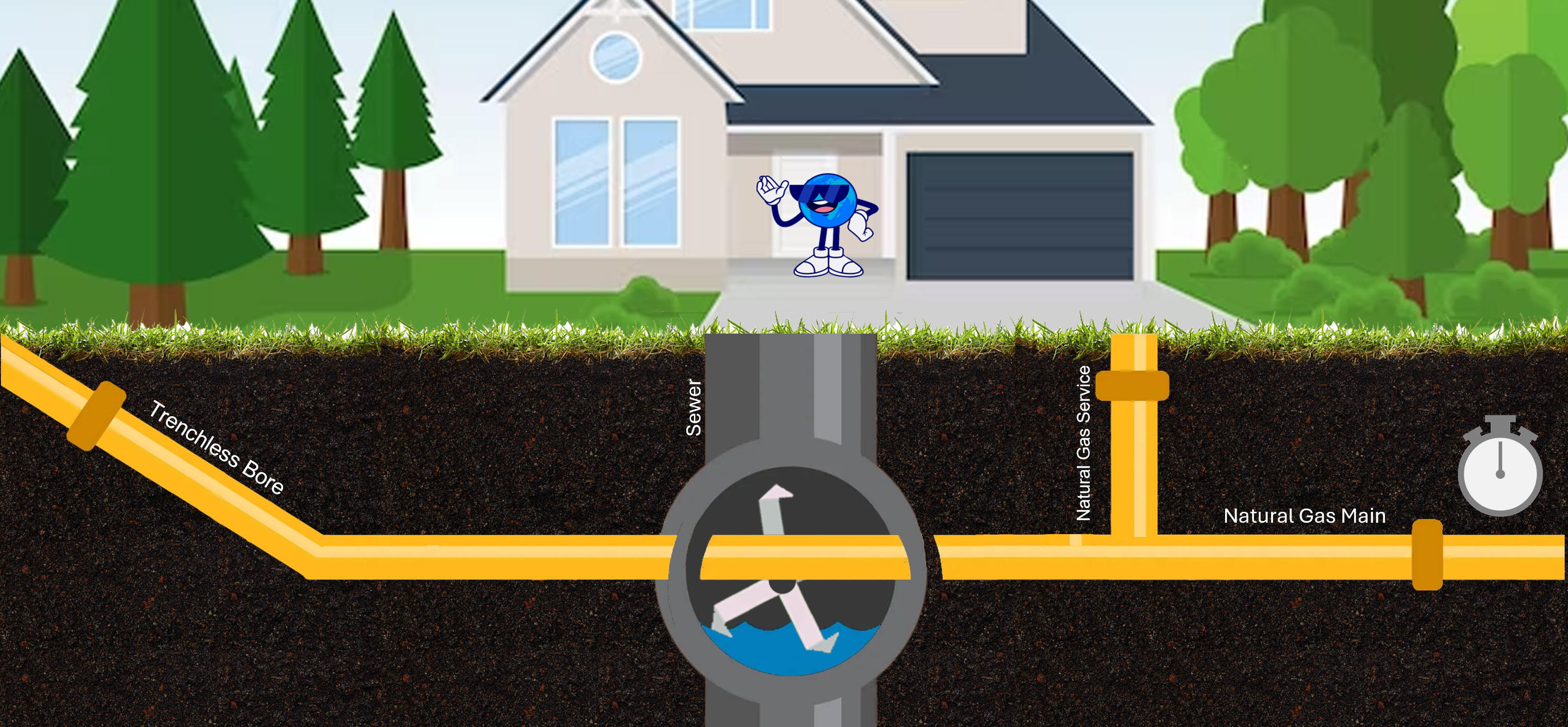

With industry associations advocating for standards and guidelines, coupled with the growing adoption of trenchless technology, it’s become crucial for gas utilities to implement a comprehensive cross bore program. A cross bore occurs when a new utility line, commonly a gas line, is accidentally installed through an existing utility like a sewer line using trenchless technology during installation. Unfortunately, this can go unnoticed for months or even years. The real trouble starts when there's a blockage in the sewer. If a plumber comes in to clear it with an auger, they might unknowingly cut through the gas line. This can create a serious safety risk, as the leaking gas could seep into the home, putting everyone inside in danger. It’s a hidden threat that can lead to disaster, making it crucial for both utility companies and homeowners to be aware of the risks associated with cross bores.

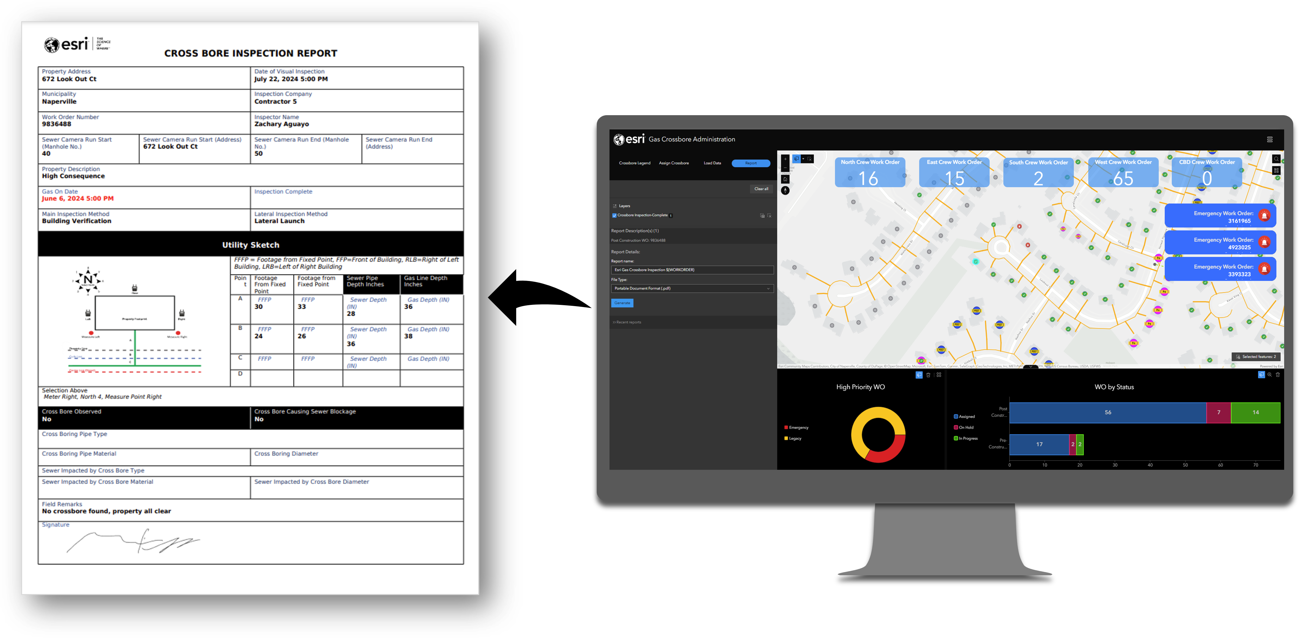

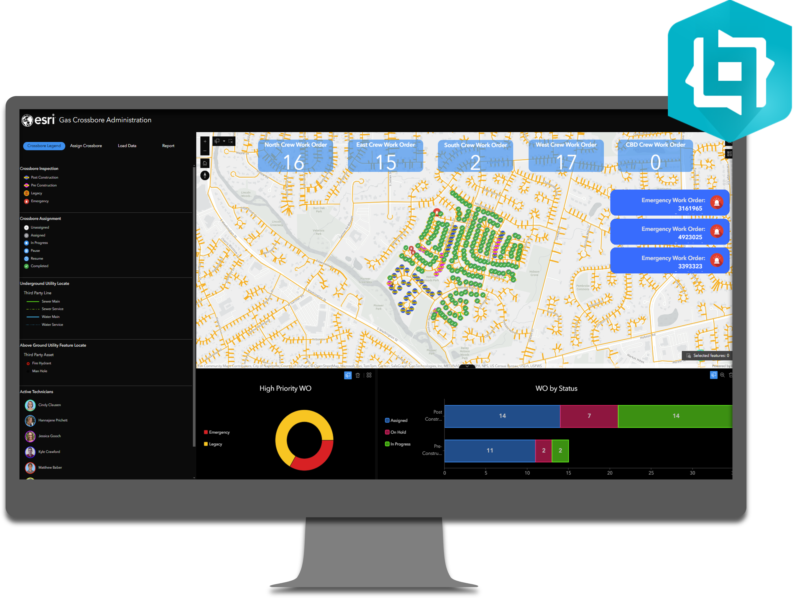

In Utilities, where safety is paramount, effectively managing and tracking the lifecycle of inspections for a cross-bore program is crucial. We start in the office with a dashboard that gives us a clear overview of several important aspects. We can see current work assignments, crew availability, and emergency inspections that need to be completed.
This dashboard acts as our command center, helping us allocate resources efficiently and prioritize tasks easily. Not only does this dashboard give us key information but allows us to perform key actions. Reporting is an important part of this workflow. You’re in the office and need to export a report on a post-construction inspection that was completed. You no longer need to look through the stack of papers filed away. Just click on the inspection and generate the report. Esri’s feature report widget makes it easy to select the inspection and export a formatted, populated report.
The data source for the generated report is a feature layer associated with an ArcGIS Survey 123 survey. The report template is created in Microsoft Word with Arcade syntax and the associated survey field names embedded into the form template.

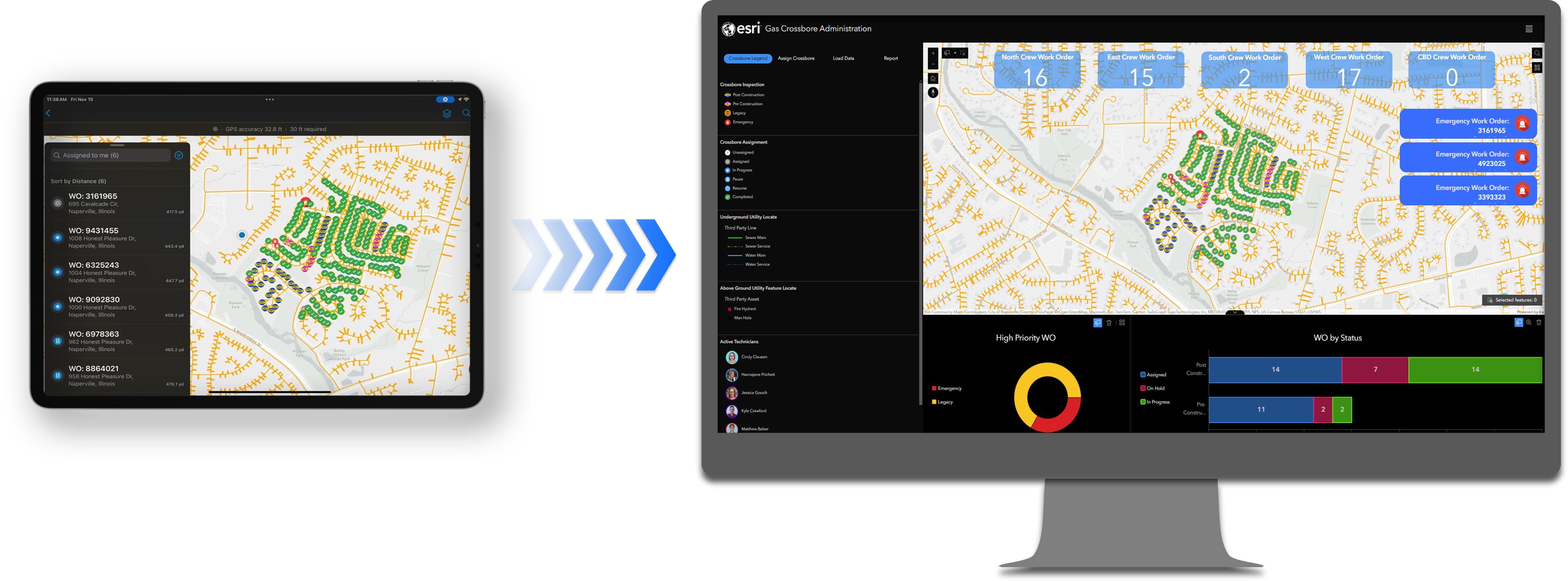

Since this web application references data in a services-based architecture, updates from the field are immediately reflected in the office, offering a near-real-time view of ongoing work in the field and the statuses of the cross-bore inspections.

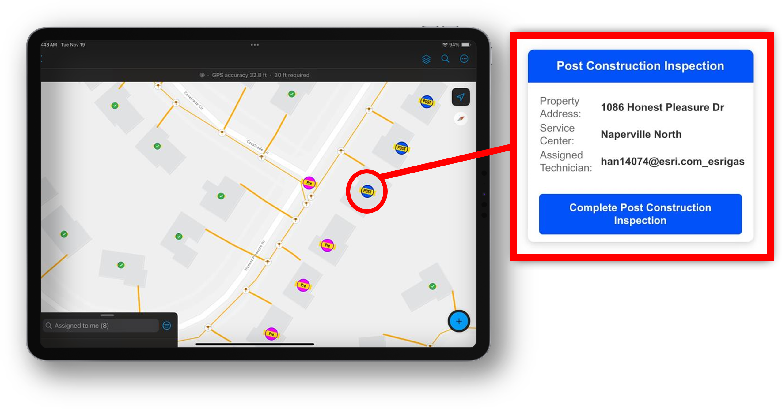

Common to cross-bore programs is to have pre-construction inspections and post-construction inspections. These two inspections require different actions. With pop-up configurations using arcade, we can easily differentiate the two inspections, helping the field crews get their work done easily.

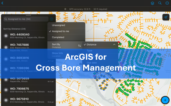

As our field workers are completing their inspections, with location tracking enabled, the office can view their real-time locations. This visibility helps the office stay connected and informed about what’s going on in the field. Additionally, while working in the field, workers can easily filter their task list to focus on inspections that require their attention first – ensuring that high-priority and emergency inspections are prioritized.
For post-construction inspections the field worker clicks on the “Complete Post Construction Inspection” button in the pop-up and is automatically taken to the post construction inspection form in Survey123.
Information from the field can be easily passed to our form through URL parameters. This is a unique URL that allows ArcGIS Field Maps and ArcGIS Survey123 to essentially talk to each other. This allows for a seamless field worker experience since fields in the form can be pre-populated. Our form also includes conditional visibility and picklists which minimize human error and saves time when filling out forms in the field. Once the form is submitted, the office can view the completed form.

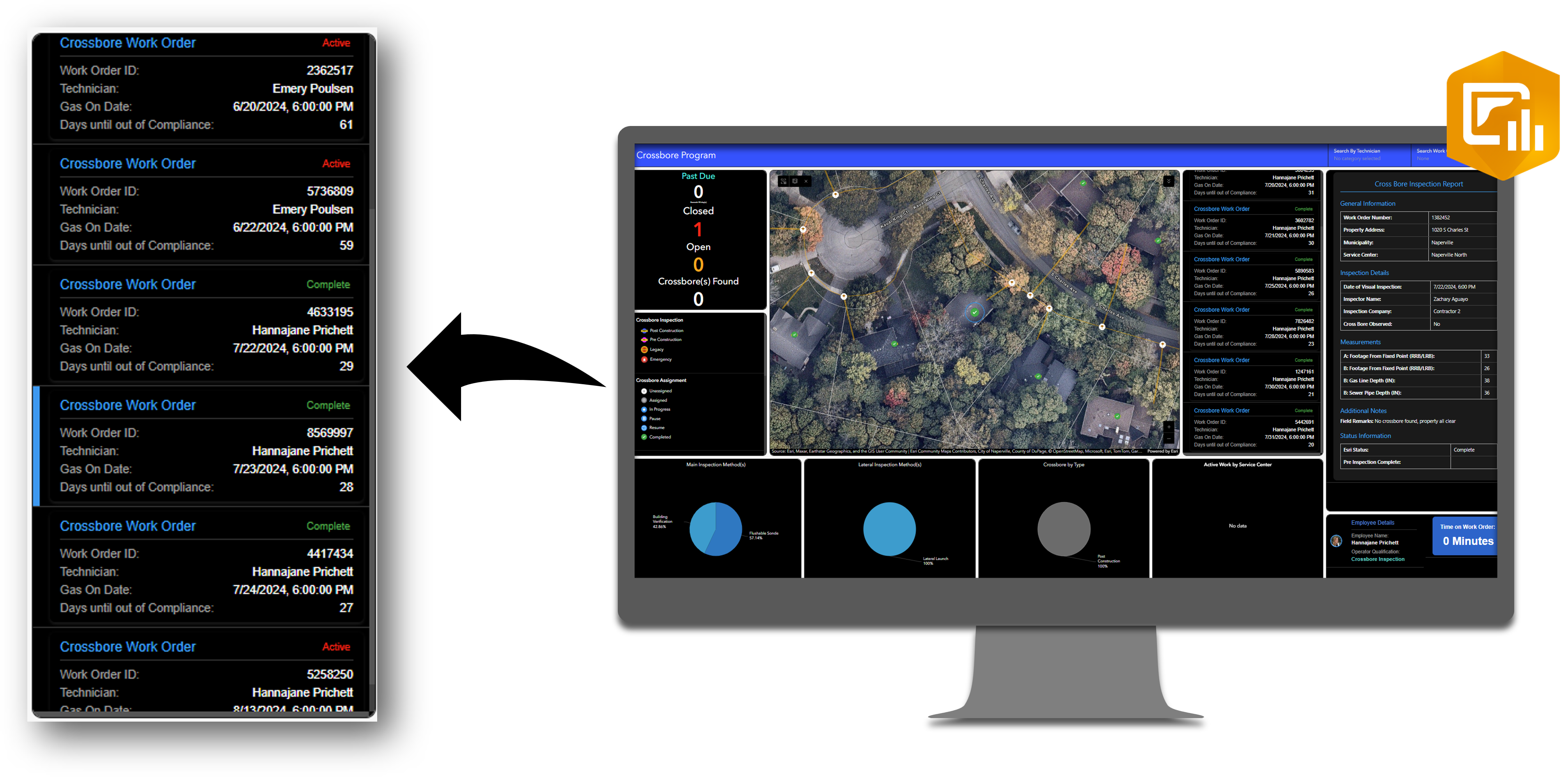

All the inspection information that was collected in the field is now readily available back in the office. This dashboard allows the office to see the work that was done in the field in more detail. We can view details like work order number, the field worker who completed the inspection, the gas on date, and days until out of compliance.
Even though there are no PHMSA regulations or requirements for cross bore management, industry associations are pushing best practices. It's well-known among utility companies that it typically takes about 90 days for a sewer to back up following the installation of a utility line, after which customers usually contact a plumber. This workflow uses a 90-day compliance window set by industry standards. Once that window for an inspection is missed it becomes past due. This helps the office ensure that inspections are made on time, and within that 90-day window.
