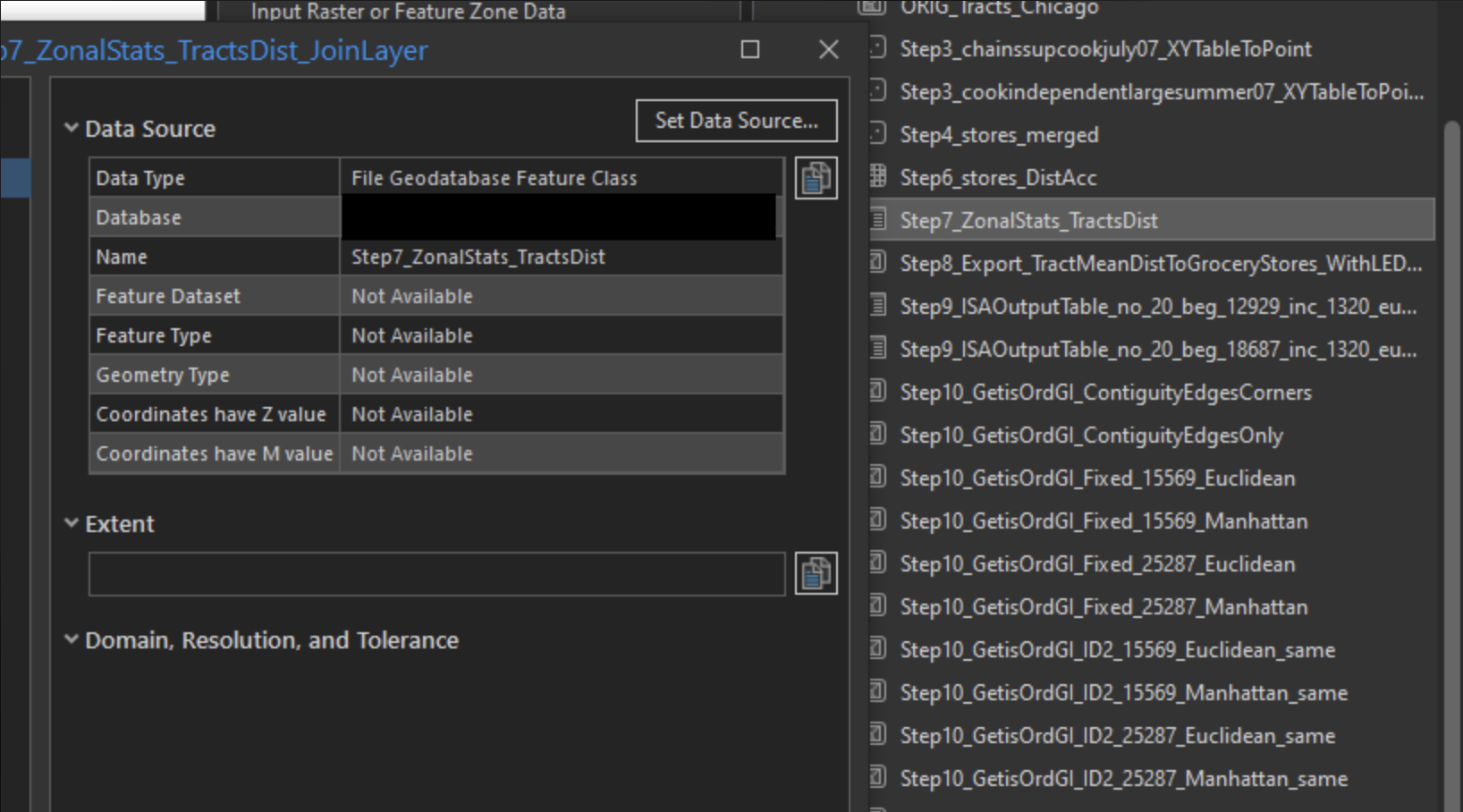

Right now if you complete the optional 'Output Join Layer' parameter, you don't get a real output. You get a mysterious layer type in your map that has no spatial reference and points to the output table as its source--not a feature class. Further, Error 000210 is generated when doing data > export features. This would be really useful if it did create a feature class, though. It would save the manual joining steps.
