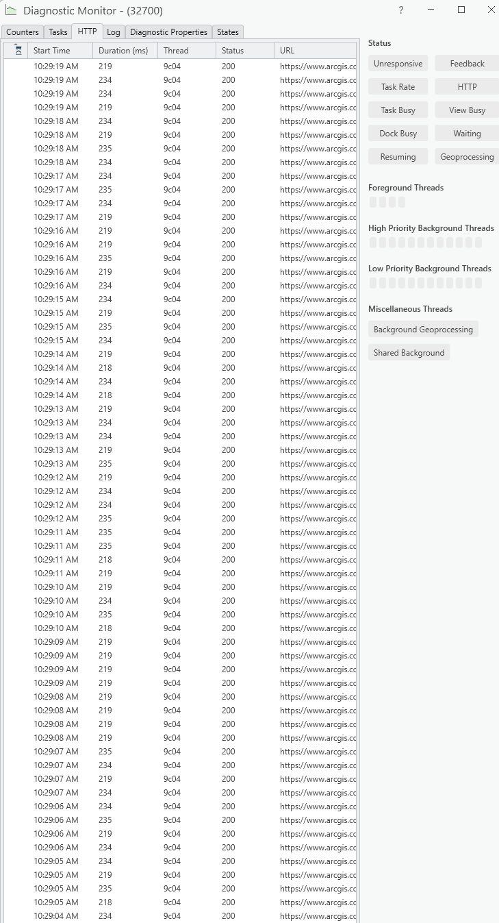

When you open the Diagnostic Monitor you will see that for almost everything you do, Pro will do multiple successive license checks.
Paste a value into an attribute table of a locally saved FC in a local FGDB: 4 checks
Rename a map: 76 checks

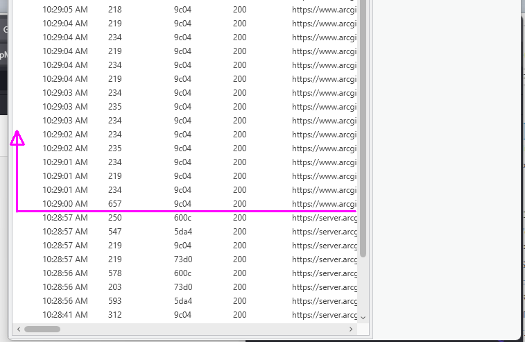

Rename a map:
+ (had to scroll to copy them all)
That is 19 seconds of unresponsive UI.
