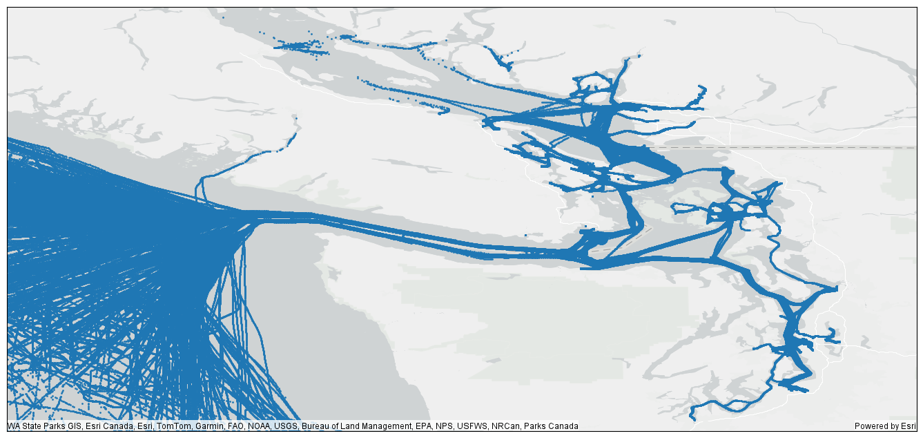

Creating tracks
In GeoAnalytics Engine, a track is a linestring that represents the change in an entity's location over time. Each linestring vertex has an m-value representing the timestamp. Linestring vertices are ordered sequentially (by increasing value) using the timestamp column. Tracks are created using a point type geometry column and a timestamp column. A visual example of a track is shown in the image below.
The TRK_Aggr_CreateTrack function creates a track for each vessel after the AIS data has been grouped by the Maritime Mobile Service Identity (MMSI) column, which is a unique identifier for each vessel.
# Create tracks from the AIS ship points
tracks = ais_points.groupBy("MMSI").agg(TRK.aggr_create_track("geometry", "timestamp").alias("track"))

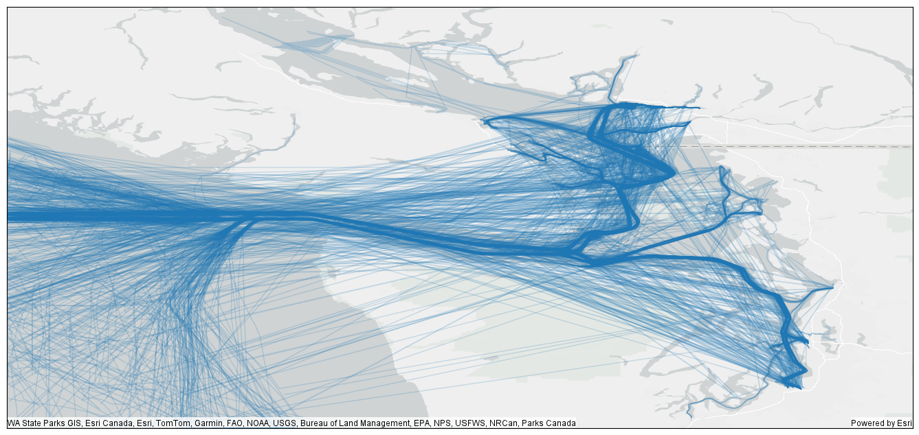

# Plot the tracks
tracks.st.plot(**ais_plot_style, linewidth=1, alpha=0.2);

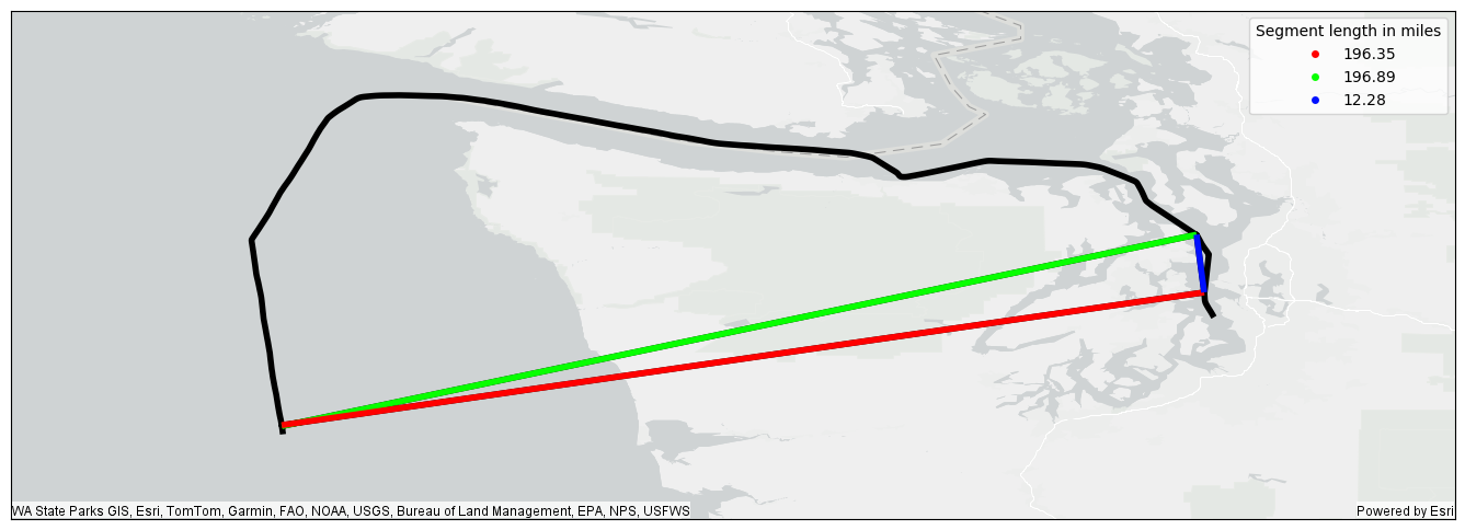

When visualizing the vessel tracks that were created, there are subsets of tracks that cross over the land.

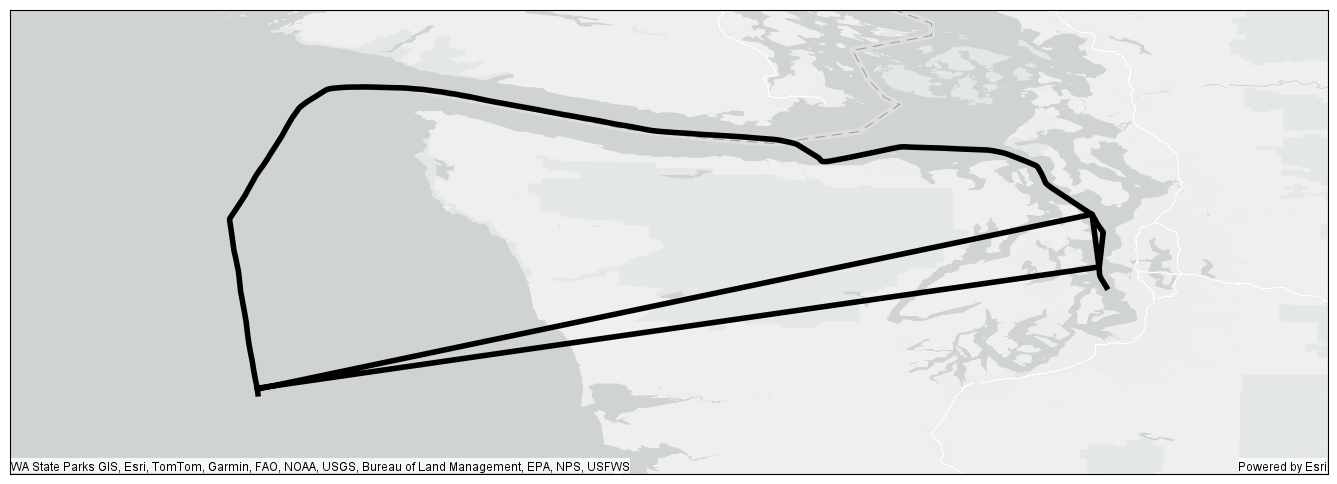

To visualize what is causing the tracks to cross over the land, we can explore a single track created using a subset of data for a vessel that contains inaccurate observations.
# Create a track covering the path of a single vessel for a day that contains inaccurate data
inaccurate_track = ais_points.where("mmsi==355745000 and timestamp>'2023-01-08 00:00:00'") \
.groupBy("mmsi").agg(TRK.aggr_create_track("geometry", "timestamp").alias("track"))
# Plot the inaccurate track
inaccurate_track.st.plot(figsize=(17,12), basemap="light", xmargin=0.25, ymargin=0.25, linewidth=4, color="k");
The visualization shows the vessel track beginning in Puget Sound and then heading out to the Pacific Ocean. Towards the end of the track, two observations are reported that show the vessel back in Puget Sound even though it’s still in the Pacific Ocean. The inaccurate observations cause the track to cross over the land.
These inaccurate observations can be explored further using two GeoAnalytics Engine functions. First, the ST_Segments function splits the track up into segments that contain only two points (vertices). The TRK_Length function is then used to calculate the length of each segment in miles.
# Create segments from the inaccurate track
inaccurate_track_segments = inaccurate_track.withColumn("segments", ST.segments("track", num_points=2, step_size=1))
# Calculate the length of each segment
inaccurate_track_segments = inaccurate_track_segments.select("MMSI", F.explode("segments").alias("segments")) \
.withColumn("segment_length", F.round(TRK.length(track="segments", output_units="miles"), 2)) \
.sort("segment_length", ascending=False)
inaccurate_track_plot = inaccurate_track.st.plot(figsize=(17,12), basemap="light", xmargin=0.25, ymargin=0.25, linewidth=4, color="k");
# Plot the 3 longest segments of the inaccurate track
inaccurate_track_segments.where("segment_length >= 12") \
.st.plot(ax=inaccurate_track_plot, cmap="hsv", cmap_values="segment_length",
is_categorical=True, xmargin=0.25, ymargin=1, linewidth=4,
legend=True, legend_kwds={"title": "Segment length in miles"});
When the three longest segments of the track are visualized, the distance in miles between the inaccurate observations are further apart than the vessel could have reasonably traveled in the time between observations.

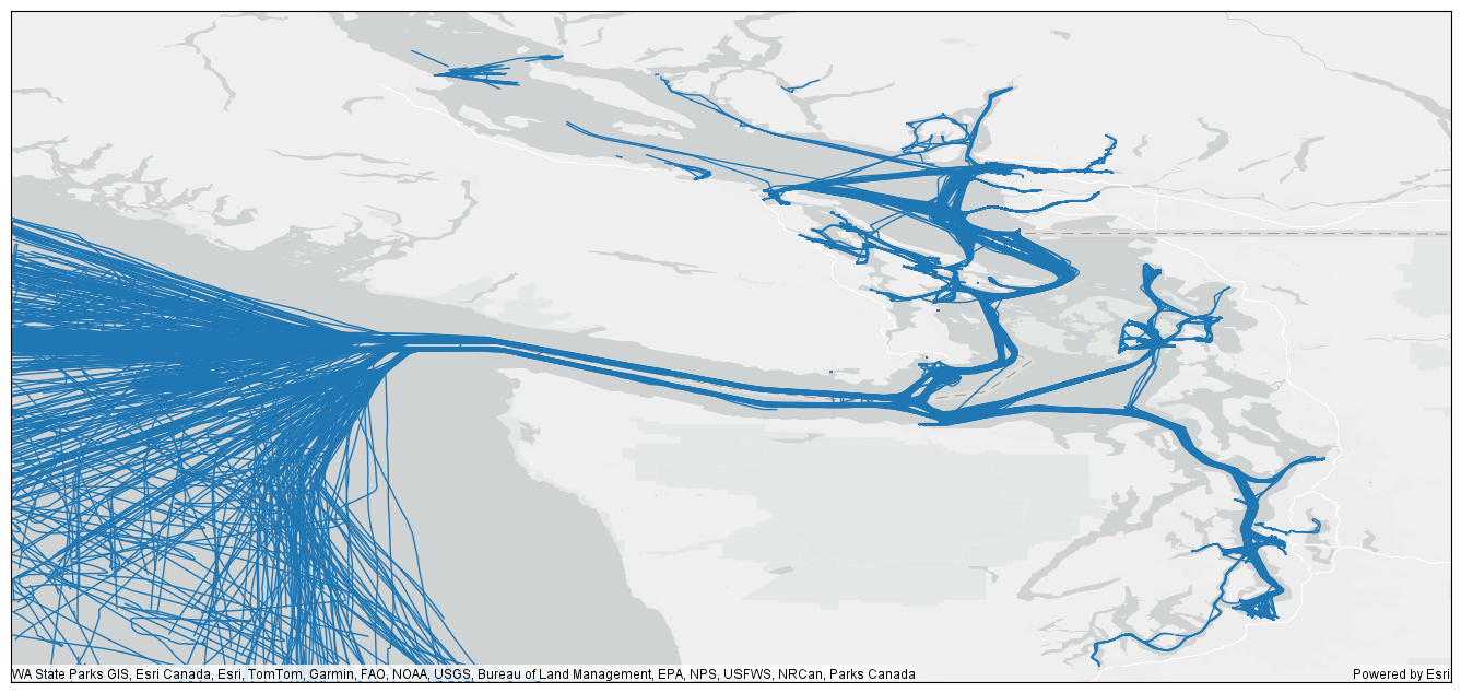

With the information from exploring the single vessel track with inaccurate observations, we saw that the inaccurate points were more than 12 miles apart. Based on this we will select a slightly lower distance value of greater than 5 miles between consecutive observations to determine if an observation is inaccurate. The distance value used will depend on the data and the frequency between consecutive observations for the entire dataset. The TRK_SplitByDistanceGap function is used to split the vessel tracks anytime two vertices are more than 5 miles apart.
# Split the tracks based on a distance gap
split_tracks = tracks.withColumn("split_by_distance_gap", TRK.split_by_distance_gap("track", (5, "miles")))
split_tracks = split_tracks.select("MMSI", F.explode("split_by_distance_gap").alias("tracks")) \
.persist()
# Plot the split tracks
split_tracks.st.plot(**ais_plot_style, linewidth=1);
Visualizing the vessel tracks after the inaccurate observations have been cleaned up shows that the tracks no longer cross over the land. Not only is this useful for cleaning up the tracks from vessels, but it’s relevant to any tracks created from moving objects that have inaccurate distance gaps between observations. In the case of inaccurate time gaps between observations, the TRK_SplitByTimeGap function is used to split tracks anytime two vertices are farther apart than the specified gap duration.

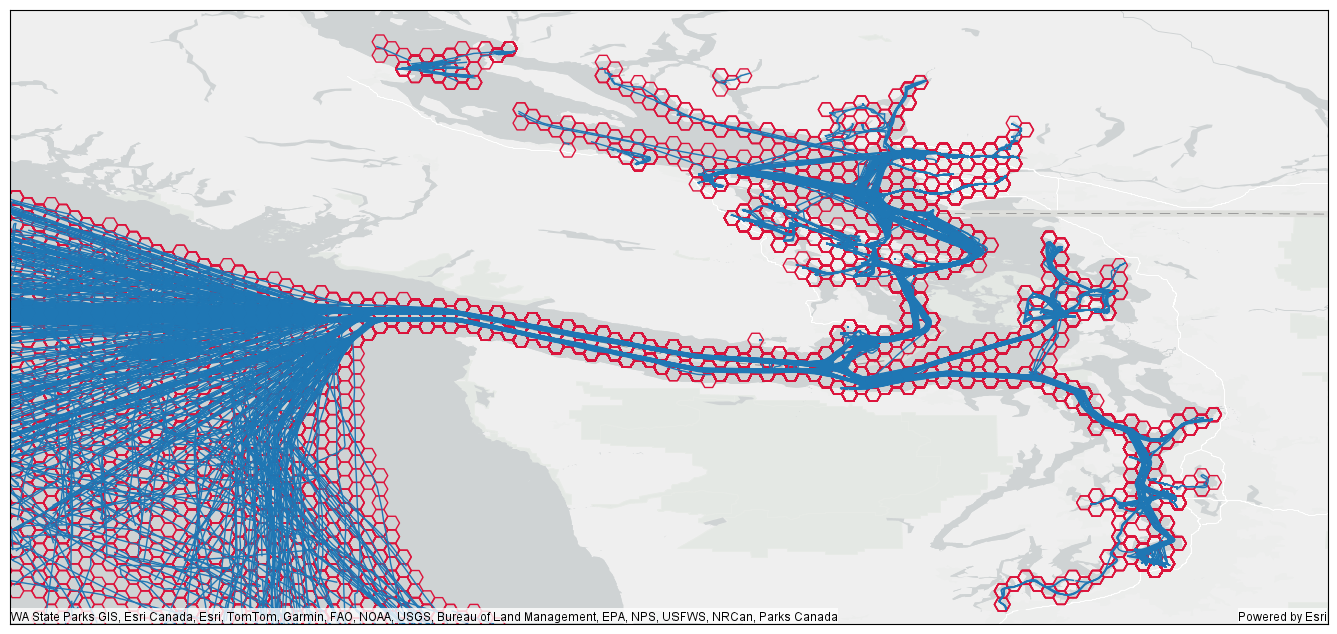

# Split the tracks using hex bins
track_segments = split_tracks.withColumn("bin", F.explode(ST.hex_bins("tracks", bin_size=5000))) \
.withColumn("intersection", ST.intersection("tracks", ST.bin_geometry("bin"))) \
.withColumn("track_segments", F.explode(ST.geometries("intersection"))) \
.drop("tracks", "intersection") \
.persist()
# Plot the split tracks and the bins
split_tracks_plot = track_segments.st.plot(**ais_plot_style, linewidth=1)
track_segments.select(ST.bin_geometry("bin")).st.plot(ax=split_tracks_plot, edgecolor="crimson", facecolor="none");

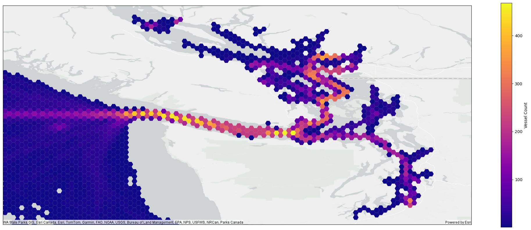

One method of determining vessel density is to count the number of tracks within each bin. Visualizing the count of vessel tracks shows the areas with the highest vessel traffic.
# Calculate the total vessel count for each bin
vessel_count = track_segments.groupBy("bin").count() \
.withColumn("bin_geometry", ST.bin_geometry("bin"))
# Define a plot style for the binned AIS data
ais_plot_style_bins = dict(figsize=(26,10), basemap="light", sr=54034, extent=analysis_extent, max_geoms=2_500_000)
# Plot the total vessel count for each bin
vessel_count.st.plot(**ais_plot_style_bins, cmap="plasma", cmap_values="count", legend=True,
legend_kwds={"label": "Vessel Count"});

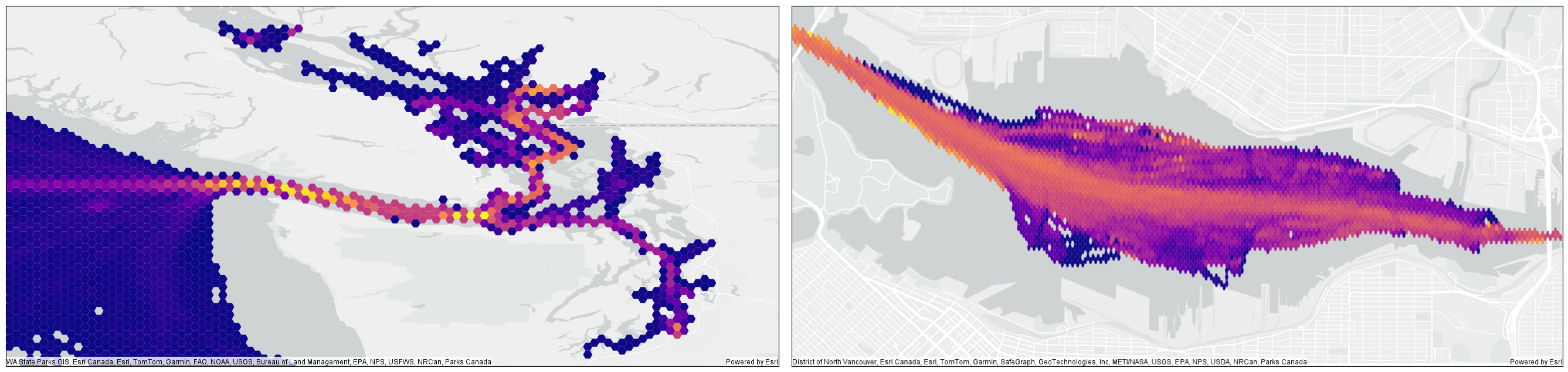

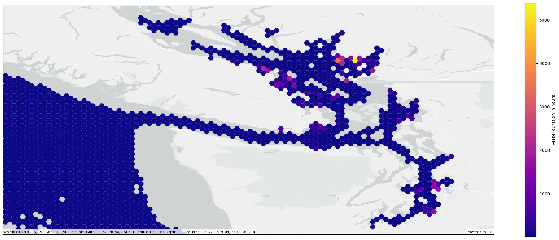

Another way of determining vessel density is to calculate the time spent by all vessels in each bin. The TRK_Duration function is used to calculate the duration of each track segment. When visualized, the total time spent by the vessels in each bin shows a much different pattern than the count of vessels per bin. From the visualization, it appears that vessels are spending most of their time in locations such as the Vancouver Harbor as indicated by the single yellow bin. This could be due to vessels needing to anchor and wait for an open spot at the dock before unloading their cargo.
# Calculate the duration of each track segment
track_segments_duration = track_segments.withColumn("track_duration", TRK.duration("track_segments", output_units="hours"))
# Calculate the total duration for all vessels in each bin
vessel_duration = track_segments_duration.groupBy("bin").sum("track_duration") \
.withColumnRenamed("sum(track_duration)", "total_duration") \
# Plot the total vessel duration
vessel_duration.st.plot(**ais_plot_style_bins, cmap="plasma", cmap_values="total_duration", legend=True,
legend_kwds={"label": "Vessel duration in hours"});

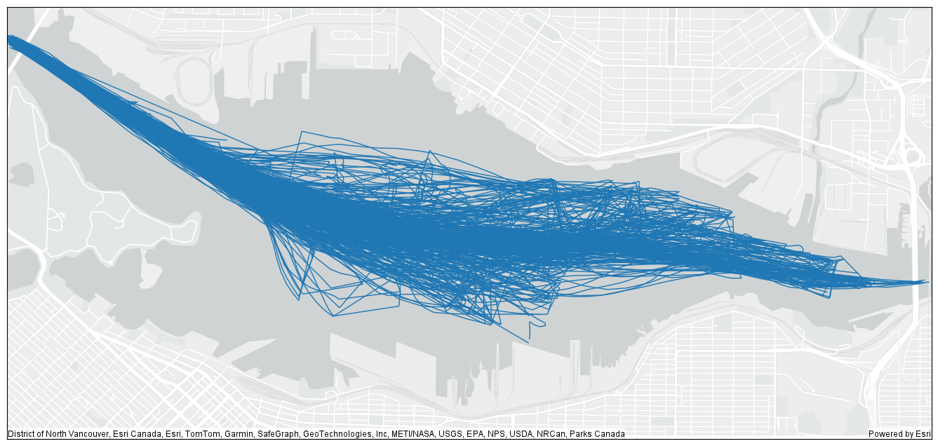

# Extent for the Vancouver Harbor
vancouver_harbor_extent = (-13707985.924030624, 4814096.888325807, -13694991.629222166, 4816838.044237577)
# Select the AIS data within the Vancouver Harbor
ais_points_vh = ais_points.where(ST.bbox_intersects("geometry", *vancouver_harbor_extent)) \
.persist()
# Define a plot style for the Vancouver Harbor data
vh_plot_style = dict(figsize=(17,8), basemap="light", sr=54034, aspect='auto', extent=vancouver_harbor_extent)
# Plot the data
ais_points_vh.st.plot(**vh_plot_style, s=1);

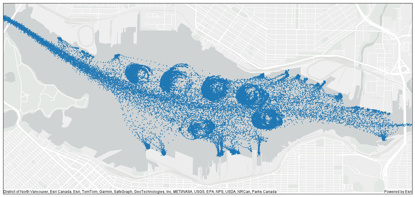

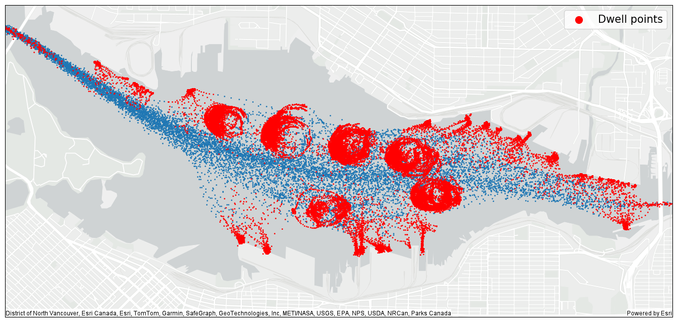

The visualization of the Vancouver Harbor AIS data shows swirls of points, which appear to be areas where ships anchor. The GeoAnalytics Engine Find Dwell Locations tool is used to detect dwell points. A distance of 500 meters and 2 hours is used to represent vessels being relatively stationary for a minimum amount of time.
# Import the Find Dwell Locations tool
from geoanalytics.tools import FindDwellLocations
# Run the Find Dwell Locations tool
find_dwells_vh = FindDwellLocations() \
.setTrackFields("mmsi") \
.setDwellMaxDistance(500, "meters") \
.setDwellMinDuration(2, "hours") \
.setOutputType("AllPoints") \
.run(ais_points_vh) \
.persist()
# Plot the dwell points in red
dwells_vh_plot = find_dwells_vh.where("DwellID is not NULL").st.plot(**vh_plot_style, s=1, c="r", zorder=2, label="Dwell points")
find_dwells_vh.where("DwellID is NULL").st.plot(**vh_plot_style, ax=dwells_vh_plot, s=1, zorder=1).legend(fontsize=15, markerscale=10);
Having identified the dwell locations, those points are removed, tracks are created for each vessel, and then cleaned up using the same 5-mile distance gap between observations that was used previously. This results in tracks that were created without the dwell locations, which can now be used to calculate vessel speeds.

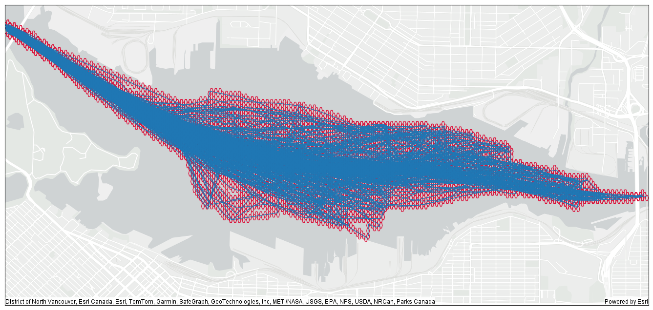

Using a reasonably small bin size for the area, in this case 50-meter hexagon bins, the tracks are then split into segments. Now that we have the tracks split into segments inside each bin, we can then summarize the speed of the vessels within each bin.
non_dwell_track_segments_vh = non_dwell_split_tracks_vh.withColumn("bin", F.explode(ST.hex_bins("tracks", bin_size=50, padding=50))) \
non_dwell_split_tracks_plot = non_dwell_track_segments_vh.st.plot(**vh_plot_style, linewidth=1)
non_dwell_track_segments_vh.select(ST.bin_geometry("bin")).st.plot(**vh_plot_style, ax=non_dwell_split_tracks_plot, edgecolor="crimson", facecolor="none");

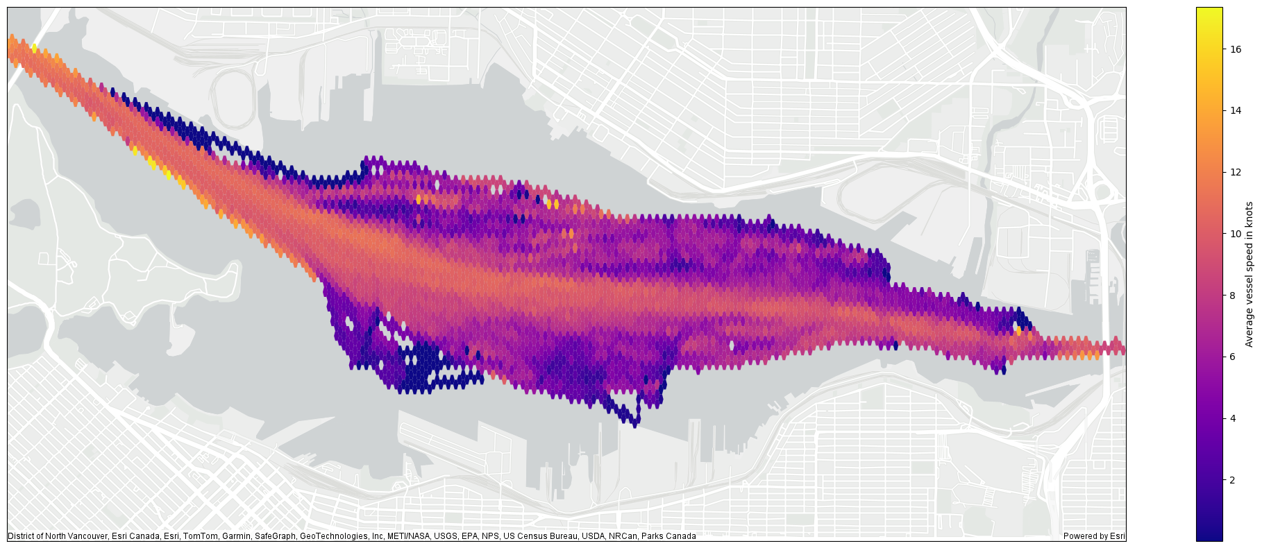

The GeoAnalytics Engine TRK_Speed function is used to calculate the speed for each track segment. Summary statistics can then be calculated to get an idea of the vessels’ speeds in the Vancouver Harbor.

The average speed of the track segments within each bin can be calculated to visualize how the average vessels’ speeds change within the Vancouver Harbor.
# Calculate the average speed for all vessels in each bin
vessel_speed = track_segments_speed.groupBy("bin").mean("track_speed") \
.withColumnRenamed("avg(track_speed)", "average_speed") \
.withColumn("bin_geometry", ST.bin_geometry("bin")) \
.persist()
# Define a plot style for the Vancouver Harbor vessel speed data
vh_plot_style_bins = dict(figsize=(26,10), basemap="light", sr=54034, aspect='auto', extent=vancouver_harbor_extent)
# Plot the average vessel speed for each bin
vessel_speed.st.plot(**vh_plot_style_bins, cmap="plasma", cmap_values="average_speed", legend=True,
legend_kwds={"label": "Average vessel speed in knots"});
The visualization of the vessel speeds within the Vancouver Harbor shows vessels moving the quickest when traversing the center of the harbor. Vessels speeds tend to decrease as the vessels approach the edge of the harbor where they tend to anchor.
