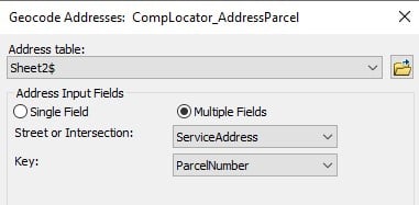

In ArcMap composite locators, you can specify multiple primary fields and determine which locators use which of those fields. So using the data sample above, we'd have the address point locator use the ServiceAddress field to geocode and the parcel locator use the ParcelNumber field.
