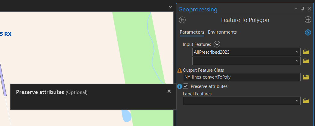

This is a small thing, but hopefully would be very simple to implement. I was working with the Feature To Polygon tool today and noticed the attributes weren't transferring even though I had the box checked. After some research I did find this Esri Support page which addresses the issue.
https://support.esri.com/en-us/knowledge-base/problem-creating-polygons-from-a-polyline-feature-layer-000030478
However, it would be helpful if the tooltip for the checkbox would display the message from the "Cause" section of this page:
"The Preserve attributes parameter is no longer supported and does not work when using the Feature to Polygon tool. It remains for backward compatibility of scripts and models."
While I wish I understood *why* this feature was removed, it would at least be nice to be notified that it won't work when running the tool, rather than having to research and find the support article.
