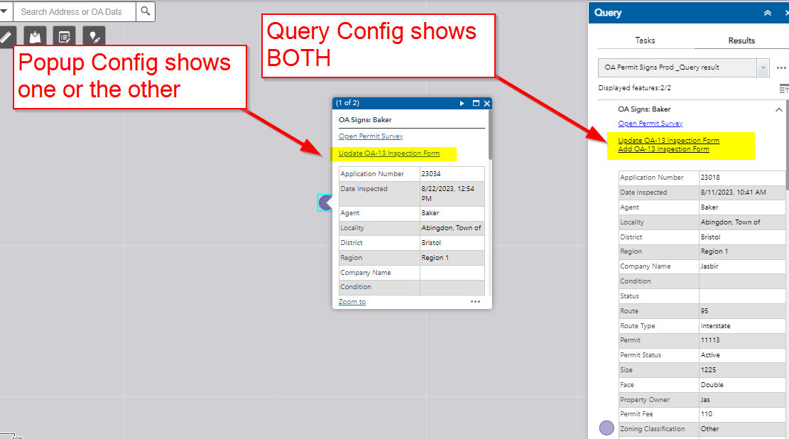

This works GREAT and can be clearly seen in the Popup below... where only one of them is shown at a time...In this case there is a related record for this Feature and as such it says Update for the second link "Update OA-13 Inspection Form"
If there was NOT a related record it would say "Add OA-13 Inspection Record"
So everything is working Fantastic up to this point... But I then create a Web application and then add the Query Widget.

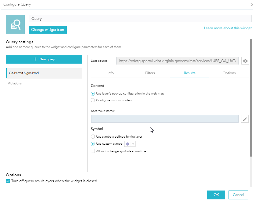

I configure the Query widget to " Use layer's pop-up configuration in the web map"
Is does this to a certain degree BUT the Expression is not read properly and ALWAYS displays BOTH of the links created via expressions..(See 2nd image below)
No matter what I do I cannot get the QUERY WIDGET to respect the Expressions in the WebMap Custom Config as specified int he Query Widget Config Settings.
