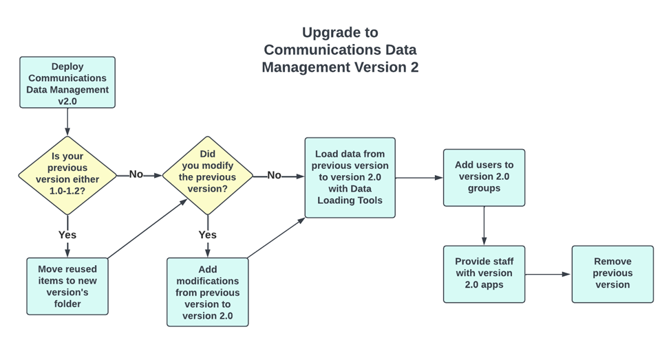

Upgrade Process
We suggest this process to upgrade an existing Communications Data Management implementation to Version 2.0.
- Deploy version 2.0 of Communications Data Management to your ArcGIS organization
- Determine whether your existing deployment is in an out of the box state or has been modified post deployment
- If necessary, add your modifications from your previous deployment to version 2.0
- Load data from previous version to version 2.0
- Add users to appropriate new groups
- Provide new apps to staff
- Remove previous version
Step 1 Deploy Version 2.0
If you have not deployed version 2 of CDM yet, do this through the ArcGIS Solutions app in your ArcGIS organization (the ArcGIS Online account or ArcGIS Enterprise Portal you are currently logged into). The ArcGIS Solutions app will automatically deploy the current version of the solution if you are deploying to ArcGIS Online or ArcGIS Enterprise 11.1 and beyond.
When you deploy, make sure to set the spatial reference the same as the spatial reference from your currently deployed solution.
The ArcGIS Solutions app will NOT write over an existing deployed solution with a new version of the solution. This is important to avoid the potential for loss of data or loss of modifications to maps and apps.
During deployment, the ArcGIS Solutions app will create a new folder in your ArcGIS organization and deploy the items (services, maps, views, app configurations) for the solution. If you currently have version 1.0 -1.2 deployed in your organization; the following items from a 1.0-1.2 deployment will be used for your version 2.0 deployment. The ArcGIS Solution app can use previously deployed items to power a new version of a solution if the items did not change between versions.
- CommunicationsMapNotes– Feature Service
- CommunicationsMapNotes_editing – Feature Service (View)
- CommunicationsMapNotes_managing – Feature Service (View)
After deploying version 2.0, the items above will need to be moved from the previous version’s folder to the folder of version 2.0.
