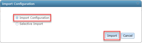

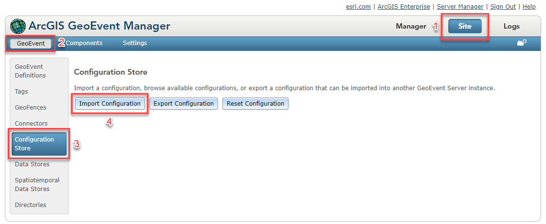

- In a web browser, navigate to ArcGIS GeoEvent Manager and go to Site > GeoEvent > Configuration Store
- Click Import Configuration and select the downloaded configuration file for import.
- Click Next and choose Import Configuration to import the entire configuration and click Import

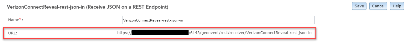

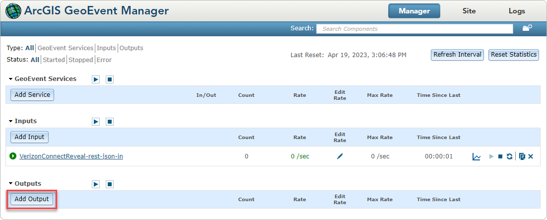

Configure a GeoEvent Server connector endpoint to receive data from Verizon Connect Reveal

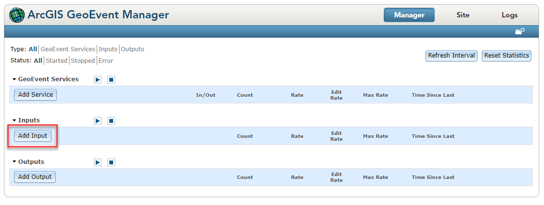

- Open a web browser and navigate to ArcGIS GeoEvent Manager (e.g., https://<hostname>:6143/geoevent/manager).

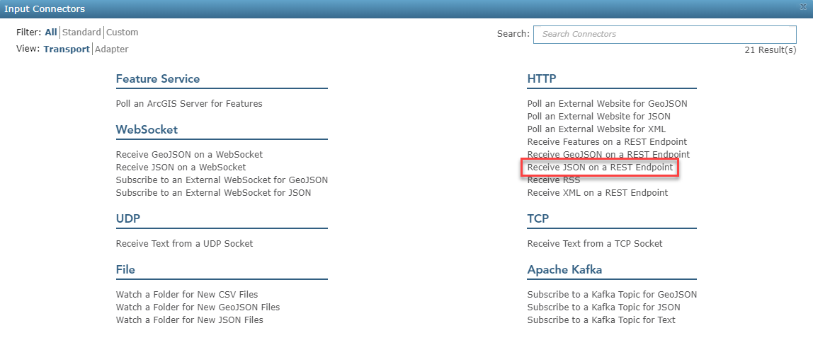

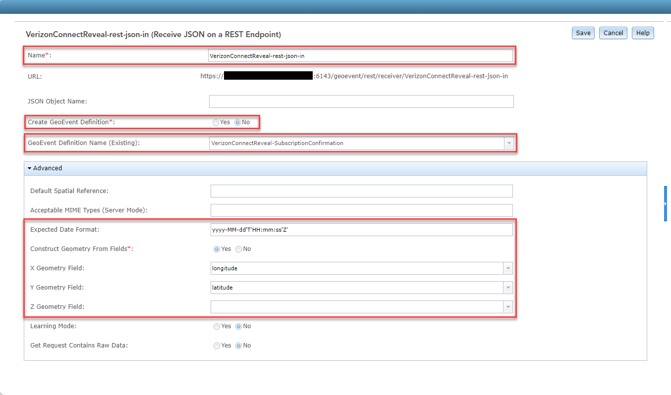

- Click Add Input and then click Receive JSON on a REST Endpoint.
- Configure the new input connector with the following parameters:
- Name — VerizonConnectReveal-rest-json-in
Note: For this guide, we will be using this name. However, you are free to use any name of your choosing.
- GeoEvent Definition Name (Existing) — VerizonConnectReveal-SubscriptionConfirmation
- Expected Date Format — yyyy-MM-dd'T'HH:mm:ss'Z'
Note: This date format is mandatory. Data will not be processed unless this date format is configured with the input connector.
- X Geometry Field — longitude
- Y Geometry Field — latitude
- Click Save to save the new input connector.

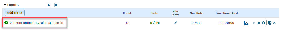

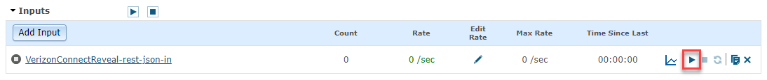

- Start the newly created input connector by clicking on the play icon.
- Click on the input connector to open the properties window.
- Copy the URL parameter and save it in a text editor. This will be used to create a URL Rewrite rule.

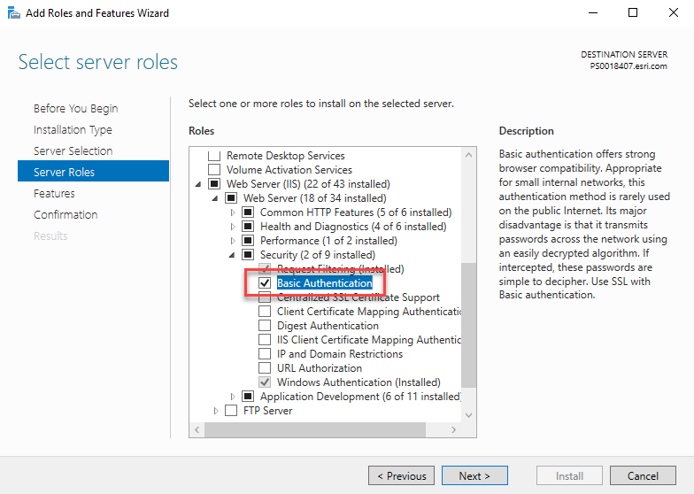

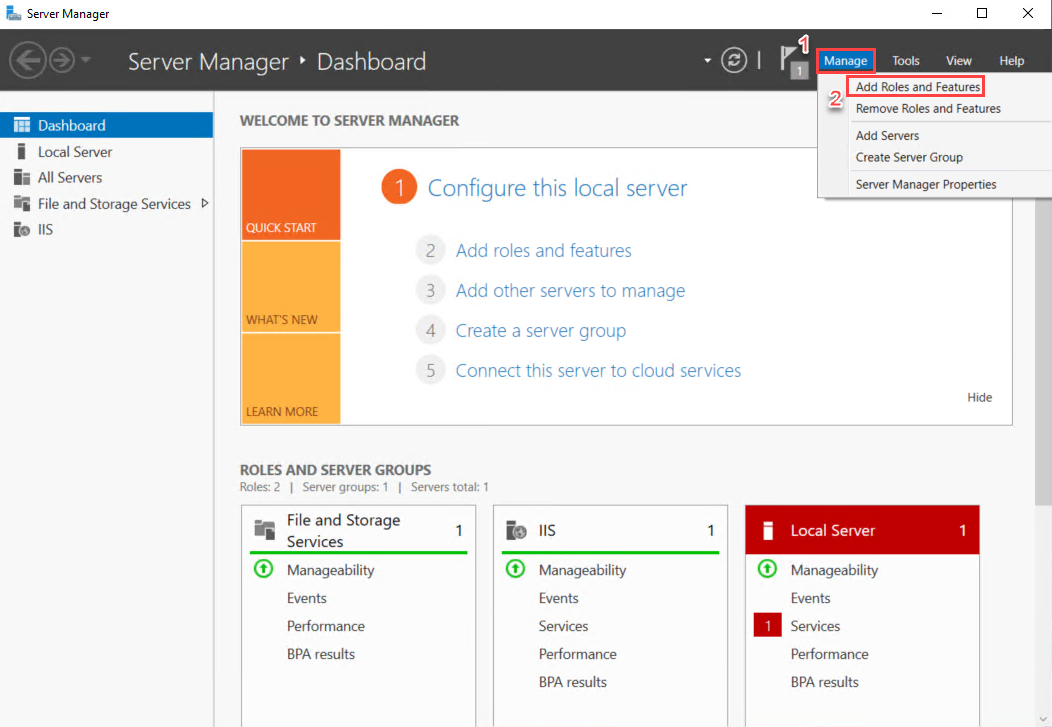

Windows Server 2019 and up
- Open Server Manager and select Manage > Add Roles and Features
- Keep selecting Next until Server Roles is selected.
- Navigate to Web Server (IIS) > Web Server > Security and check the Basic Authentication checkbox.
- Keep clicking Next until the Confirmation section is selected.
- Click Install, wait until the installation completes, then click Close.

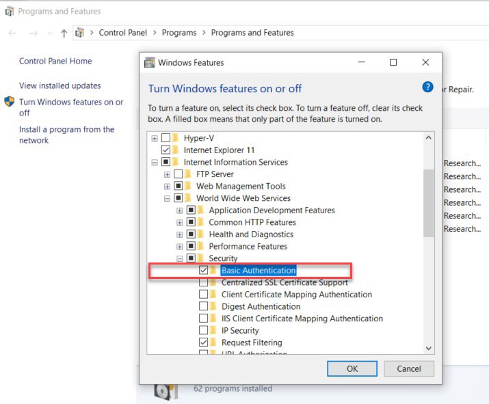

Windows 10

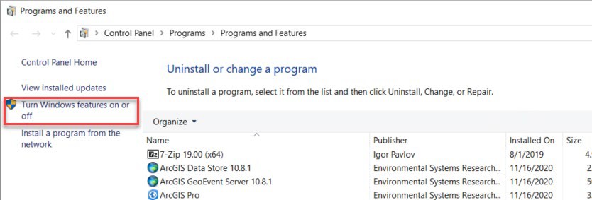

- Open the Control Panel and navigate to Programs > Programs and Features.
- Click Turn Windows features on or off.
- Navigate to Internet Information Services > World Wide Web Services > Security and check the Basic Authentication checkbox.
- Click OK to apply the change and Close once the change is applied.

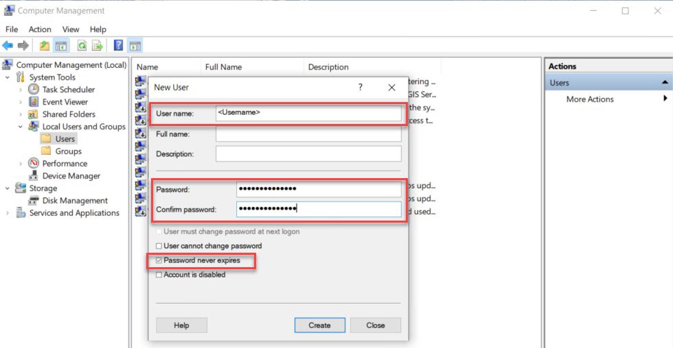

Next, you will create a local account on the machine that will provide the HTTPS endpoint for the Verizon Connect Reveal server to authenticate, connect to, and send data to.
- Open Computer Management and navigate to Local Users and Groups > Users
- Under More Actions, click New User.
- Enter your Username and Password and check Password never expires.
- Click Create to create the new user.

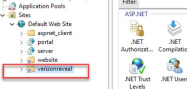

Next, we will create a virtual directory in IIS that will serve as our HTTPS endpoint.
- In File Explorer, create a new folder with the name of HTTPS endpoint for the Verizon Connect Reveal server. This may be a name of your choosing. For this guide, we will be using C:\VerizonReveal.

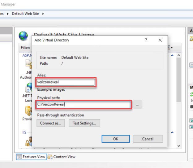

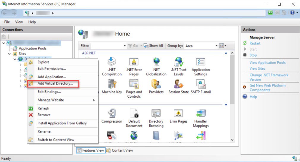

- Open Internet Information Services (IIS) Manager and navigate to Sites and right-click Default Web Site and choose Add Virtual Directory.
- Enter the Alias and Physical path as illustrated below, then click the OK button to dismiss the dialog.
- Click OK to add the new virtual directory. The new virtual directory should now appear under Default Web Site.

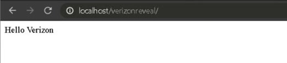

- To test the virtual directory, create a new index.html file in C:\VerizonReveal
- Open index.html in a text editor and copy and paste the content below.
<!DOCTYPE html>
<html>
<body>
Hello Verizon
</body>
</html>
- Save the text file.
- In a browser, enter http://localhost/verizonreveal
The text Hello Verizon should display on the page.

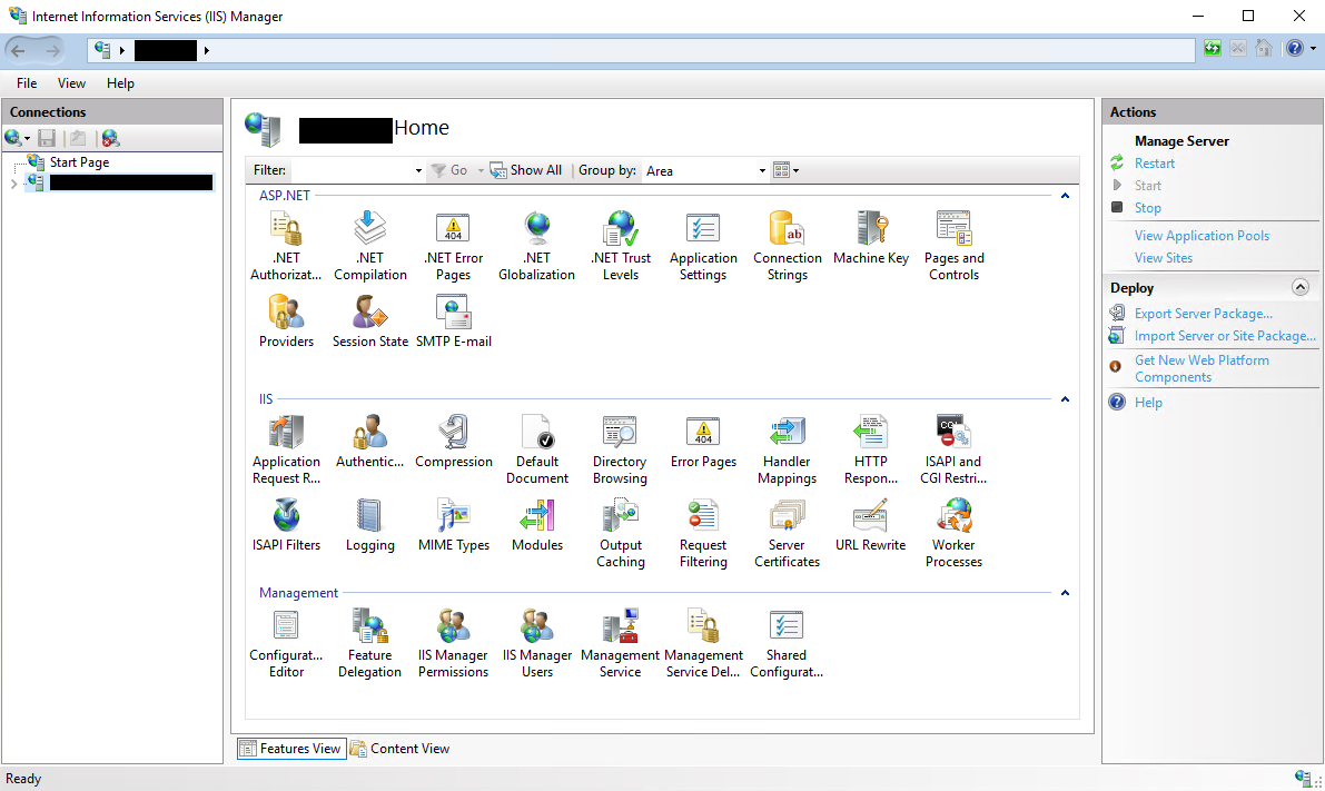

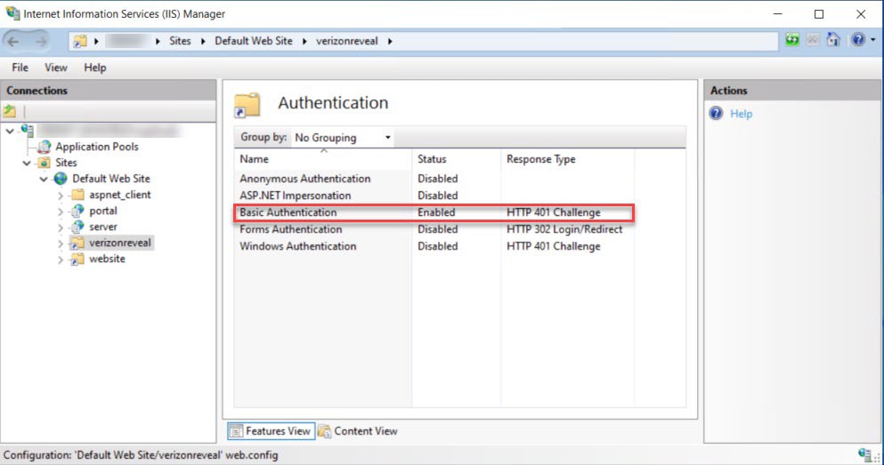

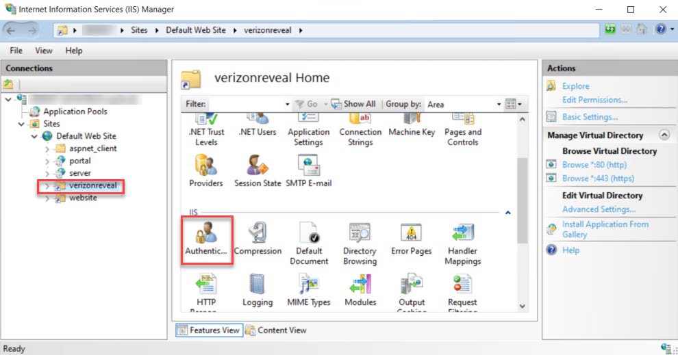

Next, it is necessary that basic authentication be enabled for the virtual directory in IIS Manager.
- Open Internet Information Services (IIS) Manager and navigate to Sites > Default Web Site and select the verizonreveal virtual directory.
- Double-click Authentication.
- Select Basic Authentication then choose Enable under Actions on the right pane
- The Anonymous Authentication status is Enabled by default, select it and then choose Disable from the Actions panel on the right.

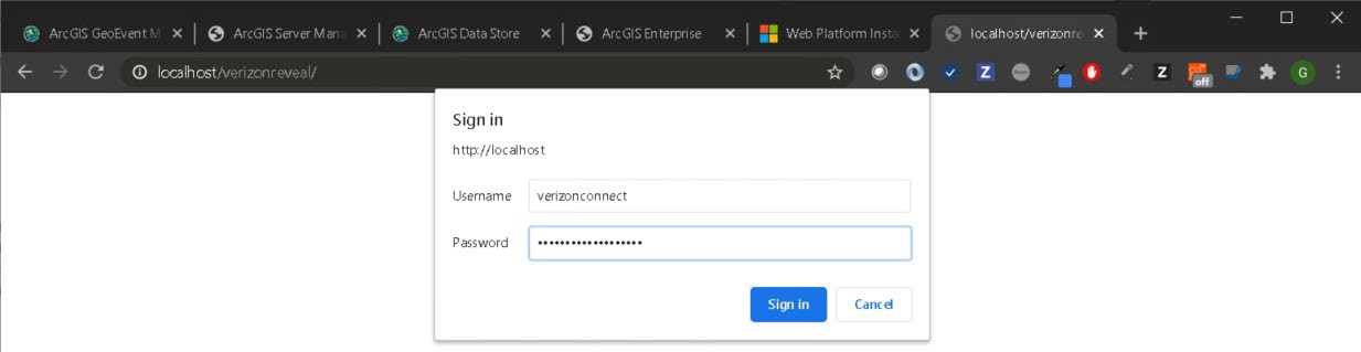

- To test the basic authentication, open the browser and navigate to http://localhost/verzionreveal/. A Sign in dialog will pop up.
- Enter your Username and Password for the verizonconnect user you previously created and click Sign in.
If authentication is successful, the webpage will display Hello Verizon, indicating basic authentication is working properly.

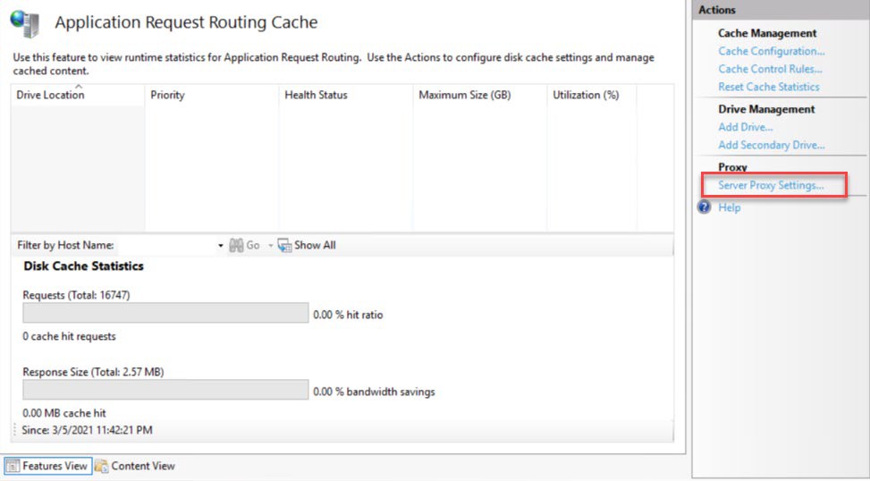

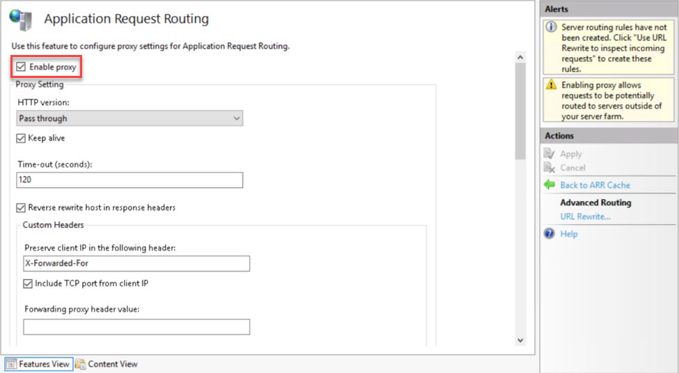

- Under the IIS group, double-click Application Request Routing Cache to open it.
- In the Actions panel, in the Proxy subgroup, click Server Proxy Settings.
- Check the box for Enable proxy and keep the default values for all other parameters.
- Click on Apply under the Actions panel to save your changes.

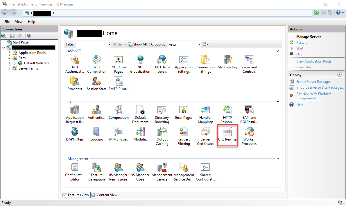

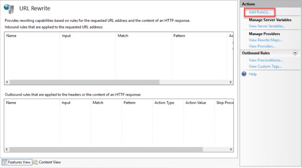

- Navigate back to Home in IIS Manager by clicking the machine name in the tree view.

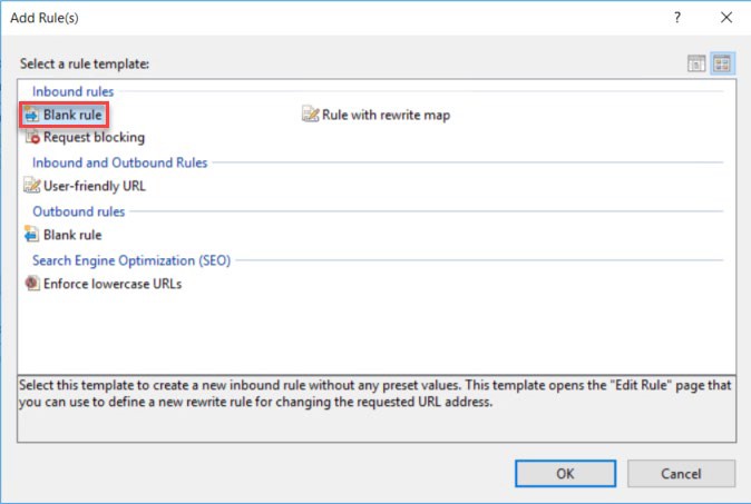

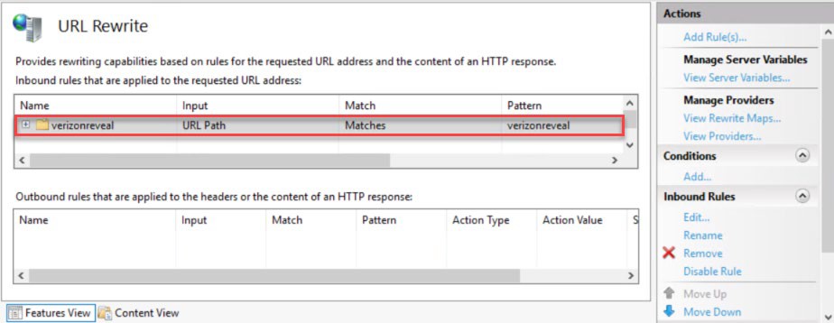

- Double-click on the URL Rewrite to open it.
- Click Add Rule(s) from the Actions panel.
- On the Add Rule(s) dialog, select Blank rule and click OK.

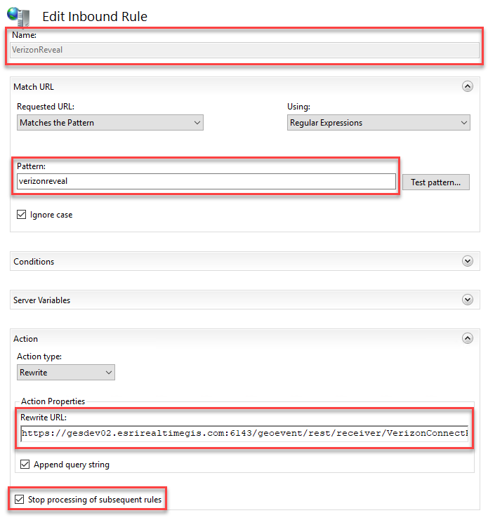

- Enter the rule configuration as illustrated in the example below.
Note: The Rewrite URL you enter should be the same URL as the GeoEvent Server input connector you created in the Configure a GeoEvent Server connector endpoint to receive data from Verizon Connect Reveal section above.
For this example, the Rewrite URL is
https://<your_server>:6143/geoevent/rest/receiver/VerizonConnectReveal-rest-json-in
- Click Apply to create the rule.
- Click Back to Rules to navigate back, the newly created rule will be listed.
Your URL should now be accessible via https://<webserverhostname>/verizonreveal

- Remote into the GeoEvent Server machine and create a folder where the output connector can write a JSON file to. Alternatively, you can register a folder on a file share that the GeoEvent service account can access.

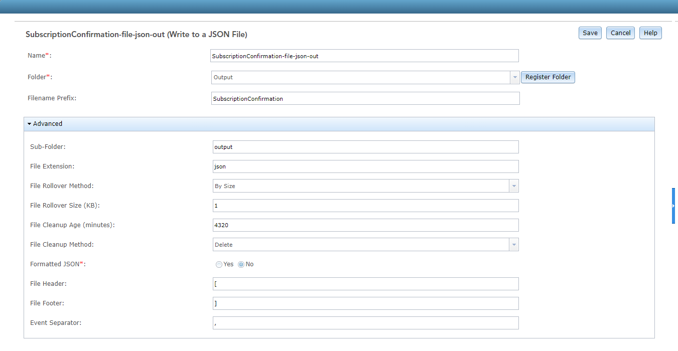

- In GeoEvent Manager, click Add Output under GeoEvent Services and name it SubscriptionConfirmation-file-json-out
- Click Register Folder and enter the path name of the folder you created in step 1.
- For Filename Prefix, enter SubscriptionConfirmation
- Keep all other values as default and click Save.

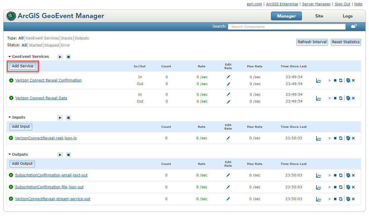

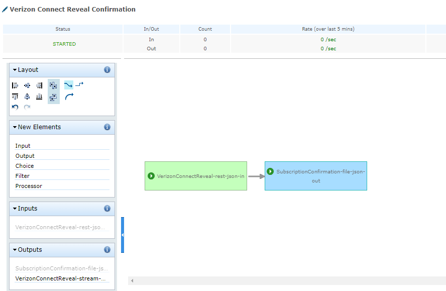

Now we must create a GeoEvent Service to connect the input and output connectors that we just created.
- In the GeoEvent Manager page, click Add Service under GeoEvent Service.
- You may provide any name of your choosing. In this guide we will be naming it Verizon Connect Reveal Confirmation.
- Drag-and-drop the VerizonConnectReveal-rest-json-in and SubscriptionConfirmation-file-json-out connectors into the service designer and connect them together.
- Click Publish.

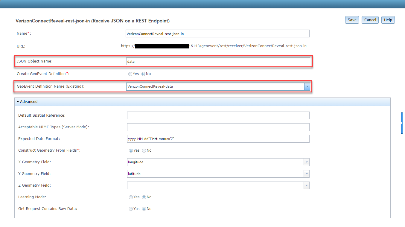

Once subscribed, we need to reconfigure the input connector to be able to receive data.
- In GeoEvent Manager, click on VerizonConnectReveal-rest-json-in under Inputs.
- Change the following parameters:
- JSON Object Name — data
- GeoEvent Definition (existing) — VerizonConnectReveal-data
- Ensure all parameters match the ones in the image below:
- Click Save to save your changes.
The input connector is now ready to receive data from the Verizon Connect Reveal GPS Push Service.

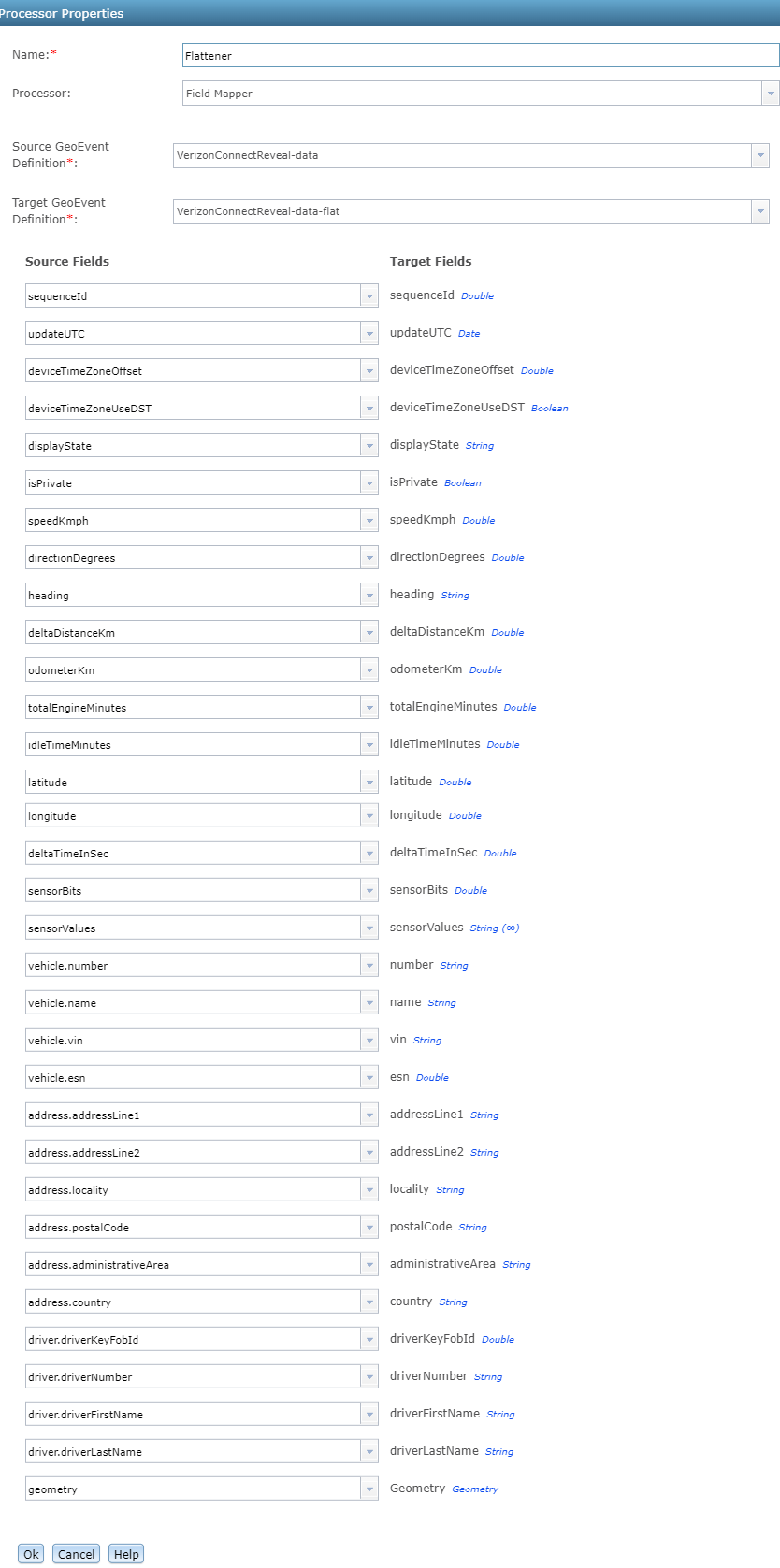

The Verizon Connect Reveal GPS Push Service data contains sub-hierarchies in its data structure. This data is not easily translated to a feature schema that can be used in ArcGIS applications. So, in this case, the GPS Push Service data needs to be mapped to a flattened schema first.
The GeoEvent configuration file included in this guide which includes two GeoEvent Definitions (schemas):
- VerizonConnectReveal-data – The incoming data from the GPS Push Service from Verizon Connect Reveal
- VerizonConnectReveal-data-flat – The flattened version of the above schema. The GeoEvent service should use the Field Mapper processor to map to this GeoEvent Definition.
When creating your GeoEvent Service, please ensure you use a Field Mapper processor to map event records to the flattened schema.

"UpdateUTC": 1614364635000,
"DeviceTimeZoneOffset": -5,
"DeviceTimeZoneUseDST": false,
"DisplayState": "Moving",
"IsPrivate": false,
"SpeedKmph": 30,
"DirectionDegrees": 340,
"Heading": "North",
"DeltaDistanceKm": 0.54,
"OdometerKm": 64853.82300541169,
"TotalEngineMinutes": 179742,
"IdleTimeMinutes": 0,
"Latitude": 35.78075055555556,
"Longitude": -77.90424,
"DeltaTimeInSec": 89,
"SensorBits": 0,
"geometry": {
"x": -77.90424,
"y": 35.78075055555556,
"spatialReference": {
"wkid": 4326
"f": null,
"token": null,
"SensorValues": null,
"Vehicle": {
"Number": "1234",
"Name": "Truck1234",
"VIN": "1ABCDEF567890",
"ESN": 13000000
"Address": {
"AddressLine1": "4020 State Rd 1327, Elm City, NC 27822, USA",
"AddressLine2": "4020 State Rd 1327",
"Locality": "Elm City",
"PostalCode": "27822",
"AdministrativeArea": "NC",
"Country": "USA"
"Driver": {
"DriverKeyFobId": 0,
"DriverLastName": "Bond",
"DriverFirstName": "Jason",
"DriverNumber": null
