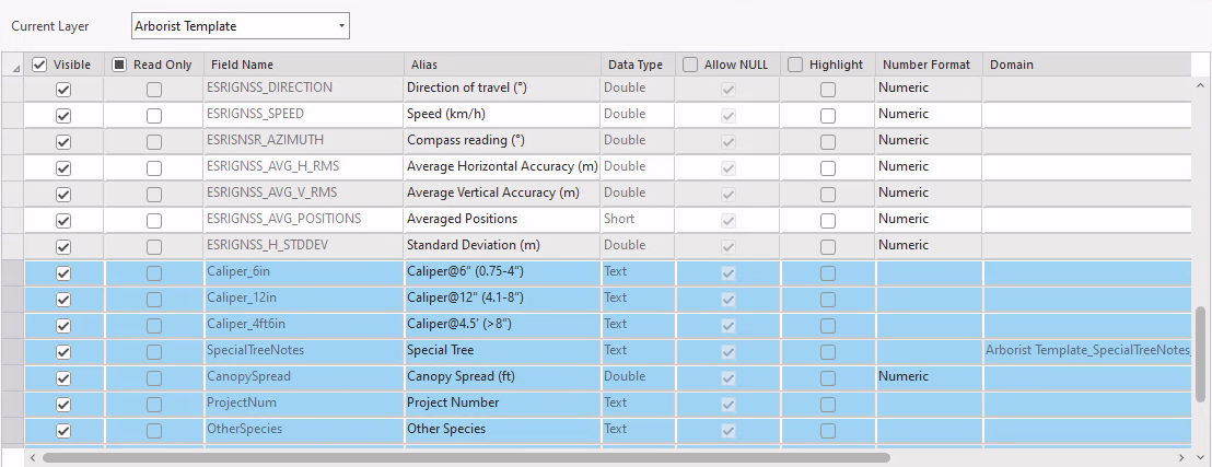

I'm trying to export a .cvs file (in Pro) from a feature layer hosted on ArcGIS Online. The feature layer is used in Field Maps and includes all the GPS metadata fields. It also has several other fields that were added later.

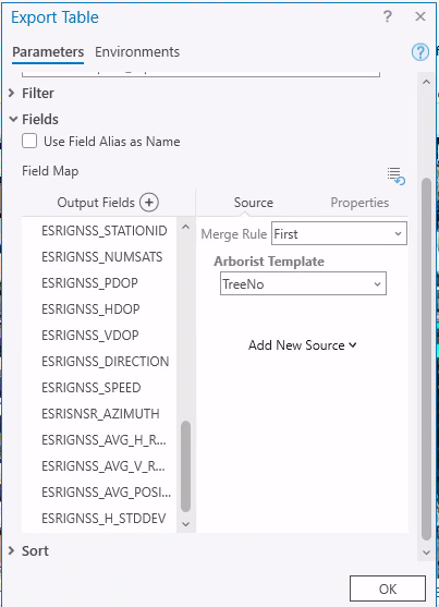

The issue I'm seeing is that when I use Export Features tool (from the contextual menu you get when you right click on a layer in the table of contents) or the Export tool (from the hamburger menu at the top right of the attribute table), I only have the option to export the original fields and the metadata fields. The newer fields (which have still been there for months) are not included in the Fields section of the export dialog boxes and do not get exported with the rest of the data. However, if I use the Table to Excel geoprocessing tool, it exports all the fields.

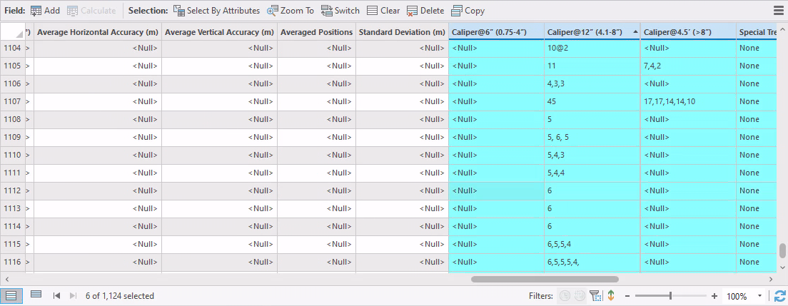

I can see all the fields in the attribute table, and I don't see anything different about the new fields in the Fields View.
