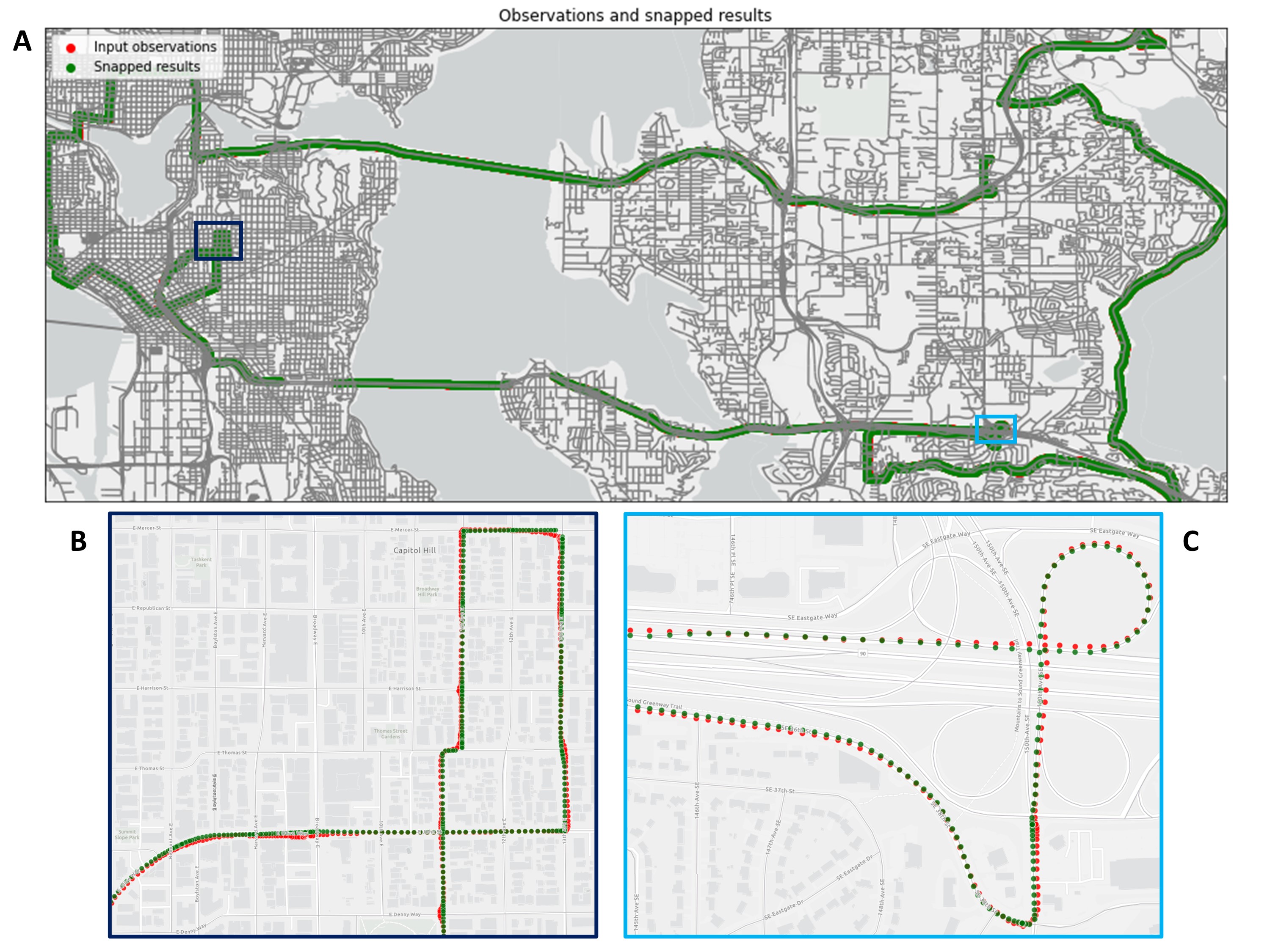

The code snippets below demonstrate an example use case of Snap Tracks using 1) a freely available test GPS dataset from a drive on January 17, 2009, in the Seattle, WA area, and 2) the road network data of greater Seattle, WA. Figure 1 shows the output of the tool that snapped the raw GPS points to the traversed road network.

Figure 1. a) GPS points snapped to the traversed road network across the Seattle area; b, c) zoomed-in views to highlight two road segments where green points and red points correspond to the snapped (on to the actual road) and raw GPS points, respectively.
