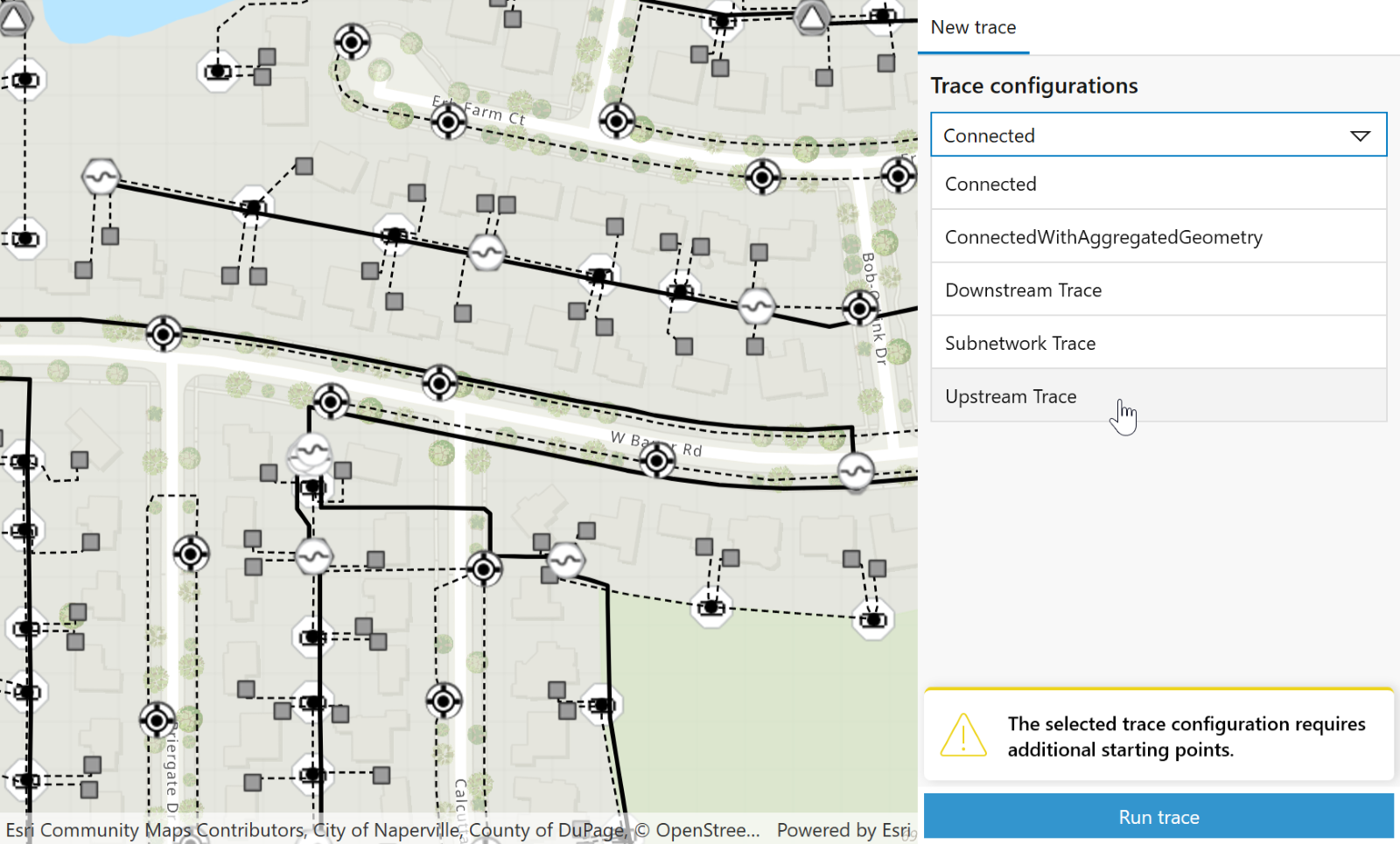

Web maps power the Utility Network Trace Tool. When a map includes a utility network, any associated named trace configurations are loaded. If there are multiple utility networks, you can select which network to use. Otherwise, the first step is to choose a trace configuration from the list:

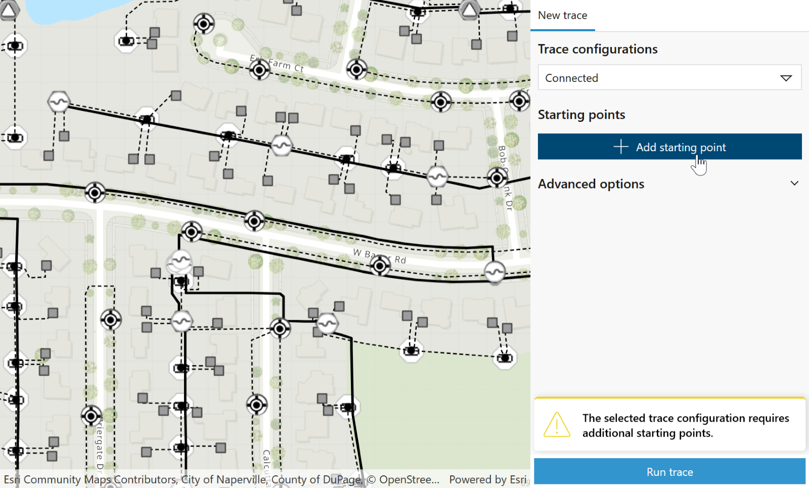

After selecting the trace configuration, you define starting points for the trace. You can add starting points programmatically or by interacting with the map.

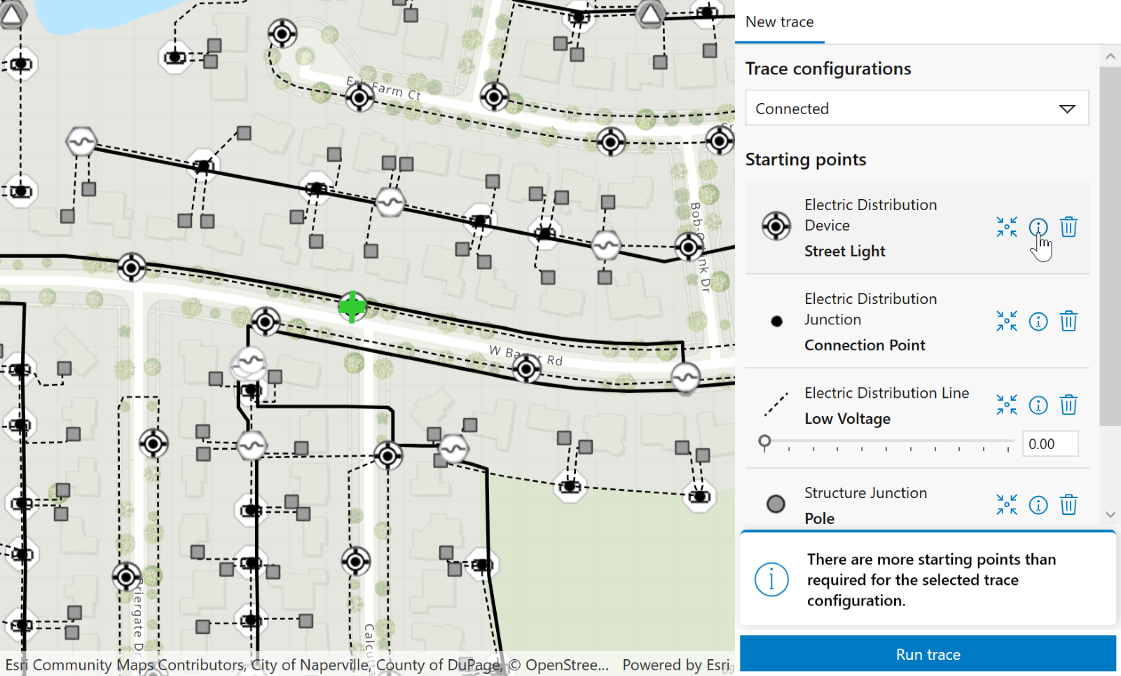

Trace starting points often overlap, so the tool uses a wide area tolerance to simplify selecting the desired point. You can then inspect the popups for individual starting points if you need additional information to make the right choice.

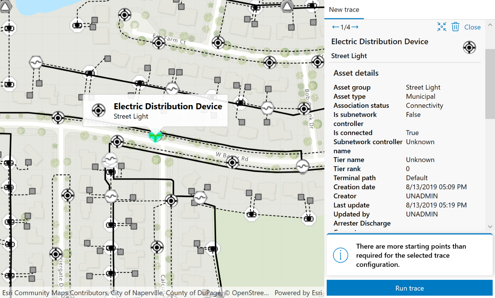

While in the inspection view, you can see the popup and symbology, with the option to delete the starting point:

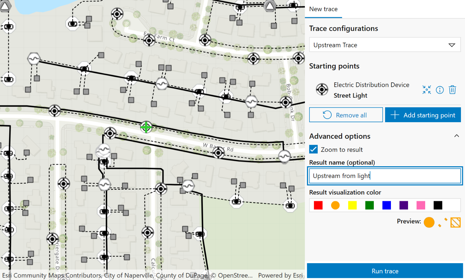

After selecting the desired trace configuration and starting points, you can run the trace. You can also choose a name and a result color to help keep track of and compare multiple results.

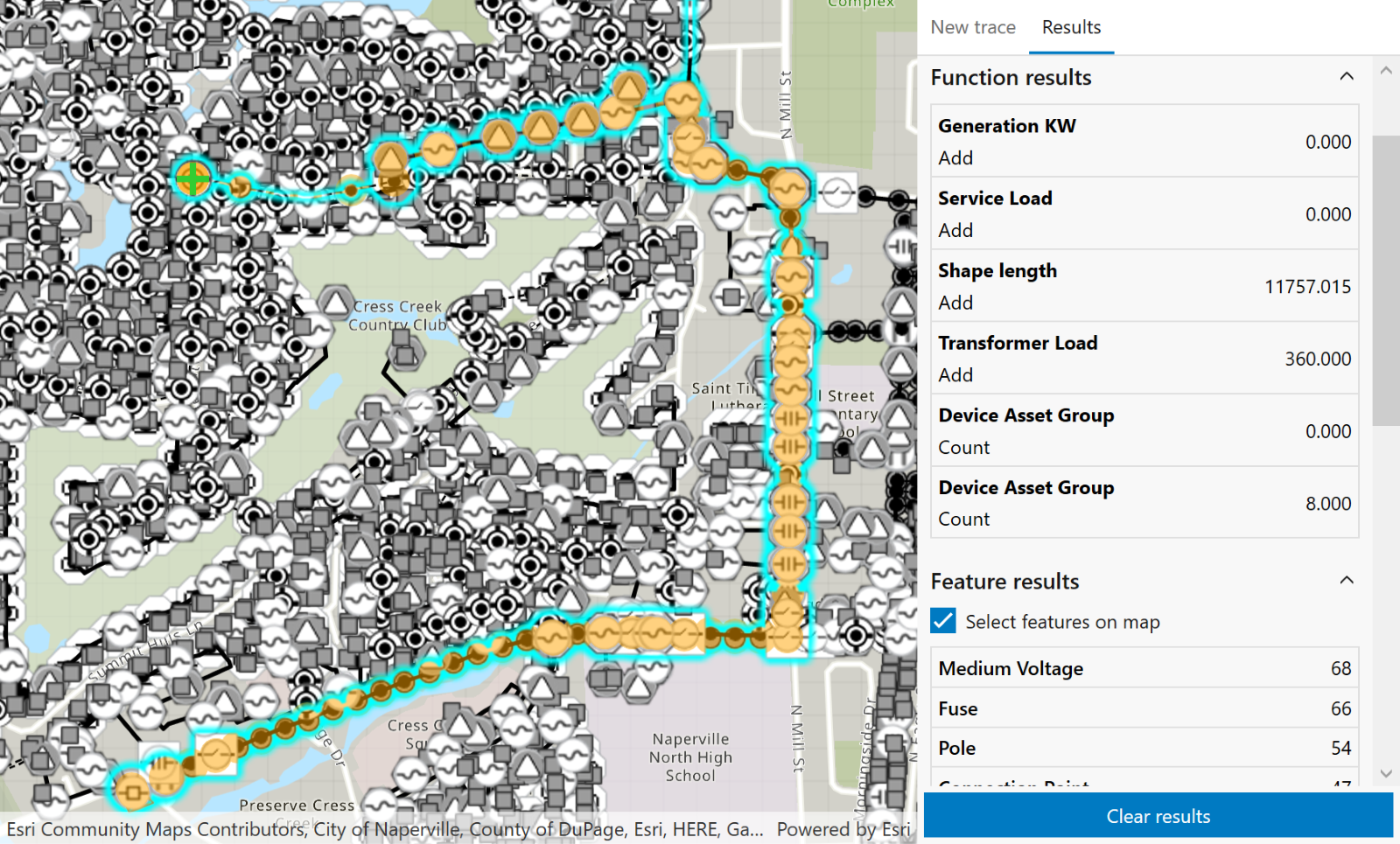

After the trace completes, you will see graphics, features, and function results, with the option to hide and show trace results.
