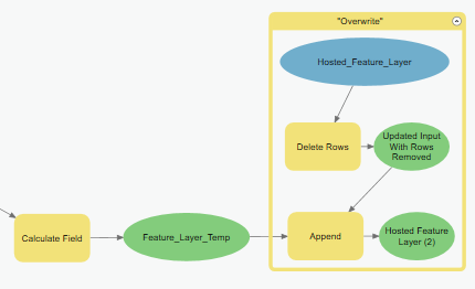

For background I have a Hosted Feature Layer, that is overwritten daily. The data is coming from a CSV that gets processed in ModelBuilder.

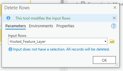

1st Delete Rows removes all records from the Hosted Layer

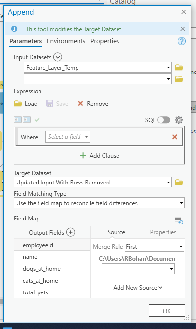

2nd Append the Hosted_Feature_Layer with the processed Feature_Layer_Temp
Every time the model runs the entire Hosted Feature Layer is refreshed with new data from the processed CSV. The Hosted Layer id stays the same, so no need to reconfigure anything consuming he layer.
The only downside is the ObjectID increased every time the model is run.
I would love to see the Delete Rows and Append combined in a single Overwrite tool. Perhaps improving the ObjectID issue.
