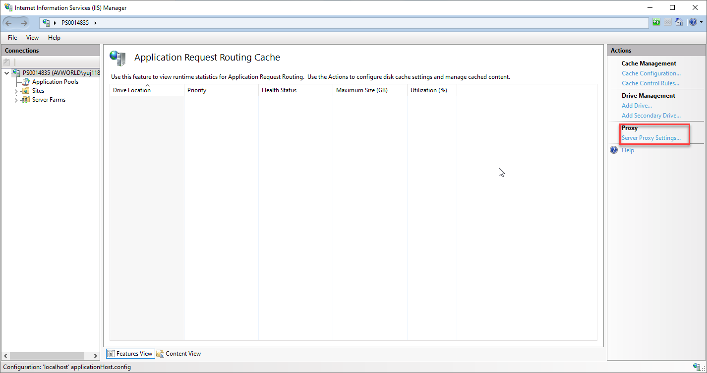

Run IIS as the administrator and navigate to the Application Request Routing Cache. Click on the Server Proxy Settings on the rightmost toolbar as seen in Figure 1 below. After it takes you to the configuration page for ARR, check the box next to Enable proxy near the top of the page. Click on the Apply button to make sure it’s saved.
Figure 1. Homepage for Application Request Routing Cache

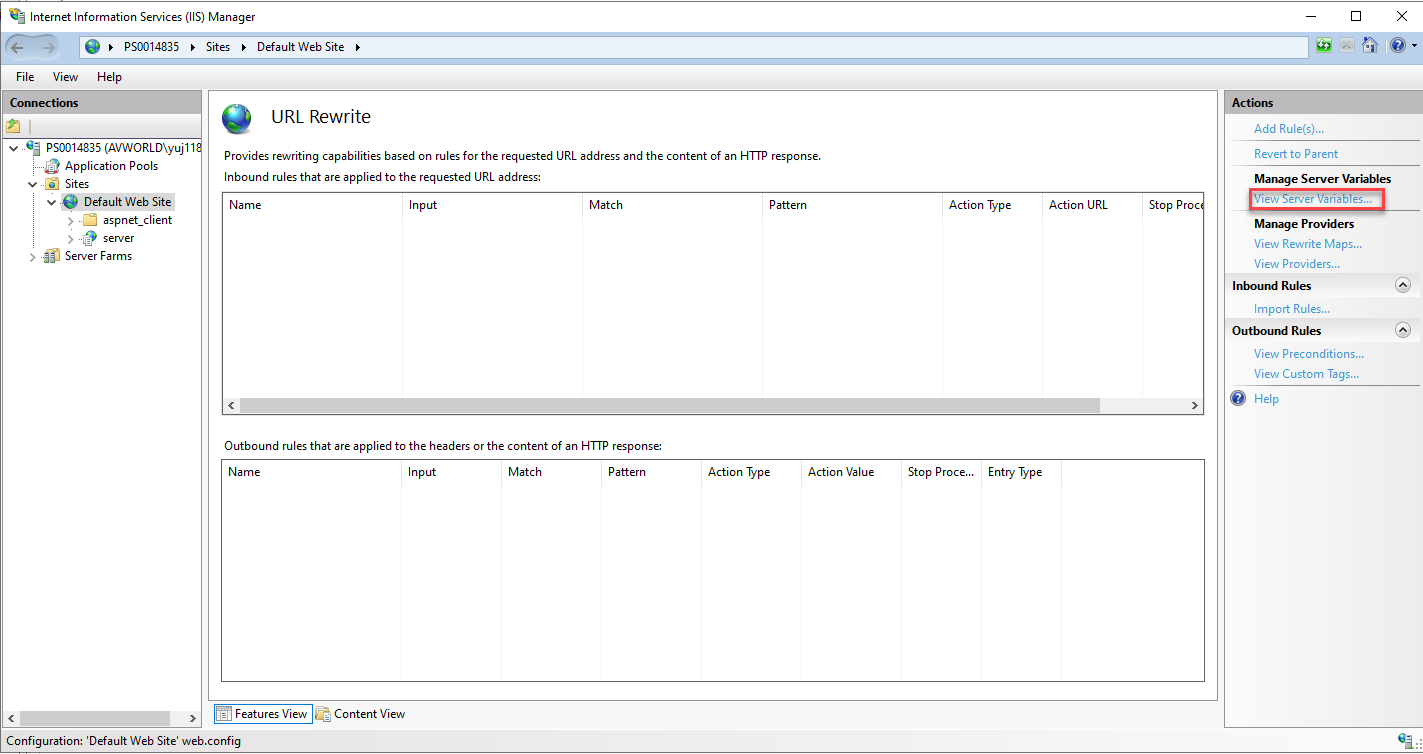

After proxy is enabled, go to your Default Web Site Home and click on the icon for URL Rewrite. On the toolbar on the right, under Manager Server Variables, click on View Server Variables as seen in Figure 2 below.
Figure 2. Homepage for URL Rewrite
After reaching the list of allowed server variables, click on the Add button and add a server variable named “HTTP_SEC_WEBSOCKET_EXTENSIONS”. Navigate back to the homepage of URL Rewrite.

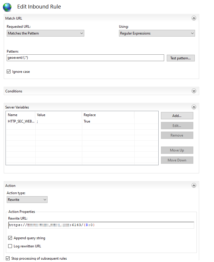

Click on Add Rules and select the Blank rule template within the Inbound rules section and give it a name. The screenshot below (Figure 3) shows an example configuration of the rule for GeoEvent Manager. The hostname and domain should be replaced with your ArcGIS GeoEvent Server’s hostname and domain. This rule replaces any part of a request pattern starting with the path element ‘geoevent/’. One thing to note is that in the Server Variables section, we are replacing HTTP_SEC_WEBSOCKET_EXTENSIONS with “;”. This is because ARR does not support the compression of WebSocket data packets, and we need to remove the header portions of connection requests that enable that capability.
Figure 3. Inbound rule for GeoEvent Manager
After the rule is configured, click on the Apply button on the right to make sure it’s saved.

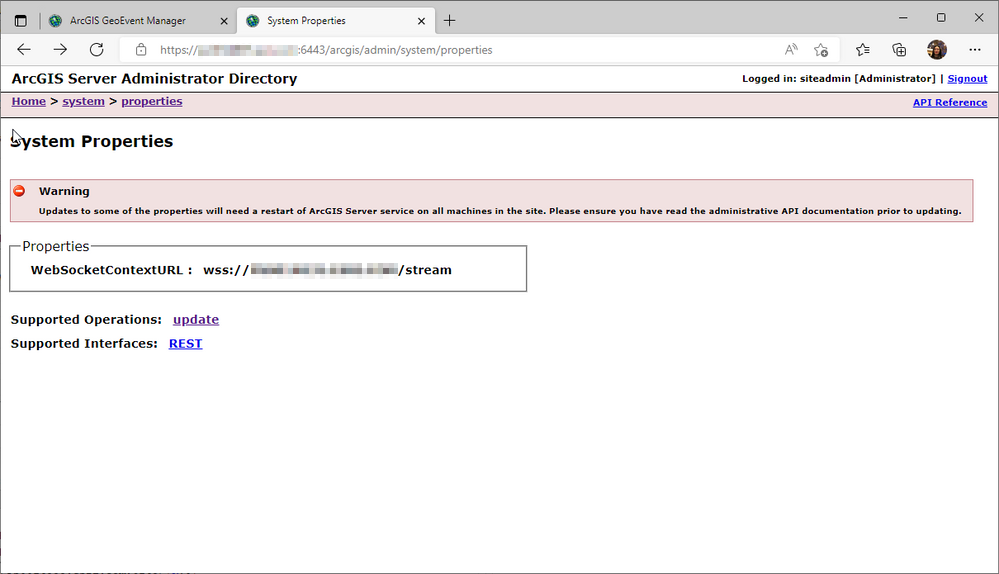

For stream service, an extra step is needed to configure ArcGIS Server first. Navigate to your ArcGIS Server Administrator Directory. Go to system -> properties and add a WebSocketContextURL (Figure 4). As an example, the URL we use is wss://{GeoEvent hostname}.{GeoEvent domain}.com/stream, which corresponds to the pattern used in the inbound rule we will create for stream service. After the property has been added, click on any of the stream services on this server. Its web socket URL should reflect the change.
Figure 4. System properties of ArcGIS Server

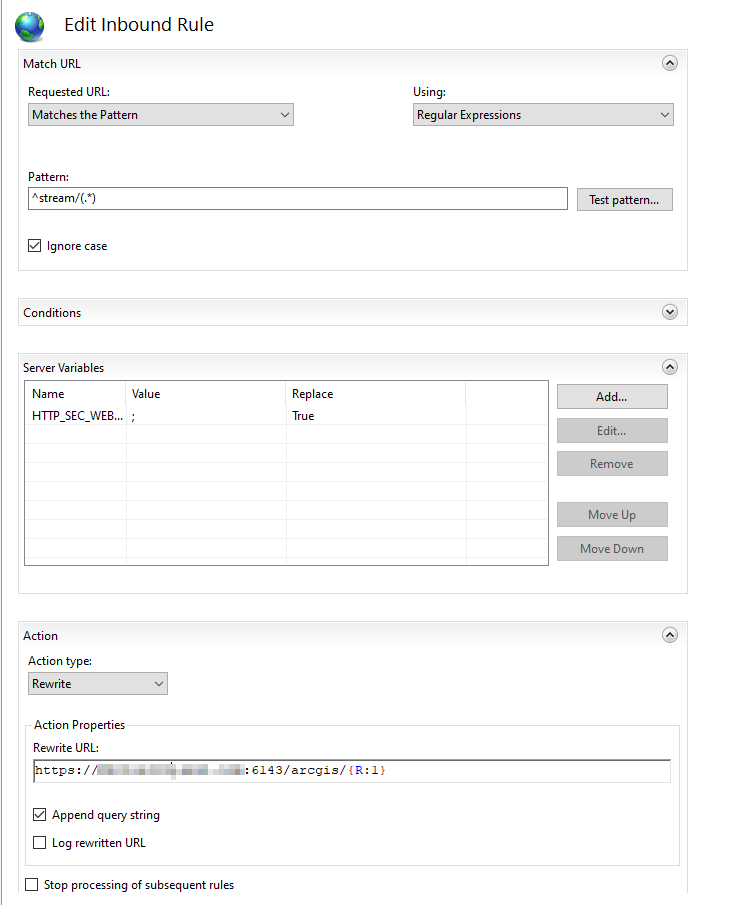

Go to IIS again and add another rule for stream service. The screenshot below (Figure 5) shows an example of the configuration. Again, the hostname and domain should be replaced with with your GeoEvent Server’s hostname and domain.
Figure 5. Inbound rule for stream service

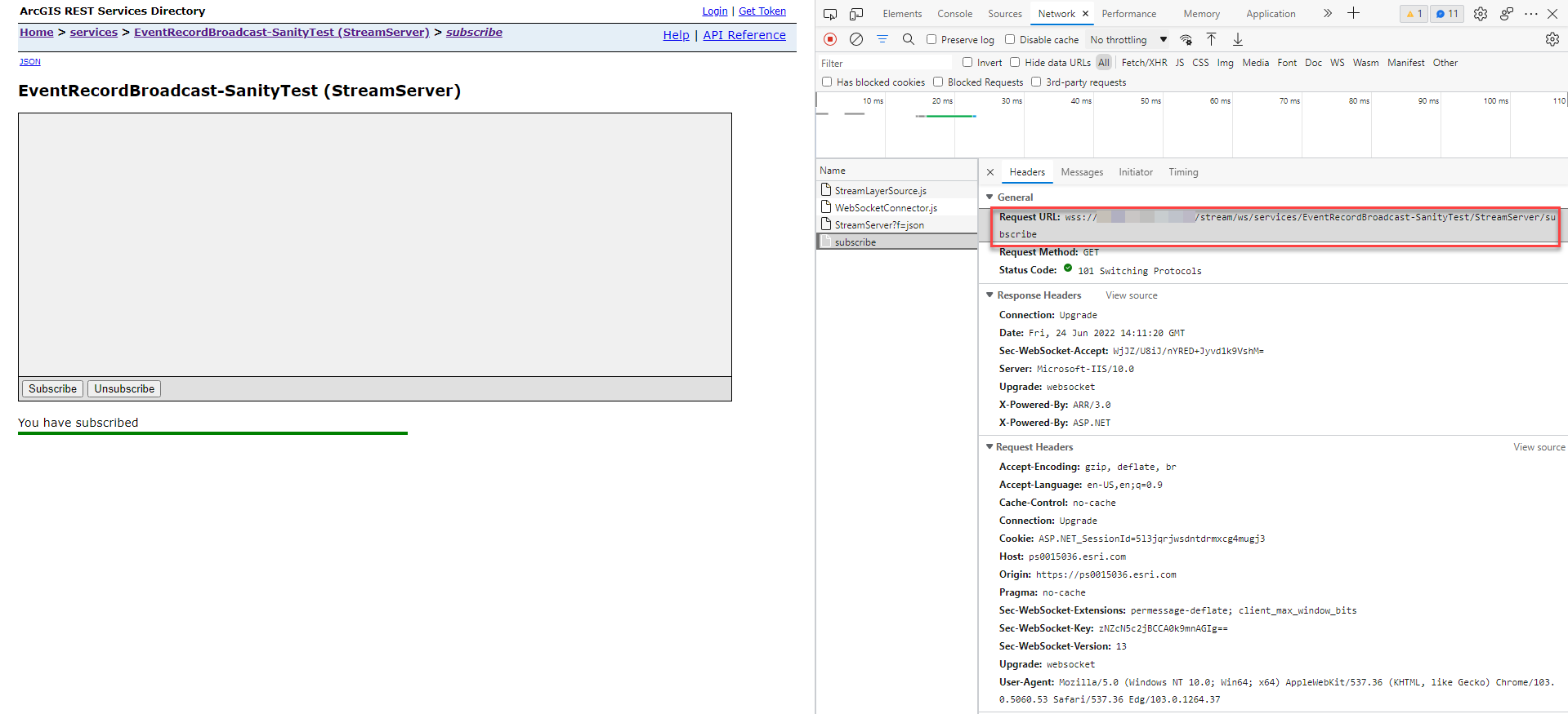

After the rule has been created and applied, go to one of the stream services and verify you are able to subscribe to it (Figure 6).
