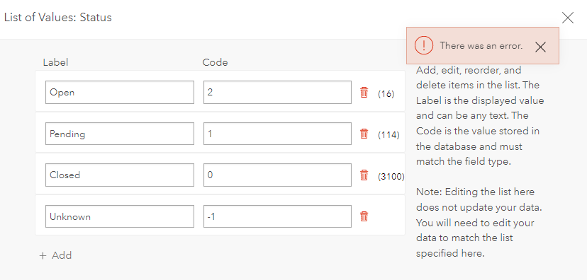

Has this ever happened to you? You go to edit a field's List (AGOL / Enterprise term for a domain), and you get this message:
Not the most helpful of error messages, but if we take a look at our browser Developer Tools, we can see this response:
"error": {
"code":500,
"message":"JSONObject[\"description\"] is not a string.",
"details":[]
}What's going on here? I can see that the description is null in the payload sent to the server:
... "description":null, ...
You could attempt to open the URL your request was sent to, edit the payload, and resubmit. But that feels a bit hacky.
There's something funny here, and a recent comment elsewhere led me to believe that this was a 10.9.1 issue. Regardless, I've got domains that do have descriptions, and I still get this message. Now, I could fix these domains by republishing the layer, but that's sort of like swatting a fly with a baseball bat. Some alternative method is needed.
