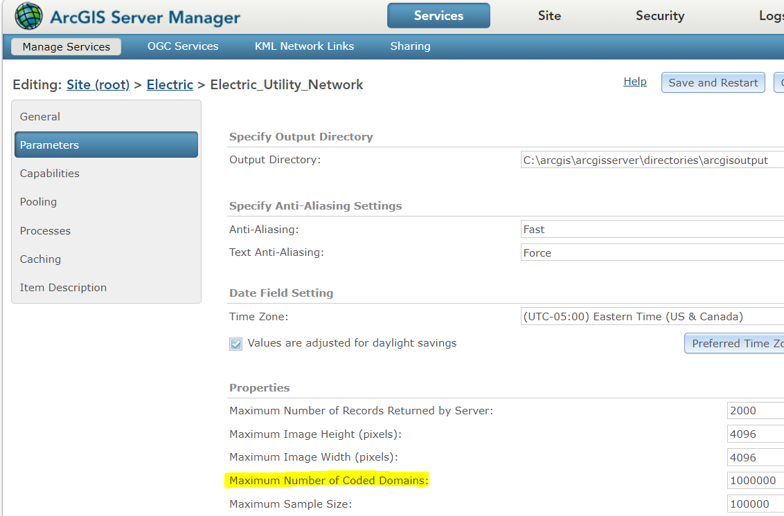

Another setting that is sometimes forgotten is the maximum number of coded domains. The default value of 25,000 may not be large enough for a Utility Network. Change the value to 1 million: 1000000
But why? Let’s do the math. There are at least 12 database objects in your Utility Network. As an example, the Electric Utility Network model contains an average of 38 fields and 13 subtypes in each object. Suddenly the number creeps to a range closer to 25,000. If you choose to enhance the data model, the number of coded domains can exceed more than the default.
Remember, with the default setting, 25,000 is the maximum number of domain codes that can be returned from all fields, subtypes, layers & tables. When the number of domain codes returned by the MaxDomainCodeCount property exceeds the default value, the service may continue to run normally, but you will see the domain descriptions not displaying as expected for some attributes. In addition, errors will be captured in your ArcGIS Server logs.
So, remember to increase the maximum number of coded domains in the configuration tab while sharing the web layer. Share Tab > Web Layer > Publish Web Layer > Configuration tab > Click the Feature’s pencil icon > Configuration Parameters tab > tip open Advanced
You can also edit it with the ArcGIS Server manager, as shown below.

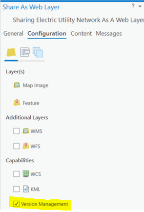

To publish a Utility Network Service, all feature layers and tables that are added to the publishing map must be registered as a branched version. An efficient way to find out the publishing map’s conformance to this is by inspecting the Configuration tab: Share Tab > Web Layer > Publish Web Layer > Configuration tab
If you see an option to enable “Version Management” capability in the Share As Web Layer pane, you are all set. This confirms that all the feature layers are registered as branched versions in your publishing map.
CAUTION: Do not spend any time changing symbology, renaming layer names or other map changes, before checking that version management capability is present in the configuration tab. This could be all for nothing if you can’t enable Version Management.
Sometimes, things do not go as planned/expected. Without the Version Management capability, Utility Network functionality won’t be available upon publishing. Troubleshooting steps include:

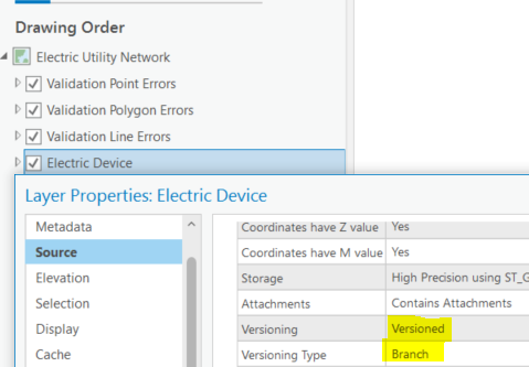

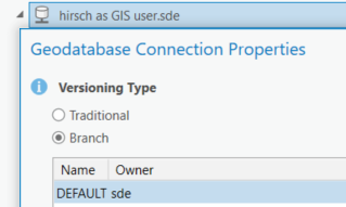

- Make sure the layers added to the map come from a Geodatabase connection file whose versioning type is Branch. You can check it here: Catalog > Right click on Geodatabase connection file > Geodatabase Connection Properties
- Inspect each layer in the map and confirm its versioning type is Branch. (Right click on a feature layer > Properties > Source)
- If the layer is not flagged as branched in the properties dialog, remove it from the map and add it again using the branched geodatabase connection file.

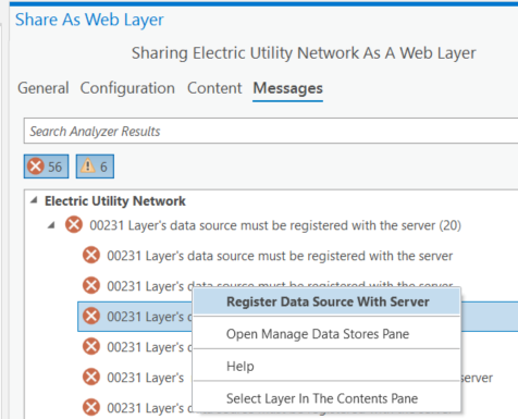

When you analyze the map to publish your Utility Network Service for the first time, you are most likely to encounter an error indicating that the “Layer’s data source must be registered with the server.”
An effortless way to navigate this error is to right click on error message for one of those layers and choose to register data source with server. You will be prompted to add your data store to your server.
Upon successfully resolving the error for one layer, the other layers will be automatically updated. Click Analyze in the Share as Web Layer pane to make sure all the errors are cleared out.

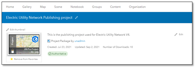

Upon successful publishing of the Utility Network service, it is always a good idea to back up the ArcGIS Pro project so that you have a copy of all the configurations & the database connection files. This will come in handy when you need to make changes to the existing service, have multiple administrators managing the Utility Network environment, when upgrading the enterprise version or when gearing up for creating another service.
There are different ways you could back up your ArcGIS Pro project: saving the project from your local machine to a network drive or uploading it to your portal. If you choose to upload to portal, you can share it with others for collaboration. Also, you can use groups to ensure that only a certain member of staff can access it. There is also an option to mark that project as Authoritative which indicates it’s a trustworthy project to use.
