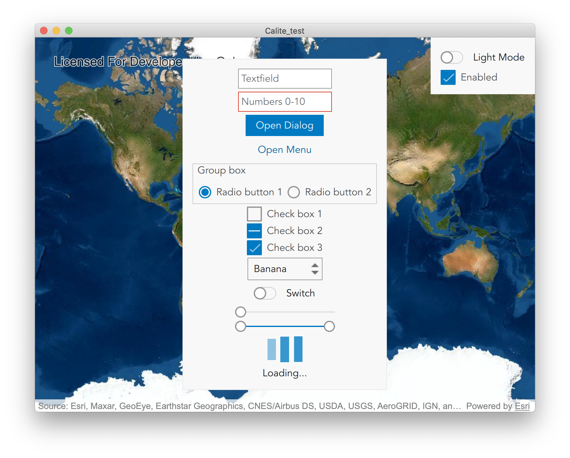

Calcite QML Style
You may have noticed that our examples apps have a special style applied to them - this is the new Calcite style for QML, based on Esri's Calcite for Javascript. We provide this style for developers that want their apps to have a familiar look and feel to the rest of the Esri ecosystem.
