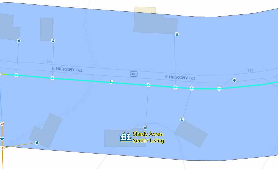

Understanding Who is Nearby

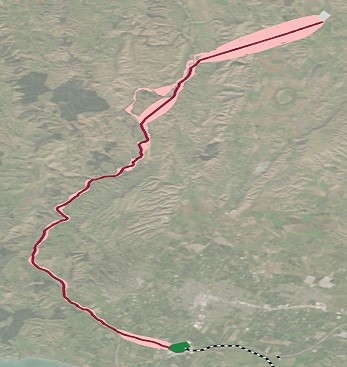

Every person who resides or congregates near a pipe section is at risk of being impacted by the failure of that pipe section. As stated previously, this is key to quantifying the overall risk to the organization. Spatial analysis methods, such as buffer, can define the area near the pipe segment to look for persons and places of gathering.
More advanced spatial analysis methods, such as least cost path analysis, enable pipe utilities to identify the direction in which spilled liquids will flow. Once these spatial areas near the pipe segment are identified, it is a simple intersect analysis against data sets which identify the number and type of persons who reside or congregate within the now identified areas of impact.
With this analysis capability, pipe utility organizations can quantify the consequence of the failure of a pipe segment to persons.

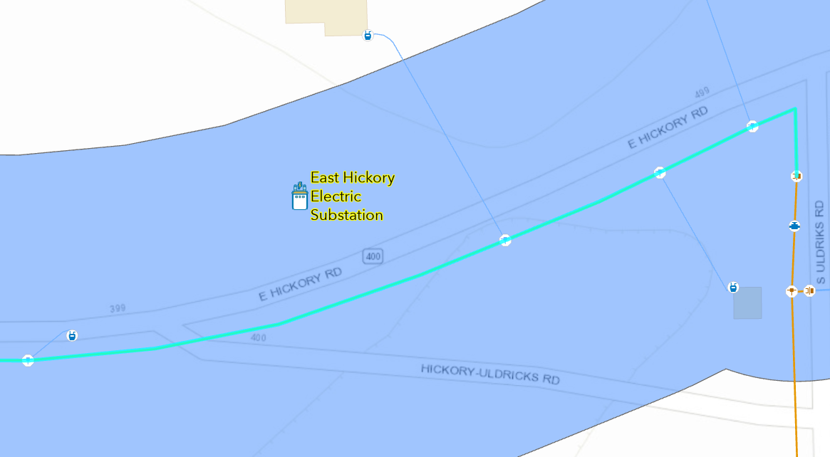

Understanding What is Nearby
The cost to the pipe organization of the failure of a pipe section includes not only the impacted persons, but also the impacted facilities. Having your own facilities damaged is bad enough, but also having to pay to repair the facilities of other utilities can be much more expensive. Understanding the consequence of failure to facilities goes beyond electric, telecommunications, and other pipe utilities, it includes transportation network systems such as road and railroad. No pipe utility wants to be the one that caused a major road route to be closed due to the damage caused by the pipe section failure.
The same ArcGIS analysis tools used to identify persons impacted by a pipe section failure (Buffer, Least Cost Path, Intersect, Identity) are the tools used to identify and quantify what facilities are impacted.
This understanding of the consequence of failure to nearby facilities further clarifies the true risk to the organization. But there is still one more critical consequence to be understood and quantified. That is the consequence to the pipe utilities customers who are downstream of the pipe section which has failed.

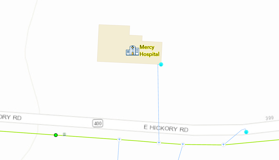

Understanding Customers Downstream
When a pipe section fails, customers downstream of that point of failure will be without the transported commodity until repairs are completed. This means that natural gas and district heating customers could be without heating in the middle of a winter deep freeze. District cooling customers could be without air conditioning during a summer heat wave. Both consequences of failure can literally result in death to customers.
Programmatically understanding and quantifying the impact to a pipe utility’s customers requires a different set of spatial analysis tools. These different spatially aware analysis tools need to understand how the pipe network of pipes, valves, and fittings connect to create a pipe network. Only when a software application understands how a commodity flows through the pipe network can the analysis quantify the consequence of failure to the customers.
This pipe network aware tool which is critical to measuring the consequence of failure to customers is the downstream trace. The downstream trace is a configuration of the Trace tool provided with ArcGIS Utility Network.
With this type of spatially aware analysis, it is now possible to quantify how many critical facilities such as hospitals, senior living complexes, refineries, power generation plants, and major manufacturing facilities are impacted by the failure of a pipe section.
