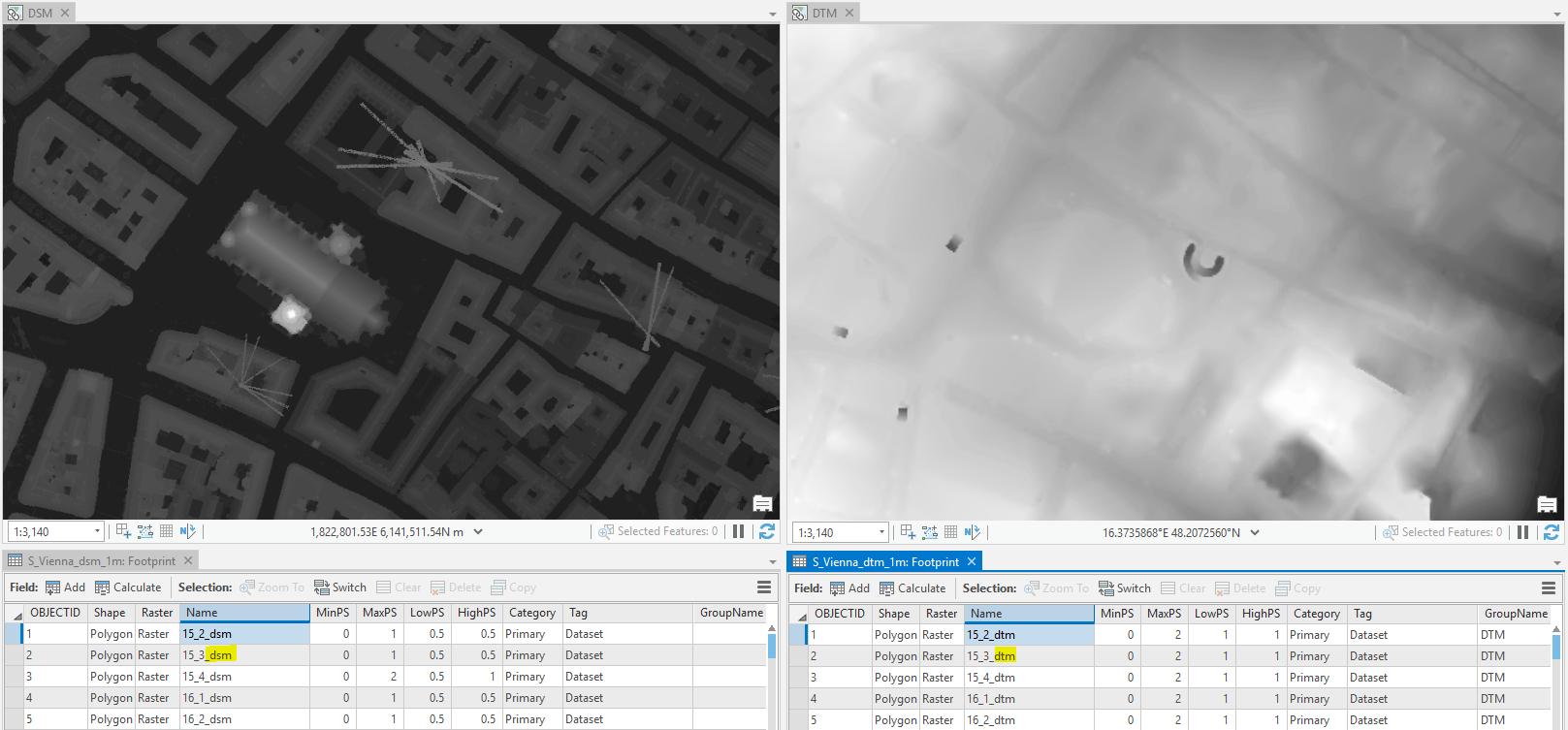

Here are the two source MDs side by side: At left, the DSM (central Vienna, Stephansdom area); at right, the DTM with the rasters listed below in TableView. In the Catalog window, it looks like this:

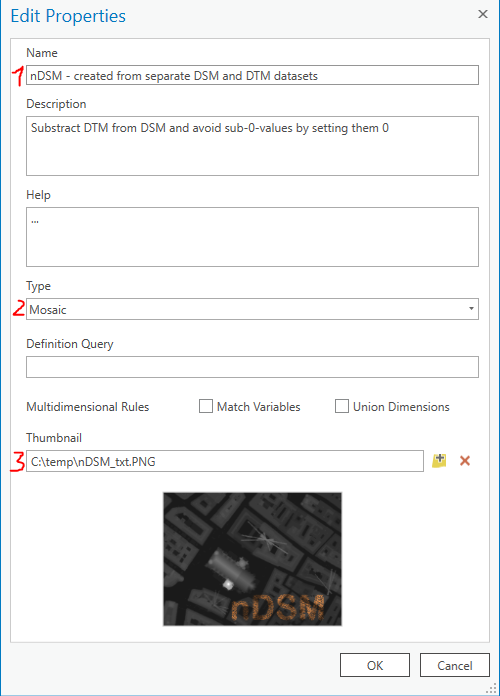

The Function Editor will open with an empty template called None. Open the properties first:
This will display the Edit Properties form—see the important settings noted in red:
- This is the name displayed later in the UI for selecting this template—choose one that is unique and self-explanatory.
- The function template you create will apply to the mosaic as such—this is important.
- Think about creating and adding a visual for the function—not mandatory, though—then click OK to confirm.

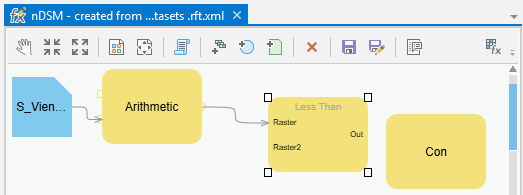

Open the Raster Functions pane again, and first search for "Less", then for "Con", and add both to the Function Editor:
Once they are added, you will need to make the necessary connections. Start with connecting the output of the Arithmetic function with the Less Than function. You will want the output of the Arithmetic function to be the first raster in the Less Than function:

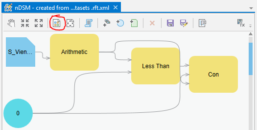

Here's how it looks once you are done connecting:
You can clean it up using the Auto Layout button, then it should look like this:

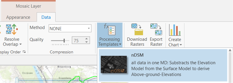

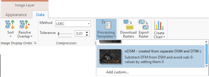

You can now use this template in the UI of ArcGIS Pro and ArcMap or through services:

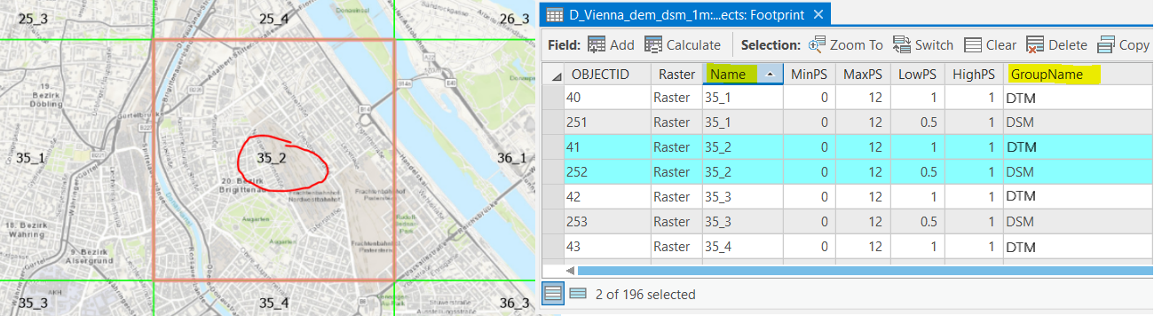

In this dataset, for any selected tile in the map, two records will be found. In the attribute table
- Name will show the property the datasets share, here, the tile (could also be the date).
- GroupName in this example uses the built-in field to specify whether this is the DEM or the DSM dataset. In other workflows, a separate field called DEM Type is used for this.
Important: What needs to be fulfilled here is that every request for the common item (here, Name equals Tile) returns just one item of the specified group (here, GroupName equals DSM or DEM). They do not necessarily need to overlap 100 percent. Every request can contain more than one of the (here) tiles—like in the screenshot above to the left, nine tiles would be returned!

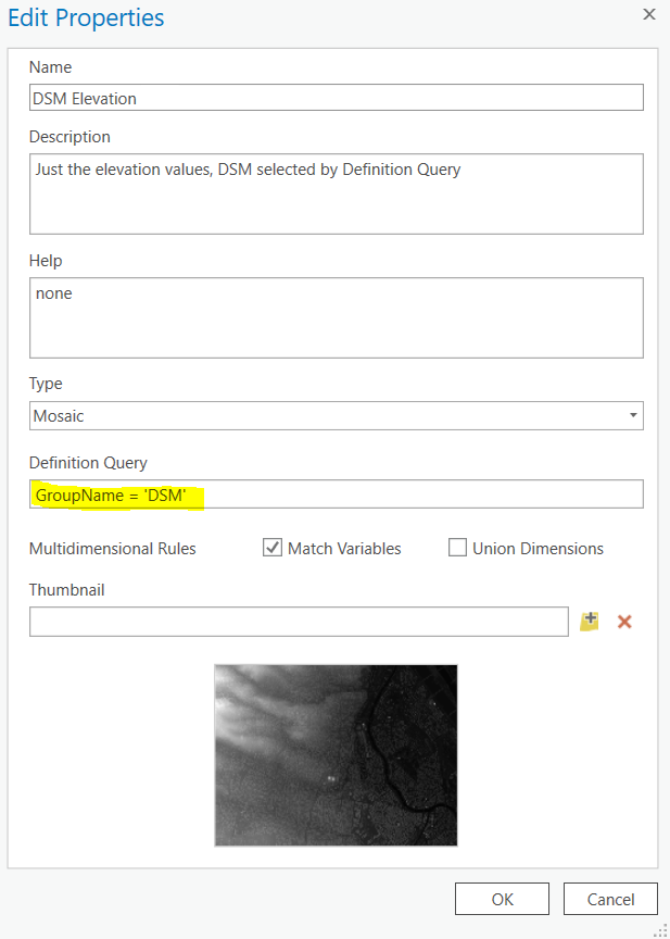

Before going through the workflow – another hint: To just use DEM or DSM from this dataset and base whatever function template on those is very easy, just use a definition query:
In this example, the definition query (highlighted) would filter out only the DSM datasets for use with this Raster function.

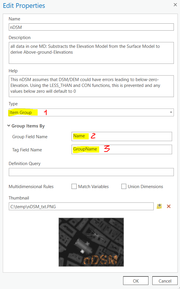

This will display the Edit Properties form—see the important settings highlighted that differ from the first example:
Choose a different name and description (and thumbnail) and make sure to adjust these important settings (noted in red):
- Change the Type parameter to work on Item Group now (instead of Mosaic previously).
- Type the field name here that reflects the common group identifier (in this example, the tile name).
- Type the field name here that contains the dataset type identifier (in this example, DSM and DTM).
Then click OK to confirm.
