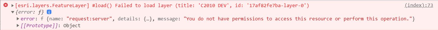

The view and basemap load in the app, but a login never appears and the API seems to be aware that I'm trying to display a secured feature layer because I get the following errors in the console.
The blurb I pasted above from ESRI's JS API documentation implies that calling the feature layer should have triggered IdentityManager to prompt the user for login, but it isn't doing that. No login form appears. What is the expected behavior here?
