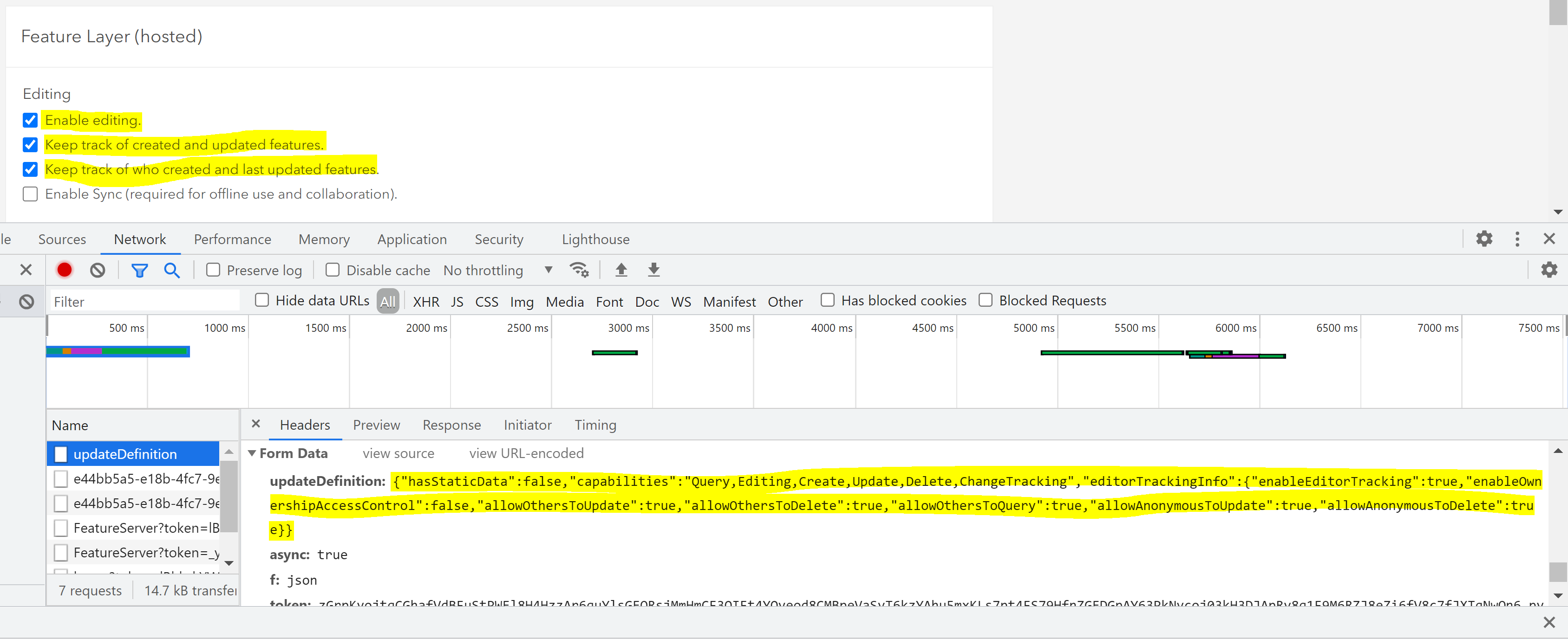

This time, I am trying to enable editing and editor tracking on a hosted feature service. I started by opening up the Chrome developer tools Network monitor, then on the Feature Layer settings page I manually checked the options 'Enable editing', 'Keep track of created and updated features' and 'Keep track of who created and last updated features', then hit Save. I then saw the console send an update_definition request.
I copied the form data and popped that into my update_definition method in my python notebook @ line 13

Reviewing the properties/definition however, I noticed that under nothing in the definition actually was updated, other than 'hasStaticData' which was changed from False to True. 'ChangeTracking' is not listed as a capability and the editorTrackingInfo array is not present in the updated definition.
