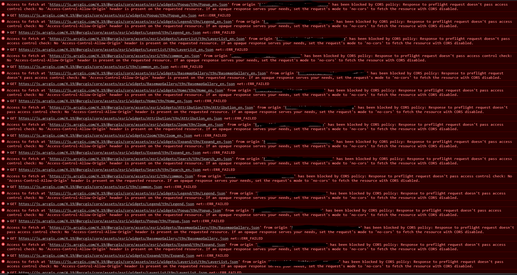

I removed the line that was setting the assets path, removed the copy of assets locally and updated the reference to the CSS stylesheet. all is _almost_ well; the app loads, requests are made to the assets, paths are correct, BUT I am getting CORS errors from the ESRI servers when trying to load the assets (js.arcgis.com)? I can manually navigate to the links just fine, so I know the paths are correct, but the webmap won't load any esri widgets, all my custom code is working fine, Portal items are loaded and display, but any request to the javascript assets fail with the CORS error (just one example):

I can go back to using the local assets, but since that is ~20MB, I would really like to avoid having to depend on it to make the maps work. Thanks for any help!
