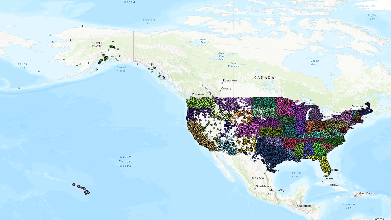

Here are 1 million addresses I geocoded from Snowflake and wrote back to Snowflake without the data touching the ground:

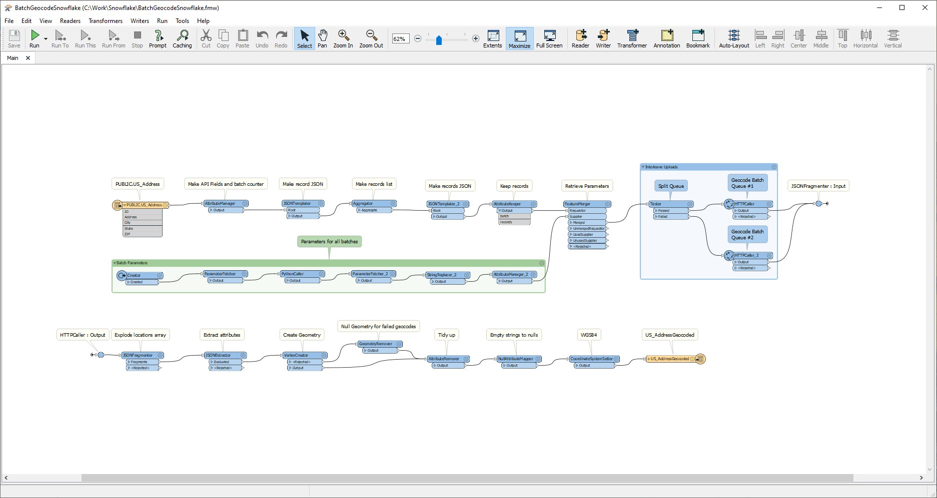

Here is how it looks when edited, and I always like this bit, you can't see any code because there isn't any! We're 21% through the 21st century, who writes code any more just to get work done? 😉

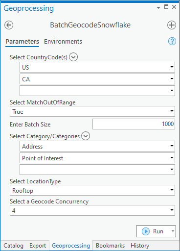

Lets go through the parameters of the ETL tool.
CountryCode is a hard filter for country. If your locator supports multiple countries like StreetMap North America does and your data is from known countries, customize and use this parameter. If you only have a single country locator don't supply a value.
MatchOutOfRange is a switch for finding addresses a small way beyond known house number ranges for street centerline matches.
The BatchSize should not be larger than the maximum allowed for your locator. You can see this number in the locator service properties. The blog download also has a handy Python script for reporting service properties, edit it for your URL.
Categories allow you to filter the acceptable match types, you could customize this parameter to support only certain types of Address matches for example.
LocationType lets you select rooftop or roadside coordinates for exact house point matches.
GeocodeConcurrency isn't a locator property, its a property of the batch handling of the ETL tool. My sample uses 4 - meaning at any time the service is handling 4 batch requests. Make sure to configure as many geocode service instances as you need and make this property agree. In my case I don't have serious metal to run on, I have a small virtual machine somewhere in the sky, but if you have a need for a 64-instance setup then go for it. At some point though you'll be limited by how fast you can read data, send it out and catch the results. My guess is few people will need more than 8 instances in a large geography.

That's pretty much it, surf the ETL tool for seeing how I made batch JSON and how to interpret the result JSON, and implement your own workflows. Enjoy!

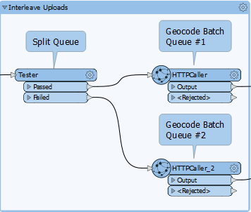

But wait there's more! I edited the tool 27th April 2021 to squeeze more performance (30%!) out of the already parallelized geocode step by managing the http calls in two queues. While one set of 4 batches is processing another set is uploading. This is the bookmark to look for.
