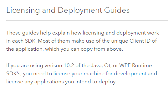

Second question has to do with licensing an applications and development machine.
When I login to my ESRI developer account, and click on an application I've registered and go to the Licensing tab, I see this message:
Are we really required to register our machine? This wasn't mentioned anywhere in the QT documentation. And when I click on the link mentioned in the image, it directs here:
Licensing Java, Qt, and WPF, ArcGIS Runtime SDKs 10.2 | ArcGIS for Developers
And almost ever single link on that page is broken. Also, doing searches on my machine, I can't find the Software Authorization Wizard, or License Viewer tool anywhere.
The only thing mentioned in the QT documentation is adding the ClientID and License to the AppInfo.h file.
