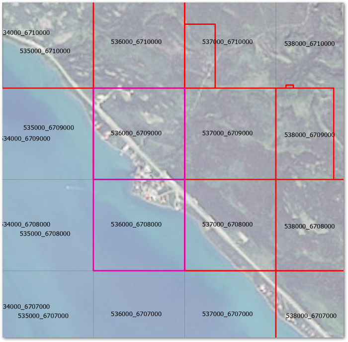

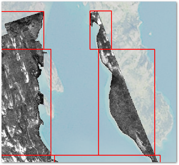

LASD says we have coverage in red and purple areas | However actual LAS point coverage is incomplete |

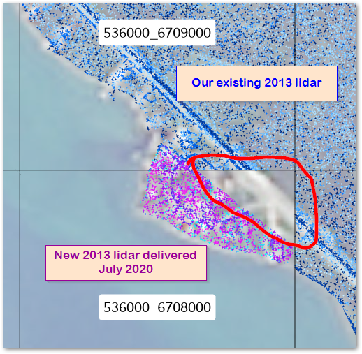

We ordered data to cover areas left out of the original purchase. When accepting the order we thought it was complete because the LASD showed it that way. It was only weeks later when trying to actually use it that we discovered there'd been a mistake in the Area of Interest. It would have been trivial to clear up that mistake with vendor at moment of delivery. However with the passage of time it is now a whole new purchase exercise.

Fig: LASD tile boundaries overlain on a point-stats raster. We quickly and effortlessly identify the data gaps without any extra work. No endless rounds of zooming closer and panning and refreshes.
