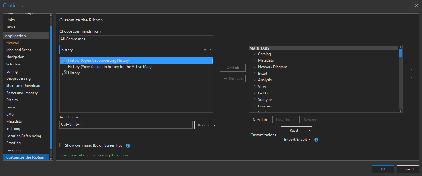

My current workflow is going to the history pane with my accelerator (Ctrl+ Shift + H) and then using the arrows to get to Project. Two issues that come up for me with this: 1) my history accelerator does not work if I am in the Contents pane and so I have to toggle to my map or open attribute table first, and 2) once in Project, I can't scroll down past Databases.
