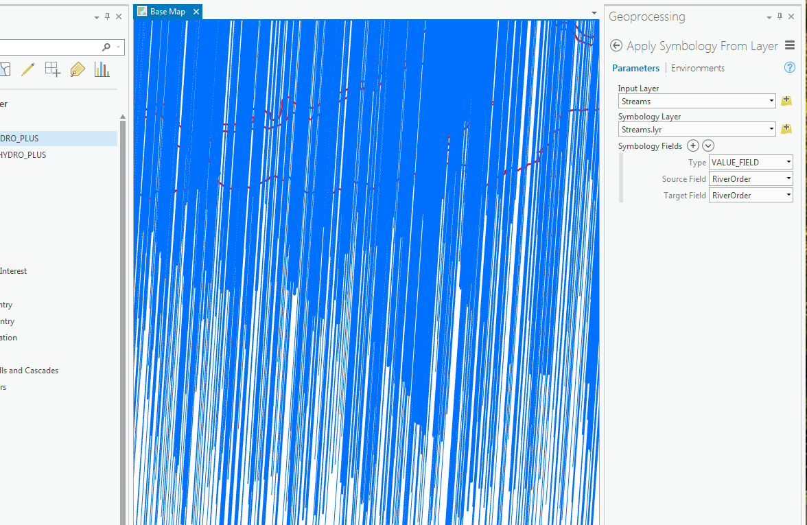

For example, this complex line layer, when added to Pro 1.3.1, looks like this:
I've tried deleting and re-configuring the symbology, same effect every time. Yes, latest video card driver is installed. This only happens on AGOL layers where "Optimize Layer Drawing" is enabled, if I pull this from the source (say a FGDB on a network share, same data), it doesn't happen.
