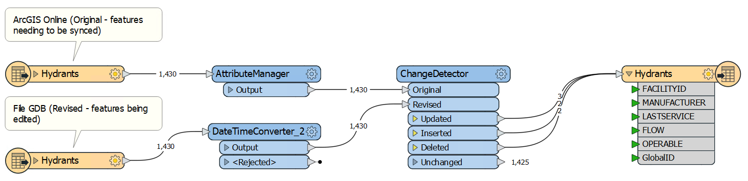

The Workspace is quite simple, and I will discuss the important aspects. There are two readers, three transformers, and one writer. The first reader connects to ArcGIS Online to read the hosted feature layer that I originally published from the file GDB, and the second reader connects to the file GDB (our authoritative dataset, and which will more commonly be residing in an Enterprise GDB or ArcSDE). The transformers are an AttributeManager, a DateTimeConverter, and a ChangeDetector. The ChangeDetector is straightforward, we instruct it to detect changes among attributes, geometry, or both.
Data Interoperability Sync Workspace (2 Readers, 3 Transformers, 1 Writer):
The DateTimeConverter formats the file GDB dates to be a compatible format because the original dates in the file GDB are being read without timestamps (“20080903” aka September 3, 2008), and the ArcGIS Online reader is formatting the data with timestamps (“20080903000000” aka September 3, 2008 @ 12 AM). The ChangeDetector treats these dates as different, so we use the DateTimeConverter to get the format correct (%Y%m%d%H%M%S shown as: 20080805000000 vs 20080805). Your dates and times may not need formatting, but if so, the DateTimeConverter is very useful – you can also add or subtract hours with the DateTimeCalculator if your times are in different zones (ex: UTC vs Central Time Zone).
The AttributeManager transformer is being used to change the ArcGIS Online GlobalID to UPPER case as it is being read in as lower case (“{@UpperCase(@Value(GlobalID))}”). Finally, we have an ArcGIS Online Writer which takes the output from the Updated, Inserted, and Deleted ports and uses this information to Add, Delete, or Update the corresponding features in ArcGIS Online. This Writer needs the GlobalID from the file GDB in order to process Updates and Deletes. There is a flag called "fme_db_operation", which the ChangeDetector sets to instruct the Online writer which operation to perform.
