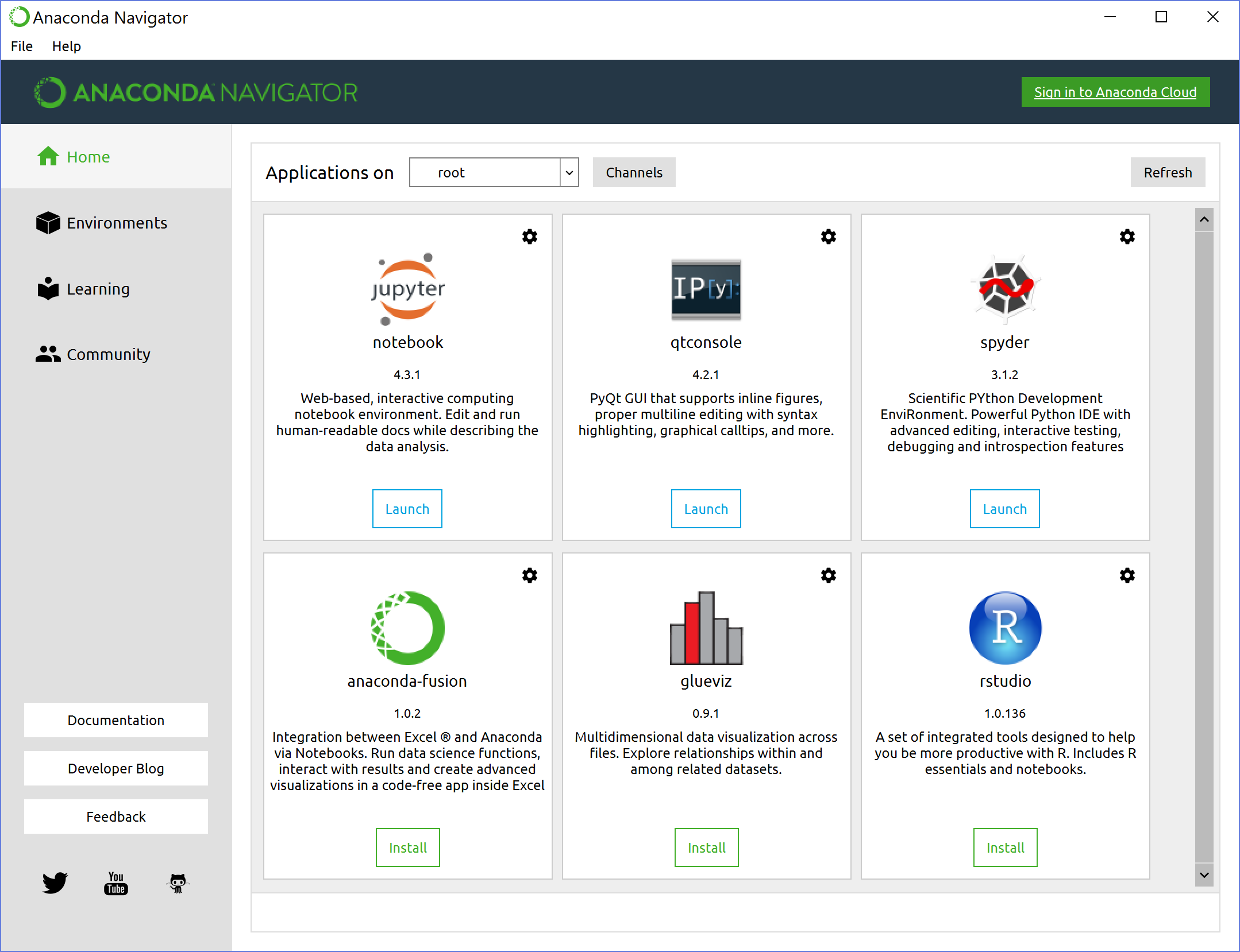

I have never used Arc*'s built in IDE. I am not sure why they include it, except for the fact that they can control its installation and no one needs to worry about problems associated with a separate IDE. I installed spyder, Jupyter Qt-console and PythonWin. Spyder and Jupyter are included in the Anaconda distribution that esri provides. If you don't use one now, then install spyder.

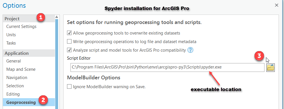

2. Setting your default editor
If you want to use another one, go to the Project pane, the Geoprocessing Options and do some setup. Spyder is located in a somewhat cryptic folder path, which I have show in navigation mode and in step 2. as a visual with cutouts for the fiddle bits. In reality, the portion of the path C:\Program Files\ArcGIS\Pro is the default installation path and the one most likely to be offered during installation and for multi-user machines. I personally install mine where I know what it is in the folder.... C:\ArcPro.

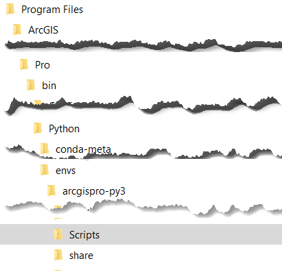

3. The file path to locate the executable
I assume a default path installation in the following. Everything prior to the ...\bin folder is specific to your machine install path.

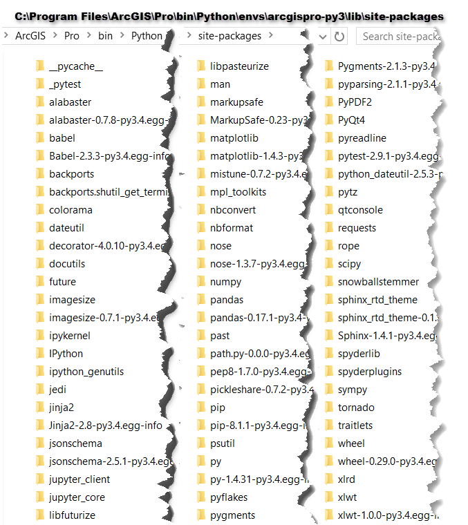

4. The site-package folder
What is included without by default from an ArcGIS Pro installation... this is not a complete list of available packages... the list of those, is given above in the table. The packages come by python version. We are currently using python 3.4.x in ArcGIS PRO and ArcMap

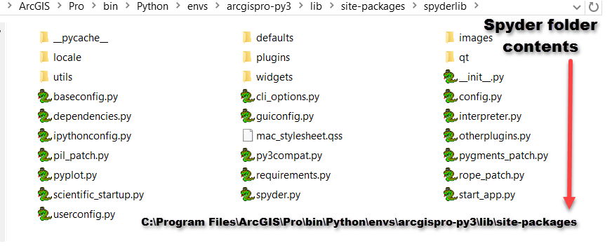

5. The Spyder folder contents
What is in the spyder folder... scientific_startup does some standard imports for what-it-says-type work

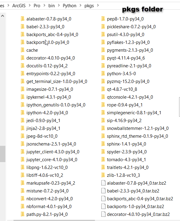

6. The pkgs folder
A record of the packages that were installed.

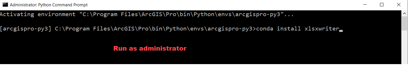

7. Importing packages... xlsxwriter demo
Here is the workflow I used to import the xlsxwriter module for use in python and arcmap (presumably).

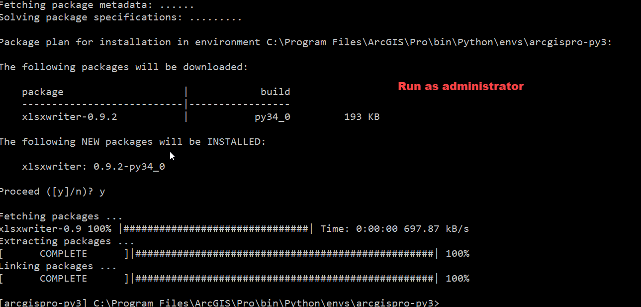

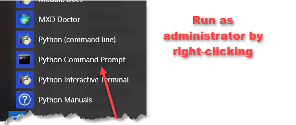

From the start button (windows 10, bottom left) navigate to the ArcGIS folder via All Apps find the Python Command Prompt and right-click on it and Run as Administrator
Do the conda install xlswriter entry as suggested in the originating post.
Hit Enter and away you go. The magic happens and it should be installed.

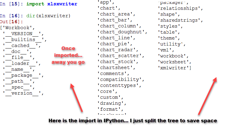

At this stage, I went back to Spyder and from the IPython console I tested... looks good
