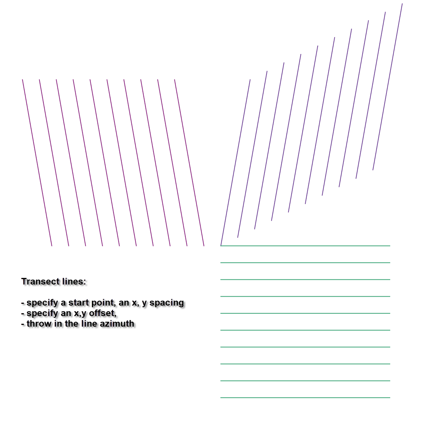

Different incarnations and names
Pretty easy to form the origin-destination pairs.
Start at a point.
Throw in horizontal and/or vertical offsets.
A dash of an azimuth/bearing.
A tad of NumPy
A bit of Arcpy and....
A good way to spend some time, so you write it down because you will forget and reinvent it later.
Almost forgot...
There is always one student that thinks outside the box.
Hmmmm could be a bonus here... I wonder if any of mine can replicate the compass with 10 degree increments?
