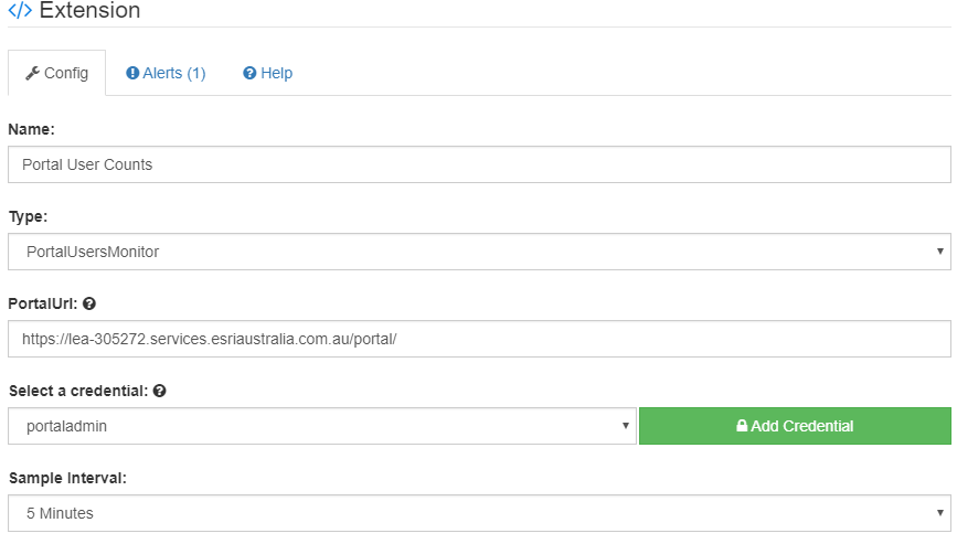

First of all we have module.exports.inputs which is a JavaScript object defining the information we expect the user to provide when configuring a counter using our extension. This will shape the UI presented ot the user when configuring a counter using your extension. Each individual input is an object that needs to have at least a 'type' property, and can optionally have a 'value' and 'help' property. The type property will determine the UI control presented to the user in which to provide their input. The value property provides allows a default value to be set within the UI control presented to the user. And the 'help' property allows us to provide context sensitive help to the user, explaining what information they are expected to provide for each input.
As an example, I created an extension for ArcGIS Monitor that checks how many creator and view user type licenses are available in a 10.7.x/10.8.x Portal. The use-case for such an extensions would be to allow for an alert to be raised when we're starting to run out of either Creator or Viewer usertypes, so you as an administrator go look at freeing up inactive users or authorise additional licenses.
For our extension to interact with the Portal, it's going to need two key pieces of information:
- The URL of the Portal; and
- Credentials to facilitate authenticated access to the Portal

<SPAN class="punctuation token">}</SPAN><SPAN class="punctuation token">;</SPAN><SPAN class="line-numbers-rows"><SPAN></SPAN><SPAN></SPAN><SPAN></SPAN><SPAN></SPAN><SPAN></SPAN><SPAN></SPAN><SPAN></SPAN><SPAN></SPAN><SPAN></SPAN><SPAN></SPAN><SPAN></SPAN><SPAN></SPAN><SPAN></SPAN><SPAN></SPAN><SPAN></SPAN><SPAN></SPAN></SPAN>When loaded by ArcGIS Monitor this code will provide a field in which the user can enter a string of text specifying the Portal URL to connect to, along with the ability to add and/or select credentials saved with ArcGIS Monitor Administrator to for the purpose of authenticating with the Portal. The third input here 'min_resolution' is the minimum allowable sampling interval in seconds, which controls what options will be available to the user in the Sample Interval dropdown.
