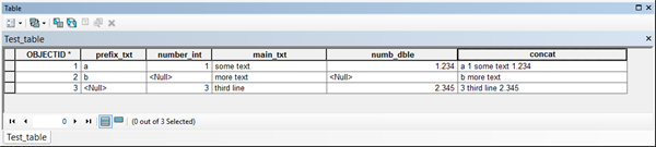

As an example, consider the task of concatenating data to a new field from several fields which may contain nulls (eg. see this thread... Re: Concatenating Strings with Field Calculator and Python - dealing with NULLS). There are numerous ways to accomplish this, several will be presented here.
List comprehensions, truth testing and string concatenation can be accomplished in one foul swoop...IF you are careful.
This table was created in a geodatabase which allows nulls to be created in a field. Fortunately, <null> stands out from the other entries serving as an indicator that they need to be dealt with. It is a fairly simple table, just containing a few numeric and text columns.

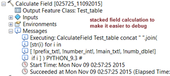

The concat field was created using the python parser and the following field calculator syntax.
Conventional list comprehension in the field calculator
<SPAN class="comment token"># read very carefully ...convert these fields if the fields don't contain a <Null></SPAN>
<SPAN class="string token">" "</SPAN><SPAN class="punctuation token">.</SPAN>join<SPAN class="punctuation token">(</SPAN> <SPAN class="punctuation token">[</SPAN> str<SPAN class="punctuation token">(</SPAN>i<SPAN class="punctuation token">)</SPAN> <SPAN class="keyword token">for</SPAN> i <SPAN class="keyword token">in</SPAN> <SPAN class="punctuation token">[</SPAN> !prefix_txt!<SPAN class="punctuation token">,</SPAN> !number_int!<SPAN class="punctuation token">,</SPAN> !main_txt!<SPAN class="punctuation token">,</SPAN> !numb_dble! <SPAN class="punctuation token">]</SPAN> <SPAN class="keyword token">if</SPAN> i <SPAN class="punctuation token">]</SPAN> <SPAN class="punctuation token">)</SPAN>
<SPAN class="string token">'12345 some text more'</SPAN>
<SPAN class="line-numbers-rows"><SPAN></SPAN><SPAN></SPAN><SPAN></SPAN></SPAN>
and who said the expression has to be on one line?
<SPAN class="punctuation token">[</SPAN>str<SPAN class="punctuation token">(</SPAN>i<SPAN class="punctuation token">)</SPAN> <SPAN class="keyword token">for</SPAN> i <SPAN class="keyword token">in</SPAN>
<SPAN class="punctuation token">[</SPAN> !prefix_txt!<SPAN class="punctuation token">,</SPAN> !number_int!<SPAN class="punctuation token">,</SPAN> !main_txt!<SPAN class="punctuation token">,</SPAN> !numb_dble!<SPAN class="punctuation token">]</SPAN>
<SPAN class="line-numbers-rows"><SPAN></SPAN><SPAN></SPAN><SPAN></SPAN><SPAN></SPAN></SPAN>
