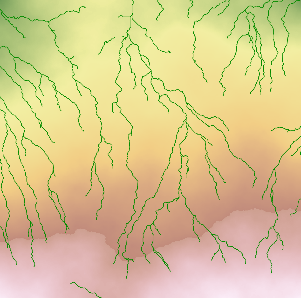

Of course, the image that follows uses a much larger array (1025x1025). The generated array, was sink-less, and flow properties and a stream network was generated from the result. Pretty smooth eh?
