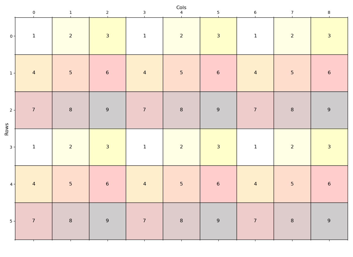

Let's begin with a raster constructed from 3x3 windows with a repeating pattern and repeats of the pattern.
You can construct your own rasters using numpy, then apply a NumPyArrayToRaster to it. I have covered this before, but here is the code to produce the raster

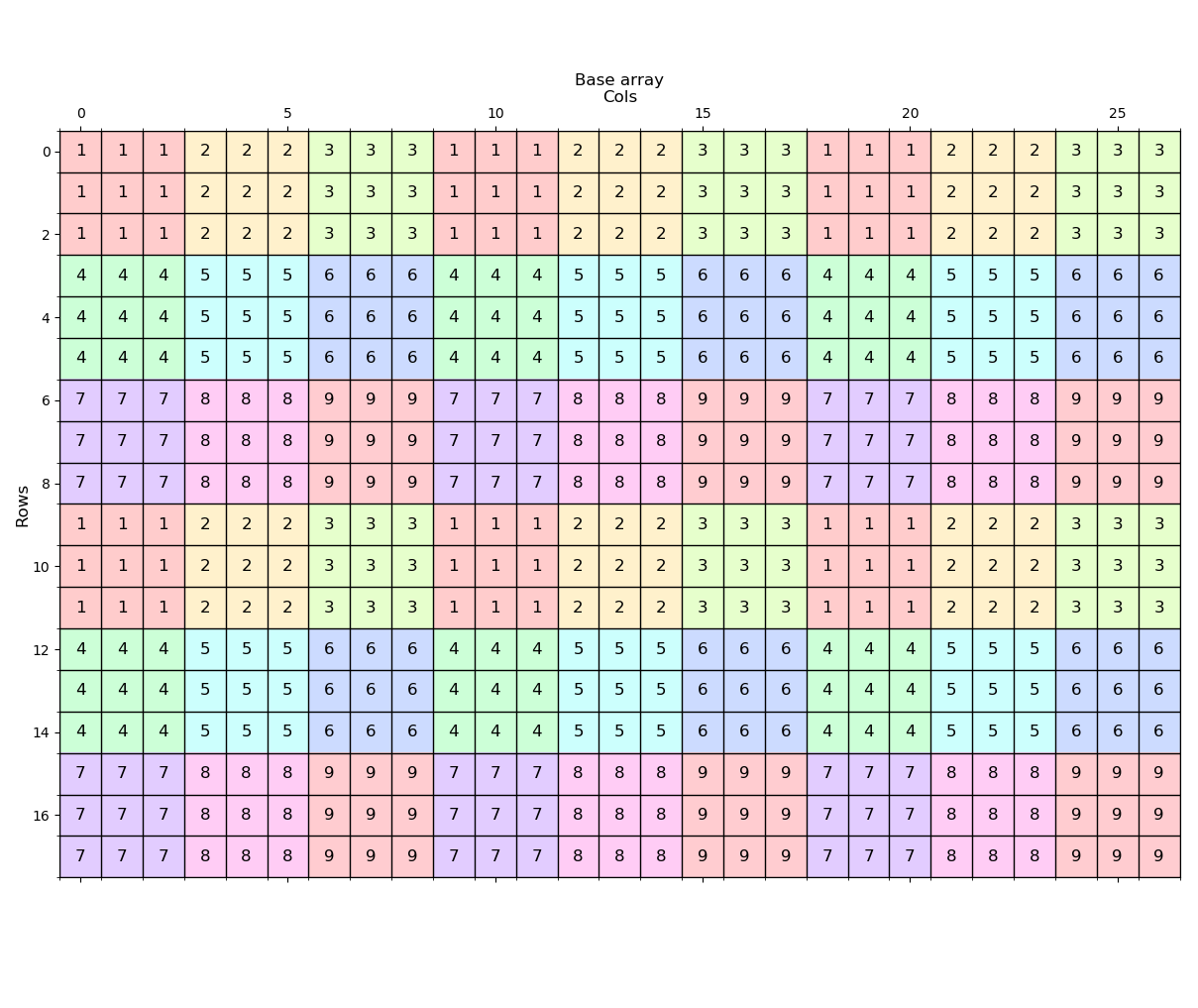

---- The raster (image) ----

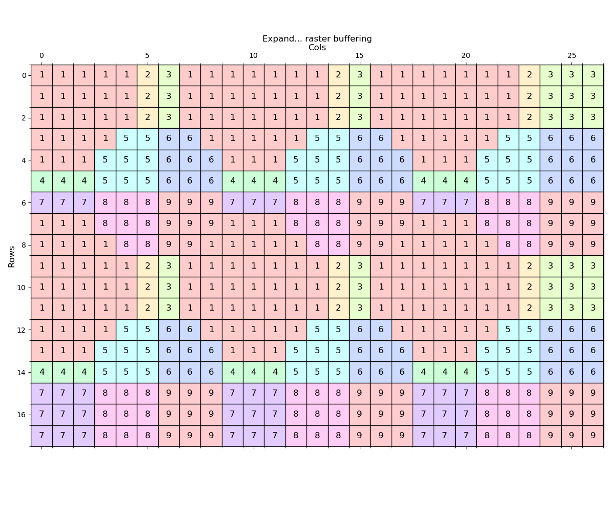

---- (1) Expand ----
Expand the zone 1 values by 2 distance units

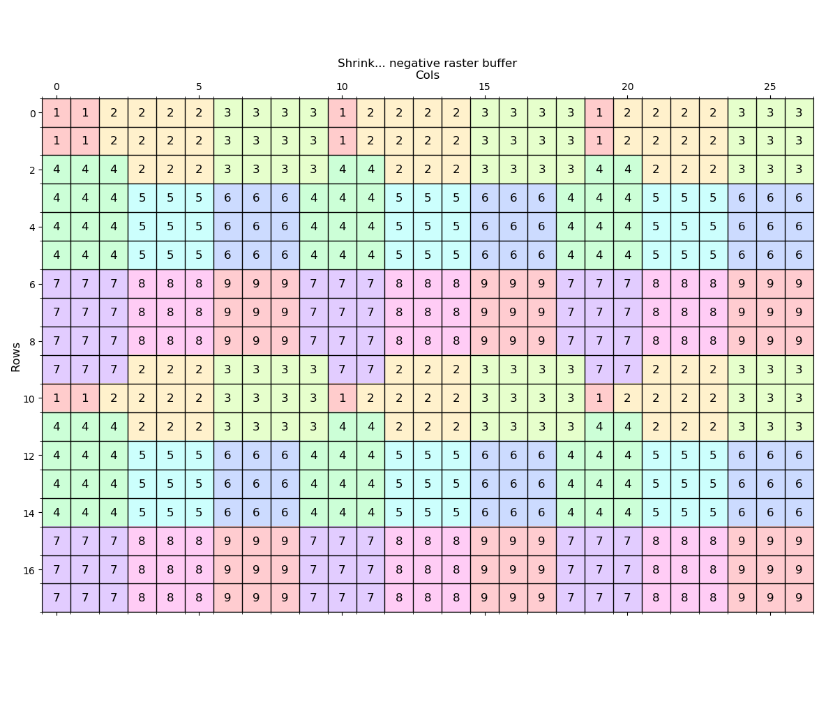

---- (2) Shrink ----
Shrink the zone 1 values by 1 distance unit.

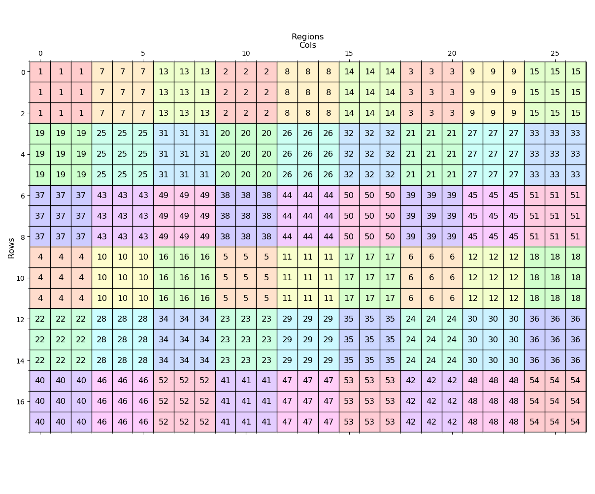

---- (3) Regiongroup ----
Produce unique regions from the zones. observe that the zone 1 values in the original are given unique values first. Since there were 6 zone 1s, they are numbered from 1 to 6. Zone 2 gets numbered from 7 to 12. and that pattern of renumbering repeats.
