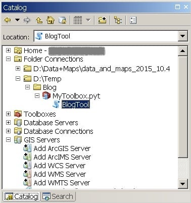

For example, lets say we have this trivial toolbox:

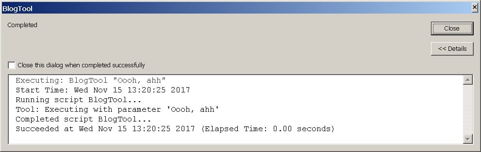

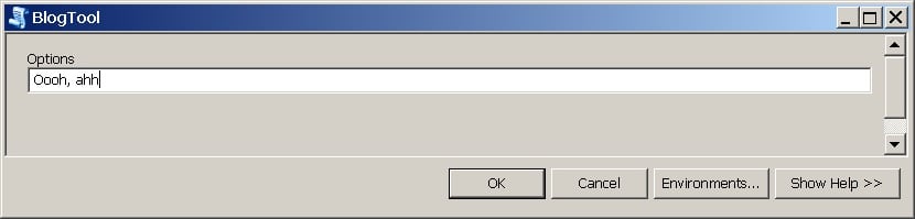

It works like you'd expect:

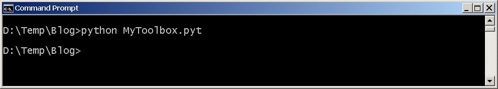

Now, if you run it from the command line, despite it not having a .py suffix, you get no error, but it doesn't do anything either:

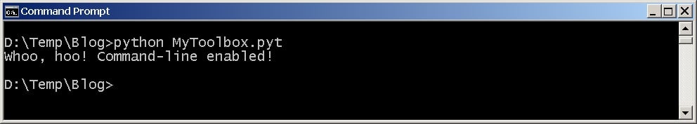

Ahh, but if you tweak the toolbox to add an extra two lines of code to the end:
<SPAN class="keyword token">if</SPAN> <SPAN class="punctuation token">(</SPAN>__name__ <SPAN class="operator token">==</SPAN> <SPAN class="string token">'__main__'</SPAN><SPAN class="punctuation token">)</SPAN><SPAN class="punctuation token">:</SPAN>
arcpy<SPAN class="punctuation token">.</SPAN>AddMessage<SPAN class="punctuation token">(</SPAN><SPAN class="string token">"Whoo, hoo! Command-line enabled!"</SPAN><SPAN class="punctuation token">)</SPAN>
Then you can use the toolbox from a console:

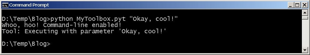

"Still, they're not connected, and what about messaging?" you ask. Well, this is pretty cool: You can fake the messages parameter in the tool's execute method with a stub class that does everything you need messages to do, and you can grab parameters from the sys.argv array, which makes for a command-line capable toolbox:
<SPAN class="keyword token">class</SPAN> <SPAN class="token class-name">msgStub</SPAN><SPAN class="punctuation token">:</SPAN>
<SPAN class="keyword token">def</SPAN> <SPAN class="token function">addMessage</SPAN><SPAN class="punctuation token">(</SPAN>self<SPAN class="punctuation token">,</SPAN>text<SPAN class="punctuation token">)</SPAN><SPAN class="punctuation token">:</SPAN>
arcpy<SPAN class="punctuation token">.</SPAN>AddMessage<SPAN class="punctuation token">(</SPAN>text<SPAN class="punctuation token">)</SPAN>
<SPAN class="keyword token">def</SPAN> <SPAN class="token function">addErrorMessage</SPAN><SPAN class="punctuation token">(</SPAN>self<SPAN class="punctuation token">,</SPAN>text<SPAN class="punctuation token">)</SPAN><SPAN class="punctuation token">:</SPAN>
arcpy<SPAN class="punctuation token">.</SPAN>AddErrorMessage<SPAN class="punctuation token">(</SPAN>text<SPAN class="punctuation token">)</SPAN>
<SPAN class="keyword token">def</SPAN> <SPAN class="token function">addWarningMessage</SPAN><SPAN class="punctuation token">(</SPAN>self<SPAN class="punctuation token">,</SPAN>text<SPAN class="punctuation token">)</SPAN><SPAN class="punctuation token">:</SPAN>
arcpy<SPAN class="punctuation token">.</SPAN>AddWarningMessage<SPAN class="punctuation token">(</SPAN>text<SPAN class="punctuation token">)</SPAN>
<SPAN class="keyword token">import</SPAN> sys
doExecute<SPAN class="punctuation token">(</SPAN>str<SPAN class="punctuation token">(</SPAN>sys<SPAN class="punctuation token">.</SPAN>argv<SPAN class="punctuation token">[</SPAN><SPAN class="number token">1</SPAN><SPAN class="punctuation token">]</SPAN><SPAN class="punctuation token">)</SPAN><SPAN class="punctuation token">,</SPAN>msgStub<SPAN class="punctuation token">(</SPAN><SPAN class="punctuation token">)</SPAN><SPAN class="punctuation token">)</SPAN>
