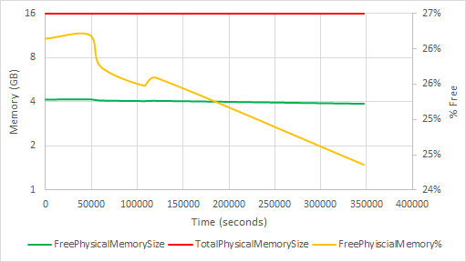

The GeoEvent Service system-info using the system-info input to generate a system-info-in event every 60 seconds. These events are written directly to an output that writes the events to a csv file in the GeoEvent Backup folder.
By default this folder (on Windows) is located:
C:\ProgramData\Esri\GeoEvent\systeminfo\
These csv files will record the status of your server over time and can be easily manipulated in Excel to create graphs of the historical system resources.
