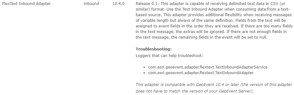

Flexible CSV Adapter
To get around this issue I updated the OOTB inbound Text Adapter to be a bit more flexible. For each CSV message, it will attempt to put each field into the provided GeoEvent definition. If there aren't enough fields in the CSV message to fill the GeoEvent, the remaining fields in the event will have their values set to NULL. If there are too many fields in the CSV message, the extra fields in the CSV message will be ignored (like if you only wanted the first 5 values in the above example messages).

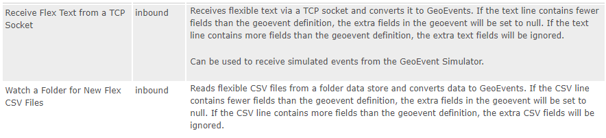

Connectors

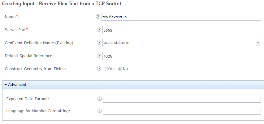

Adding the .jar file to GeoEvent Server will create two inbound connectors for you. You can create additional connectors utilizing different transports if needed.
