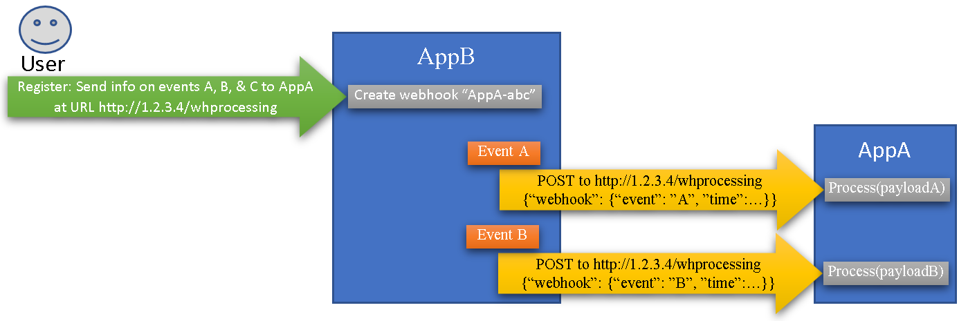

Webhooks allow you to register your "payload processor" application [AppA] with another application [AppB]. During the registration process, you tell AppB to send webhook payloads to AppA at a specific URL. When AppB has some sort of trigger event that it needs to send to AppA, it creates a payload with information about that event (typically in JSON format) and sends that payload to AppA via HTTP to the URL registered above (typically a POST).
In ArcGIS for Enterprise there are a number of webhooks you can register for including item creation/deletion, sharing events, and group events. More information on creating a webhook and what kind of trigger events you can register a webhook for can be found in the Enterprise documentation.

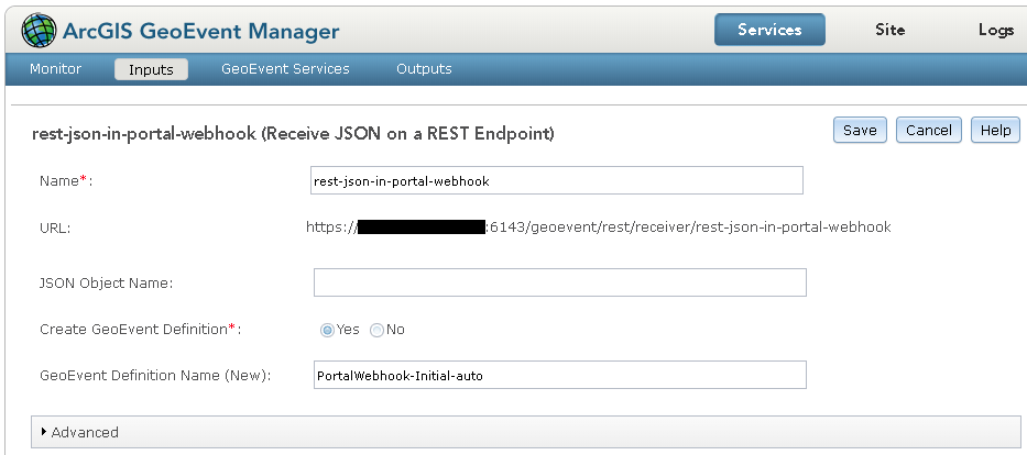

- In GeoEvent Manager, navigate to Services > Inputs and press the Add Input button.

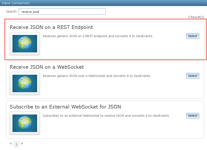

- Search for "Receive JSON” and select Receive JSON on a REST Endpoint.

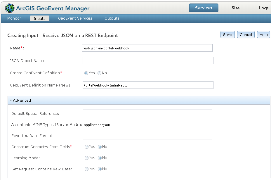

- On the Creating Input – Receive JSON on a REST Endpoint page, modify the properties as needed and press the Save button.
- Name: [Unique name of this webhook listener]
- JSON Object Name: [The payload json object name you are looking to monitor; leave empty if you don't know]*
- Create GeoEvent Definition: Yes**
- GeoEvent Definition Name (New): [MyWebhookName-auto]***
- Advanced:
- Acceptable MIME Types (Server Mode): application/json
- Learning Mode: No****

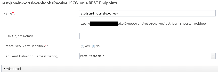

- After you save the input, re-open it. It now will display a URL parameter. This URL parameter is the “Payload URL” that the Webhook will need for it to POST data to.
- Copy that URL property value and save it.

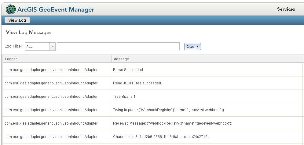

- Back on your GeoEvent Manager > Logs page you should notice some log messages indicating the webhook properly registered:
- On your input, if you told GeoEvent to create the GeoEvent Definition for you and you set Learning Mode to No then you will need to delete the event it created because the schema for the webhook registration is not going to be correct.
- Navigate to GeoEvent > Site > GeoEvent > GeoEvent Definitions and delete the definition your webhook input created.

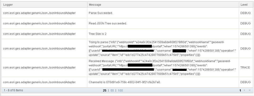

- After you press the Done button, go back to GeoEvent Manager > Logs and verify the Create Item webhook was received.
NOTE: Don't forget to reset the Log Level to WARN for the logger com.esri.ges.adapter.genericJson.JsonInboundAdapter after you are done testing.

* JSON Object Name
Usually you don't know what kind of data to expect and just need to receive some data before deciding how to parse it. In that case I usually leave the JSON Object Name empty and let GeoEvent try to parse the entire JSON message. Once you know what the data schema looks like, you can come back and modify this property to target the specific section of JSON you want to turn into events.
Also note that you may end up identifying one or more sections of the incoming JSON you want to parse into separate/different events. In that case I would create a second GeoEvent Input and register a second webhook to have data sent to it.
** Create GeoEvent Definition
Once you receive some data and GeoEvent has helped you determine the schema, you can lock down that schema so it doesn't change and the GeoEvent definition is not transient.
When you have the Create GeoEvent Definition set to Yes, the definition it creates is transient and owned by the input. This means the event can change or even disappear if the input is stopped. Those are things we don't want to happen without us. To get around this:
- After the definition is created by the input, make a copy of it.
- Name the copy something like "MyWebhookName-in" (take the auto off)
- Back in your input, change Create GeoEvent Definition to No and select the new definition you just created.
