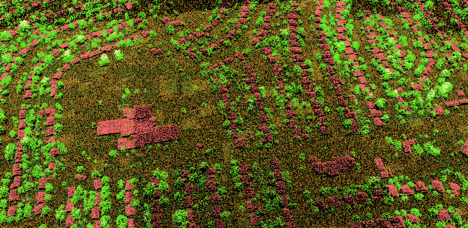

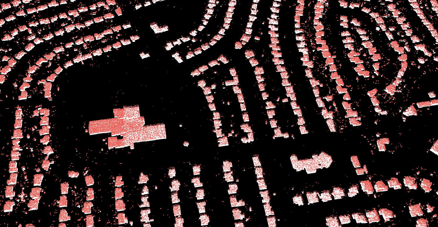

Using ArcGIS Pro ensure that your Buildings are Classified in your LiDAR .las or .zlas files.
- You can visually assess Building Classification in the LiDAR Classification as Class Code 6

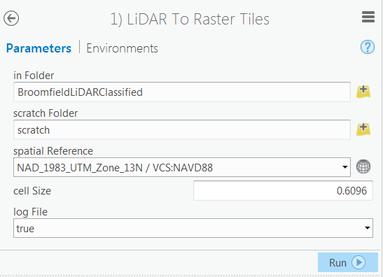

Run the LiDAR to Raster Tiles GP tool in the "Attached" BuildingFootprintXtract toolbox:
** The cell-Size will depend on the LiDAR Point Spacing. I typically run 2ft or 0.6096 meters here.**

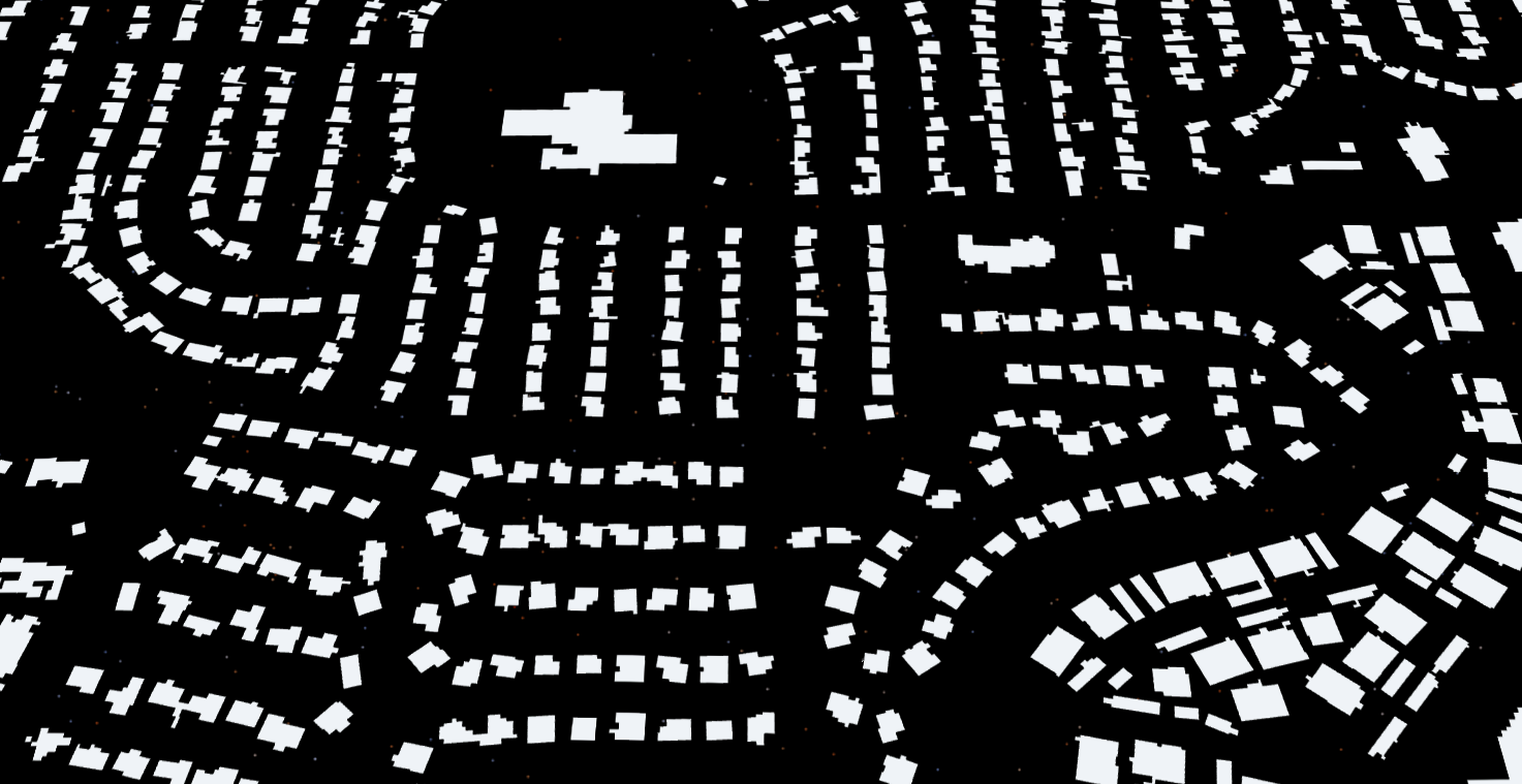

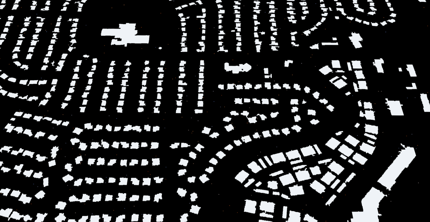

Run the Extract Footprints Polygons tool in the "Attached" BuildingFootprintXtract toolbox:
** Note the small artifacts that may exist where points were miss-classified in the LiDAR as buildings.**

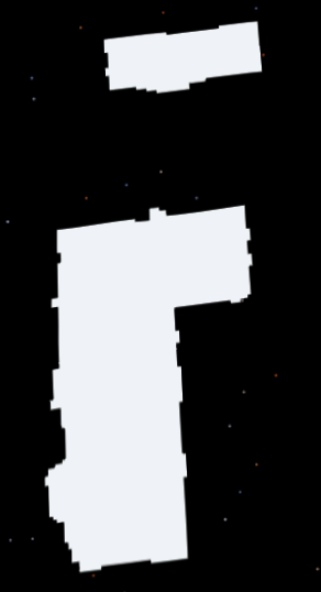

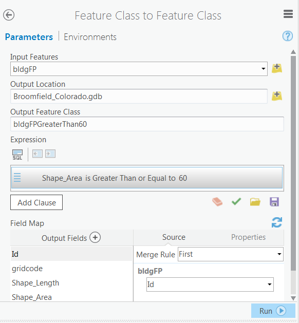

Run the Eliminate Polygon Part GP tool:
** I typically remove features smaller than 60sq meters or 645 feet.. **
In Some Cases Holes will exist in the middle of features where LiDAR point-clouds were either miss-classified or were non-existent.
To remove these holes run the "Eliminate Polgon Part" GP tool

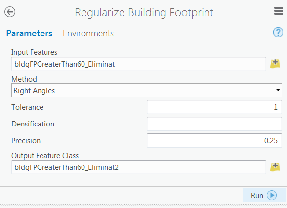

Footprint Regularization.
For further refinement of the extracted buildings please refer to Arthur Crawford's blog post concerning increased accuracy regularization of the extracted footprints:
https://community.esri.com/people/acrawford-esristaff/blog/2016/12/22/arthurs-feature-extraction-from-lidar-dems-and-imagery
