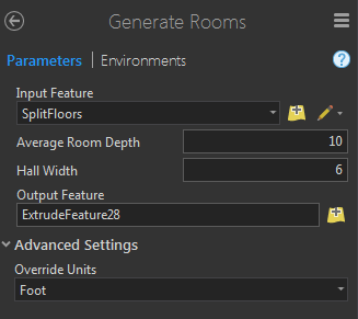

1.) Generate Rooms GP tool:
This tool leverages an a CityEngine .rpk file for rapidly creating fake rooms.

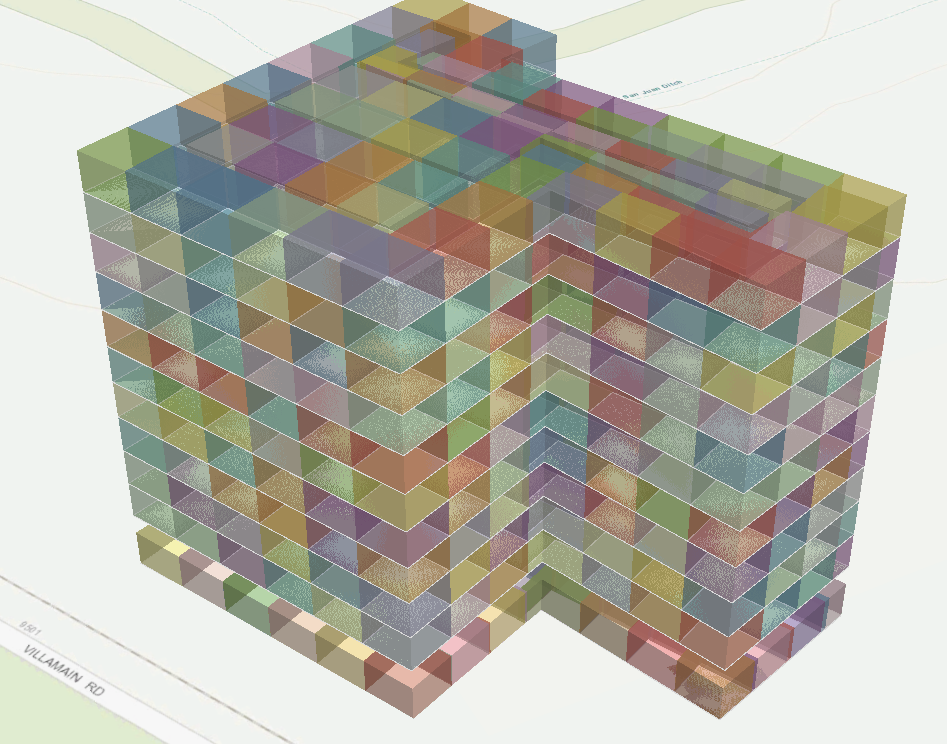

You can then use the included "Extrude" GP tool to extrude the volumes:

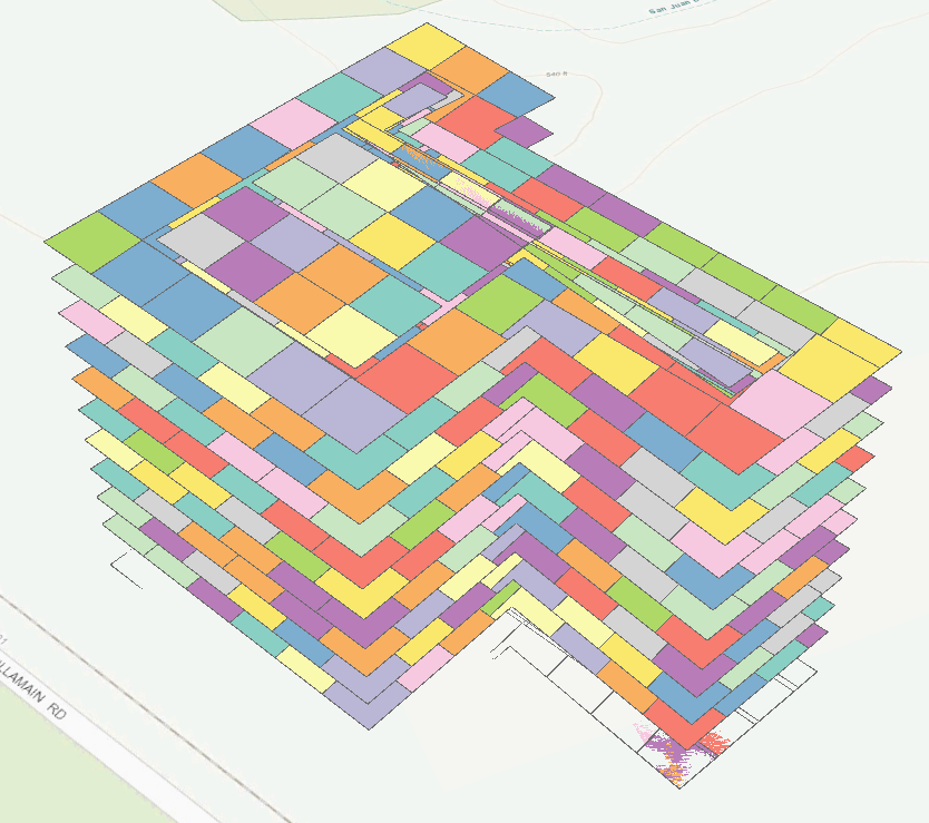

I have also included a tool for randomly attributing the Rooms, Floors, etc... with Data such as Owner and Value.
The results of this attribution are shown above.
The python file and Demo-Attributor tool are meant to serve as an example for random application of values to features in ArcGIS Pro.
