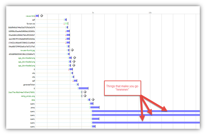

The Statistics and Timeline tabs are both helpful when investigating any performance related issue, for example if a service is taking a long time to load in the Map Viewer. The Timeline tab is useful for identifying which request in a multi-request process is acting as a bottleneck. To utilize the Timeline tab, select multiple requests in the Web Sessions list. The timeline will display the requests in a sequential “cascade” format. Any requests taking an unusually long time will clearly stand out with a significantly longer bar in the timeline.
Statistics displays the exact times every step of the request took, from the client initially making a connection to the last step of the client receiving the response. This breakdown is useful to potentially identifying which step in the process of a single request is acting as a bottleneck. For example, if every step is taking a fraction of a second, but there is a multi-second pause between ServerGotRequest and ServerBeginResponse that would indicate that something on the server side is causing a slowdown.

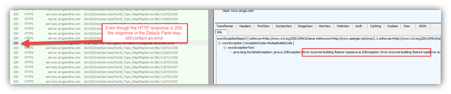

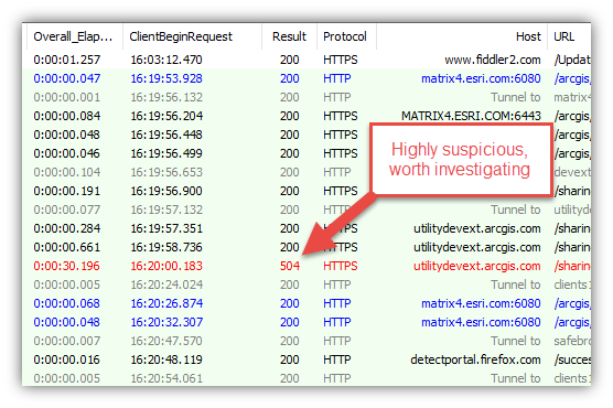

- Check the HTTP/HTTPS response code in the Web Sessions pane. Anything that isn’t 200 should be investigated (it might not necessarily be a problem, but it’s worth looking at). Again, here’s a description of what these mean. Even a 200 response could contain error messages or other useful information.
- A 304 response from a server will trigger the client (web browser, ArcMap, etc) to use the client’s cache and Fiddler is therefore not actually capturing a complete response from the server. If there is a 304 response on a critically important request, try again either in Incognito mode or clear your client’s cache.
- A 401 or 403 response typically mean the server requires some sort of authentication. This would help, for example, identify an unshared feature service in a web map which is shared publicly.
- A 504 response typically means something timed out. Use this in conjunction with the Timeline, Statistics and Overall Elapsed column mentioned above to troubleshoot performance issues.
