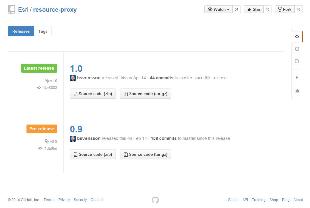

- Navigate to https://github.com/Esri/resource-proxy/releases to obtain the most recent release of the proxy.
- Click 'Source code(zip)' to download the .zip file to your local drive.
Download a proxy from GitHub.

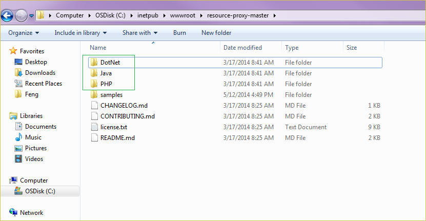

- Extract the files to your server (in this case, IIS Server), and navigate to the resource proxy folder, 'C:\\inetpub\wwwroot\resource-proxy-master', where you extracted the files. There are three sub-folders inside, each containing a proxy for the respective server type:
- DotNet - Internet Information Services (IIS) server
- Java - Apache Tomcat server
- PHP - Apache server
- Folders under resource-proxy-master

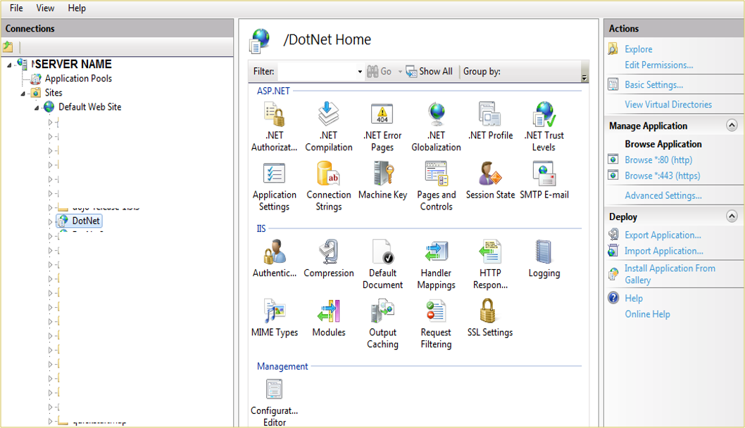

- Click Start. In the ‘search for programs and files’ box, type IIS, and open the IIS Manager.
- Expand the server name, the Sites folder, and Default Web Site.
Internet Information Services (IIS) Manager

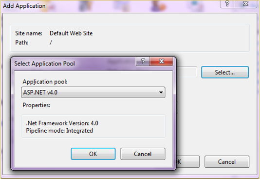

- Right-click the DotNet folder in the directory, and select Convert to Application.
Convert proxy to an application
- Ensure the application pool is 4.0 or greater. In this example, we use ASP.NET v4.0. Ensure the folder icon is a globe.

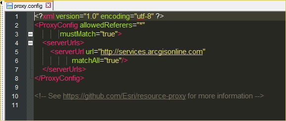

- Inside the proxy.config file, you see the following in XML format:
proxy configuration file

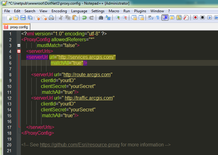

We recommend keeping the global mustMatch="true". When this is true, all requests made to the proxy can only go through specified serverUrls.
For testing purposes, you can change the global mustMatch="false"; this allows any proxy requests to pass through. - Since the direction's sample uses http://route.arcgis.com and http://traffic.arcgis.com, we add two <serverUrl> tags.
Note: When using ArcGIS Online services the recommended workflow is to use a client id and client secret. The client id and client secret are obtained from developers.arcgis.com. If secured services from ArcGIS for Server used, then we would input a username and password. For this example, we use services from ArcGIS Online serverUrls.

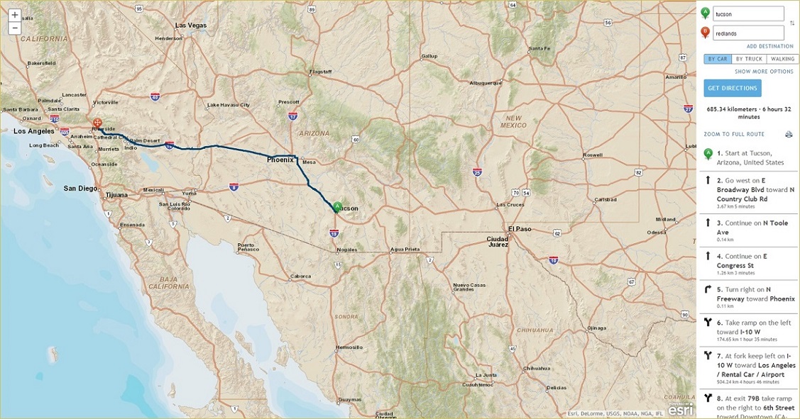

- Run the hosted application, and open the Developer tools.
- Type in an origin and destination. Our journey ends with step by step directions accompanied by a map visual.
Get Directions
Happy travels!
