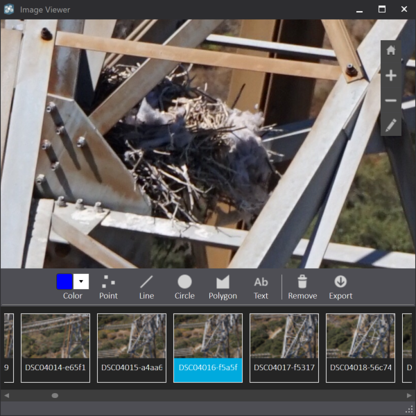

The first flight that we conducted was a free flight, to capture some of the detail on the transmission tower. We wanted to see how a drone could be used to get more detail than conducting a ground based visual inspection.
One of the cool things about Drone2Map, is the ability to use it as a field application. After landing the drone, we pulled out the SD card and started a new 'Inspection' project in Drone2Map.
Drone2Map takes a few minutes to pull in all of the imagery, builds out the flights lines, and places all of this over the World Imagery Service provided by Esri. There is also an inspection viewer that opens up to let users see the detail in their photos.
Includes the ability to create mark-up on the photos
From the ground, it would have been impossible to discern whether there were any occupants in the couple of nests that were located on the tower. Using Drone2Map in the field would have been a great way to capture avian protection information.

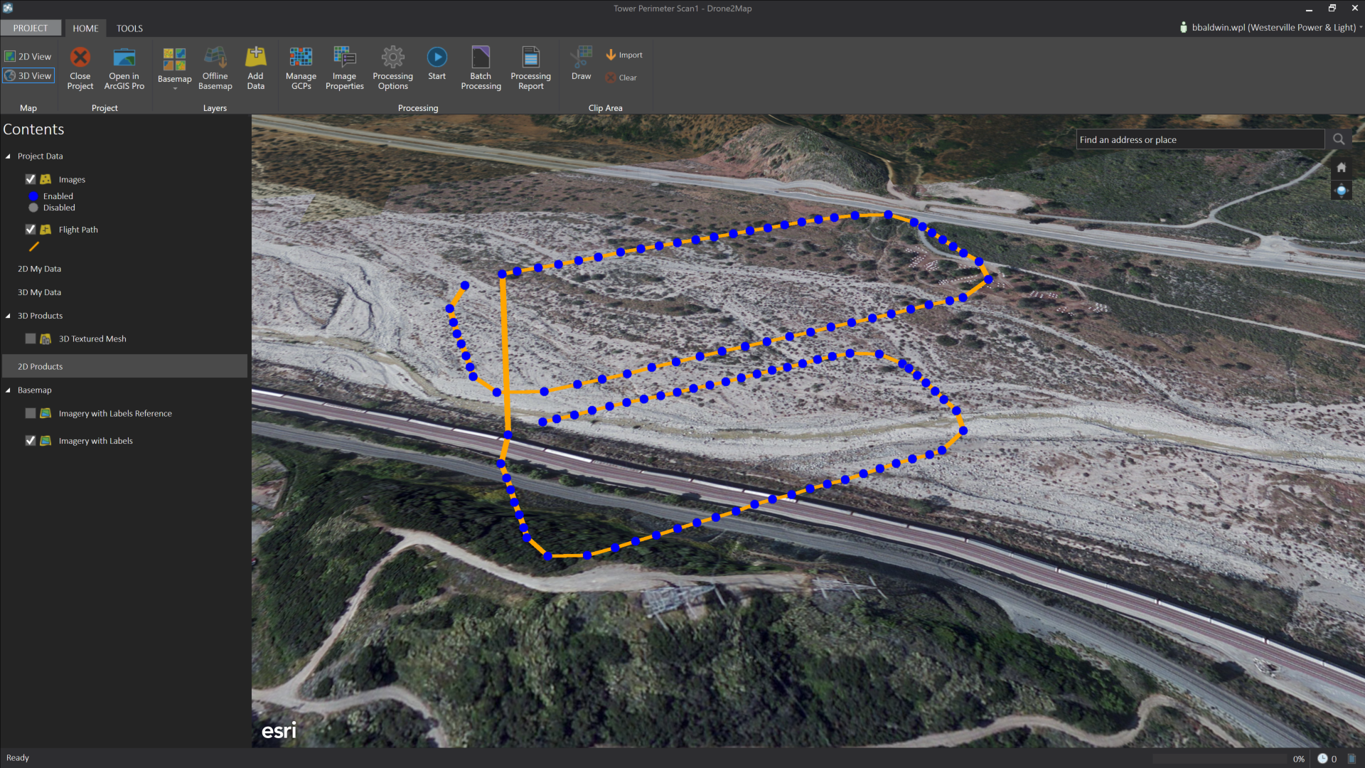

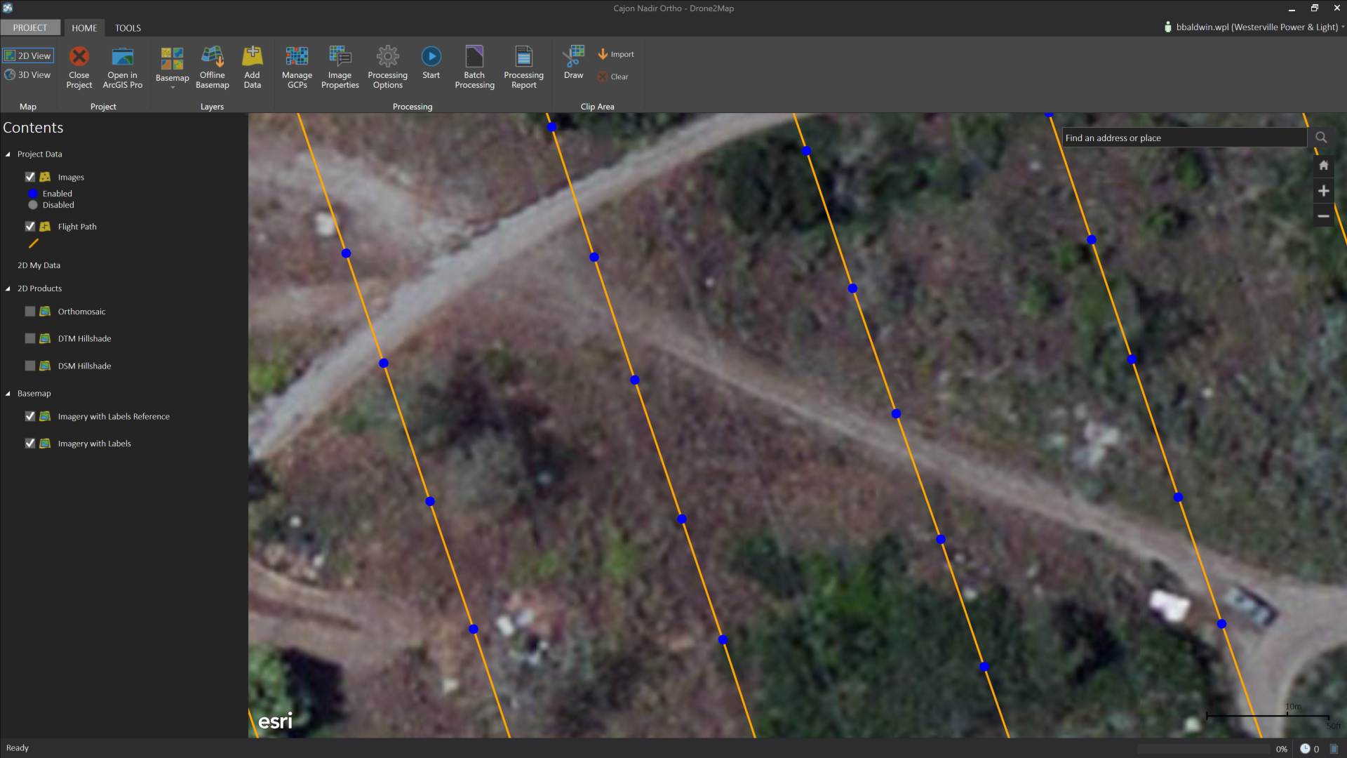

The next flight we conducted, was a grid. We wanted to capture photos shooting straight down at the ground, while flying over the conductor and towers. This would help us build out orthomosaics and some 3D datasets. Drone2Map provides a couple different options for how a user can build out their imagery and also provides a rapid setting so that you can see how your coverage looks while in the field. Rather then running the rapid mode, we ended up processing our imagery back in the office, so that I could build out all of the output options (DTM, DSM, and imagery).
Flight paths, with ArcGIS Online World Imagery

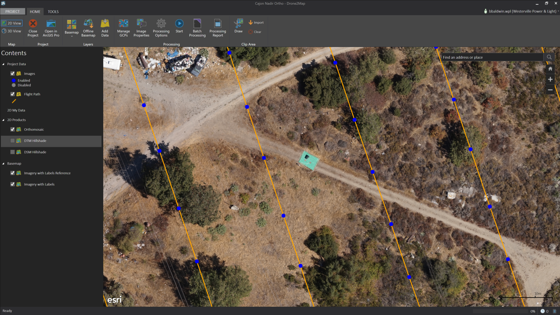

Flight paths with an orthomosaic processed in Drone2Map
While Drone2Map stitches together the images to build orthomosaics, it also builds a point cloud from the imagery, which is used to create the DSM and DTM. While the point cloud is not displayed in Drone2Map, users can take that LAS output and bring it into other applications (ArcGIS Pro).

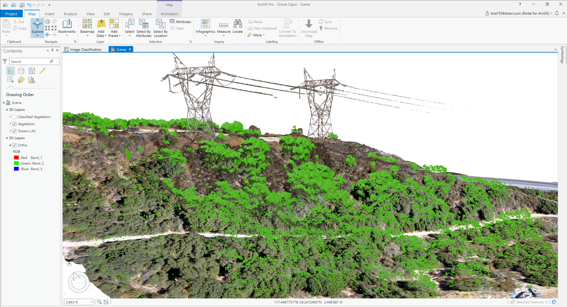

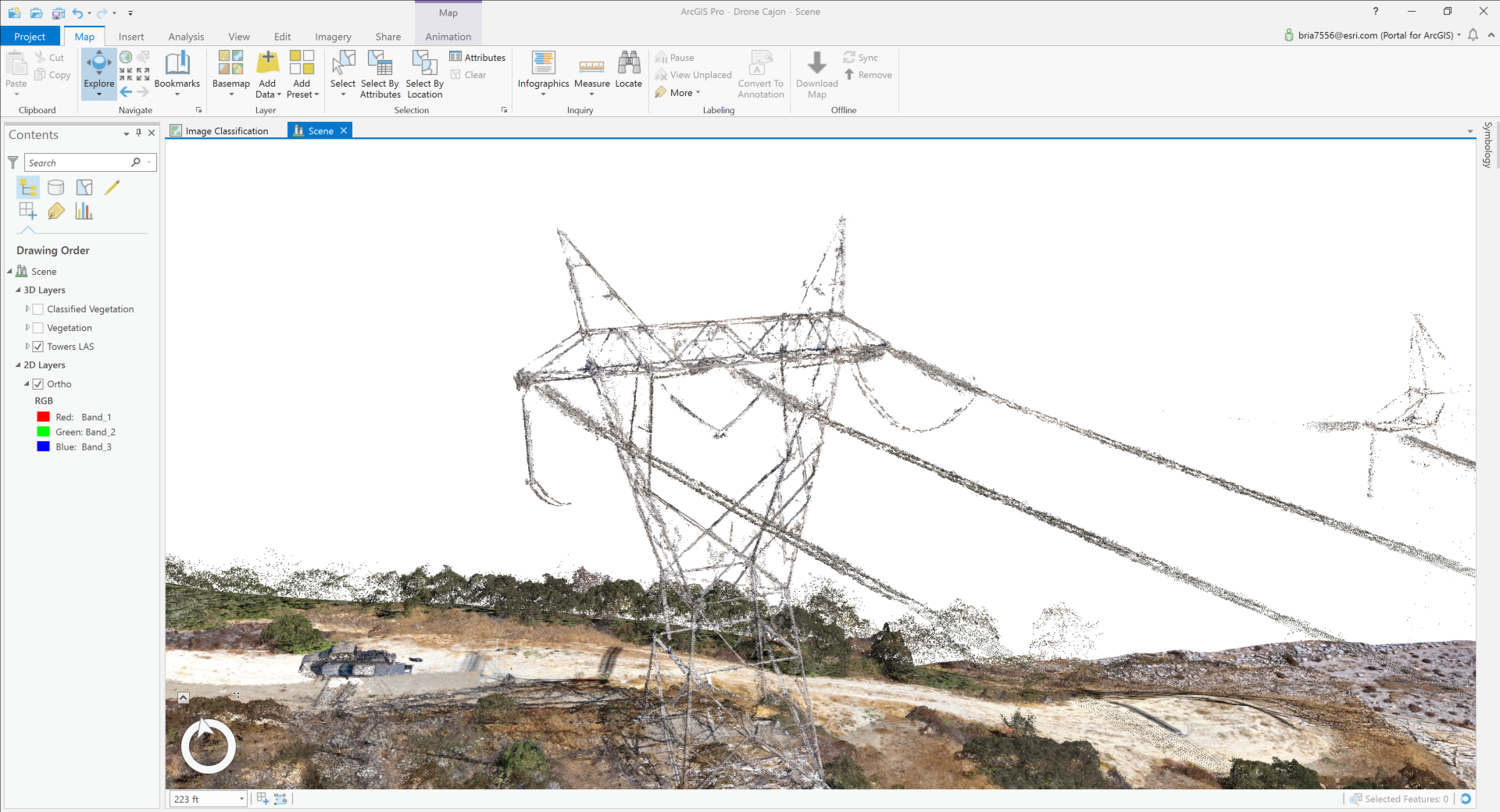

From the previous flight, Drone2Map built out an unclassified point cloud which we will use in ArcGIS Pro in a minute. But, we also wanted to conduct a 3rd flight that orbited just the towers, to see what kind of visualization we could build out for the structures.
Orbit flight path
Point cloud from the orbit flight in ArcGIS Pro
I also just want to make sure everyone is clear that this point cloud was not collected via a Lidar scan or with a Lidar sensor, this is built from the imagery that was flown.

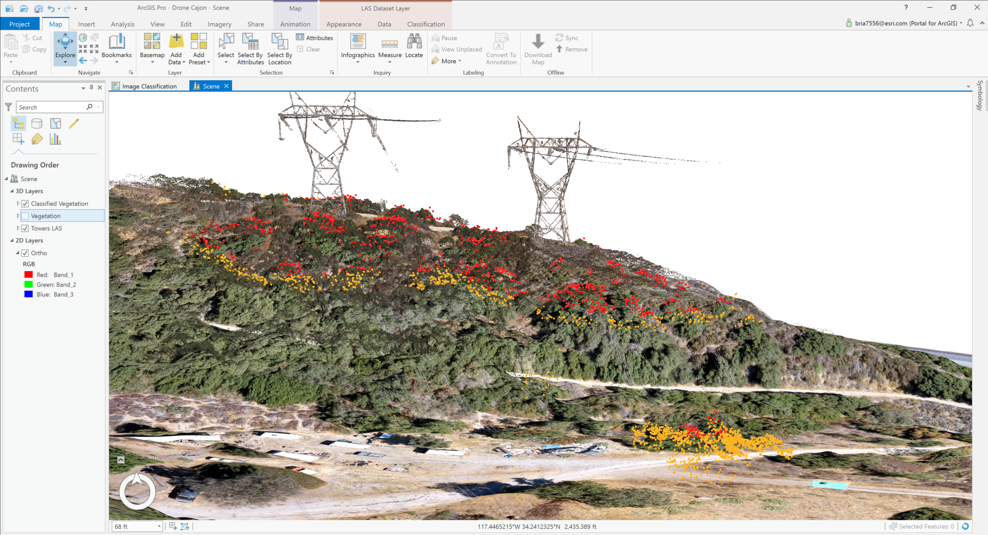

Lastly, we wanted to take some of the data that was built out using Drone2Map and use ArcGIS Pro to determine the impact that vegetation could have on the conductor.
By using the orthomosaic that Drone2Map built out, we can use the imagery tools in ArcGIS Pro to segment and classify the imagery. This segmented image can then be used to classify our point cloud. So, now we know where all of the vegetation is...
Then, we can use the 3D Analyst tools in ArcGIS Pro to see what actual vegetation is within a certain distance of our conductor.
