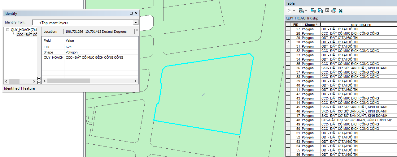

Hello everyone, I have a shp with includes the table with field QUY_HOACH, The table data included:
CCC- ĐẤT CÓ MỤC ĐÍCH CÔNG CỘNG
ODT- ĐẤT Ở TẠI ĐÔ THỊ

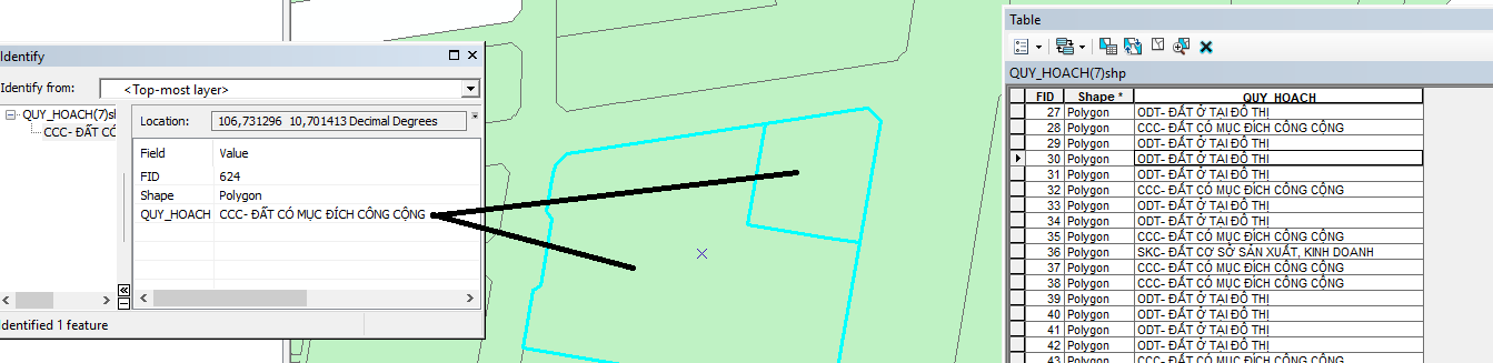

then I want to combine objects close together and the same attributes together
For example, if the data is ccc then all the data that is ccc close together will automatically merge together...
Initial results
And the result
Because there are so many polygons, I can't do it manually, hopefully everyone could help me which tool can automatically do this job.
