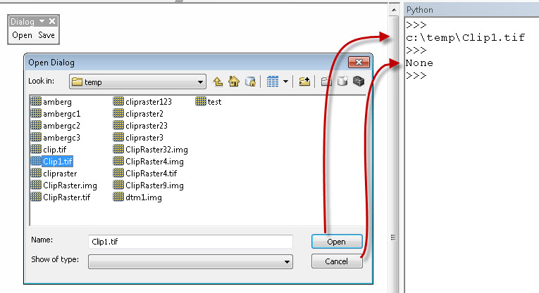

The OpenDialog and Save Dialog functions return two different values depending on how the user interacts with the dialog. When the user selects a dataset and clicks either
Open or
Save, it returns the full path of the dataset chosen. If the
Cancel button is clicked it returns 'None'.
Value being passed to a print statement when clicked.

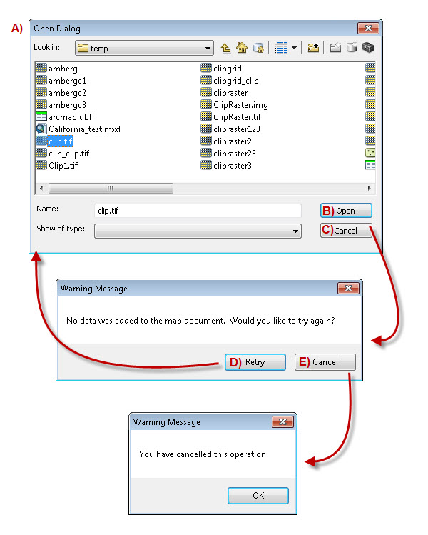

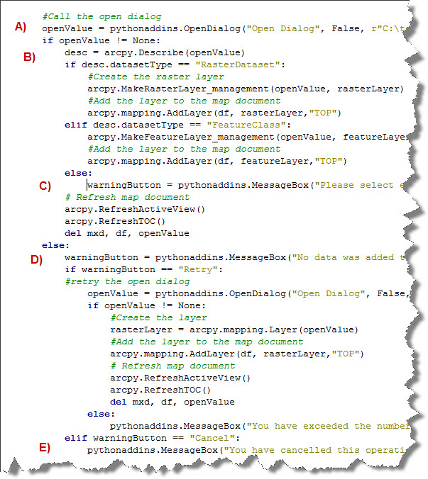

Below is a sample python add-in with comparison between the code and the dialogs:A) The
Open Dialog opens.
A file is chosen, and the
Open button is clicked. The file is added to the map.
C) The
Cancel button is clicked which opens the
Warning Message.
D) The
Retry button is clicked which reopens the
Open Dialog.
E) The
Cancel button is clicked which opens a final
Warning Message.
