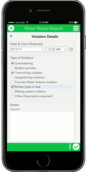

- In a household needs assessment survey, a multiple-choice question can be used to indicate if one or more of the following are needed: water, clothes, food, blankets.

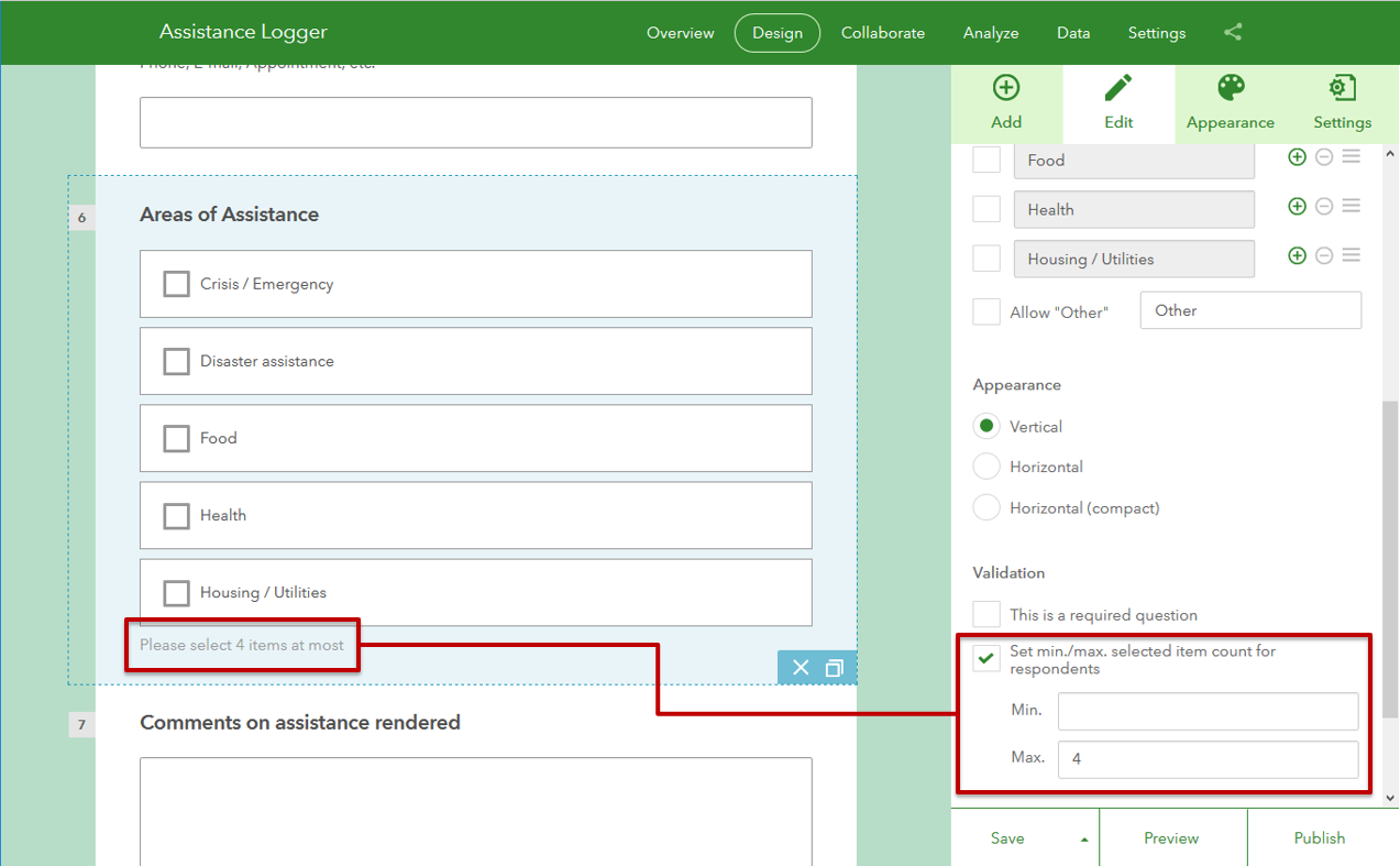

Configuring multiple choice questions from Web Designer is an absolute no-brainer: you can easily drag a Multiple Choice question into your draft view of the survey and start adding choices immediately. This video will show you how to get started:
Right from Web Designer, you can use the Validation section to control the minimum and maximum number of options that can be checked in the question by the end-user.

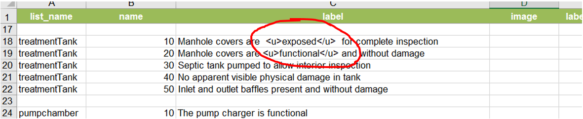

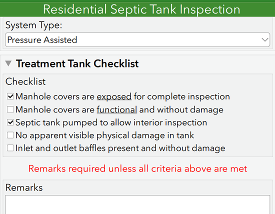

You can refine the look and feel of your choices using HTML formatting. This is not unique to select_multiple questions, as it also applies to select_one questions, but I thought I would add this as a reminder. In the Residential Septic Tank Inspection survey on the side, for example, I used HTML Label formatting to underline specific parts of the choices. HTML formatting can similarly be used to change the color of the text. You can find a complete reference of all the HTML tags you can use in this help topic.
Just for completeness, here is what the choice list in XLSForm would look like. Note that I inserted the <u></u> HTML tag in the label of some of the choices to underline certain words.
